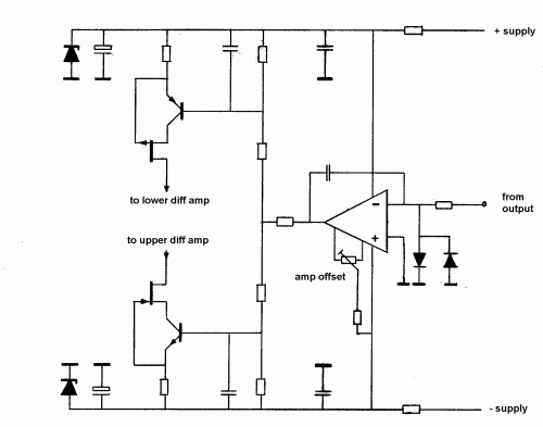

One thing I take note of and raise a question on is whether a DC servo is permitted in a no-feedback amplifier. It can make life a lot easier, but I suspect that the use of a DC servo disqualifies an amplifier from the strict interpretation as well.
Bob
Complementary symmetric topology amps sometimes have the servo control the input diff-pair +/- current sources instead of summing into the diff input. I use this servo in my global negative feedback amps because I believe it gives a more dynamic sound by not summing the opamp error signal with the output feedback.
I have seen a few no_global_feedback amps use this type of servo.
I am only striving for clarity, not picky interpretations. A
DC servo is OK by me. I also don't regard cascoding as a
gain stage or differential pairs as two gain stages.

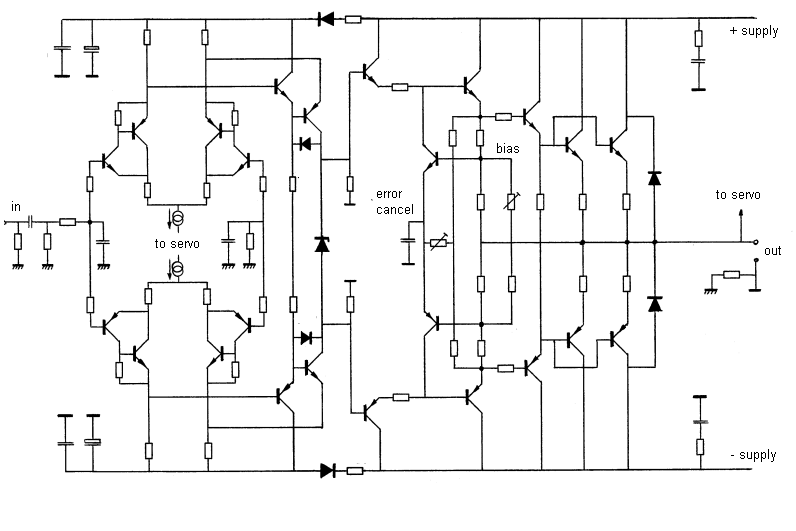

But I guess Bob Cordell's h-error-correction outputstage
uses a bit of positive feedback to achieve result.

another reason for being clear on what is negative feedback and when there is built in negative feedback is that positive feedback lets you get at the gain of a device or circuit block with internal negative feedback - like triodes
in the HEC example I believe it is useful to think of the positive feedback "unmasking" the gain of the driver bjt despite their running as emitter follower with local unity gain negative feedback
Error Correction circuit uses positive, negative or null feedback according to what is demanded by the remaining part of circuit to make the whole having a linear response.
EC works by bringing a circuit into balance, so adds to signal input (positive feedback), substracts from it (negative feedback) or does nothing at all (no feedback) to achieve this aim.
"Feedback on demand", has it not been described as this ?
HEC simply isn't that "smart" - the elaborate descriptions are due to attribution of human style heuristics to a circuit that simply uses nested positive and negative feedback in a uncommon way
Bob's Mosfet Amp HEC can be usefully analyzed as having high gain local feedback around the output stage - at audio frequencies the local loop's gain is very high and can change sign over some frequencies depending on component tolerances and circuit operating point - but not in a coordinated fashion with any "knowledge" of what’s "best" for signal/load at any time

BTW, I'm also assuming that a CFP stage would disqualify an amplifier from the more strict definition of no-feedback, as it is a case of very strong local feedback.
The CFP could be tempting for some to use in a no-feedback amplifier input stage, as that stage must handle the full line level signal in a no-feedback amplifier, and a straight LTP may thus be prone to creating distortion without VERY heavy degeneration.
One alternative approach is to use a cascomp input stage. I note that one can also apply the cascomp concept to JFET input stages.
One can also use a cascomp in the VAS.
Bob

The cascomp was invented by Pat Quinn at Tektronix to provide for wideband vertical oscilloscope amplifiers with low distortion without the use of NFB.
The idea is elegant and simple. Envision a BJT loaded by a cascode. Recognize that the LTP distortion arizes from the nonlinear voltage across the LTP BJT intrinsic resistance re' that varies current. Further recognize that a replica of the same nonlinear re' voltage exists emitter-to-emitter of the cascodes. We can harvest that error signal. Take another identically-degenerated LTP and feed it from the emitters of the cascodes. Take the outputs of the added error-harvesting cascode and connect them in opposite polarity to the collectors of the cascodes to cancel the error current from the original main LTP. This is thus a form of feedforward error correction. Put another cascode on top, if desired, so that the collectors of the error LTP are also cascoded.
Although I have not seen it done by others, I have applied the cascomp technique to JFET input stages. Although the operating characteristics of JFETs are different than BJTs, the same error cancelling principles apply. The main LTP, the cascodes, and the error LTP are all mase up of JFETS, three matched pairs. Matching among the pairs is desirable, but not critical, and like pairs are easily found in the same batch of devices. Distortion is reduced by a factor of 5 or more. I show a set of curves of performance of the JFET cascomp in a chapter of my book.
Bob
