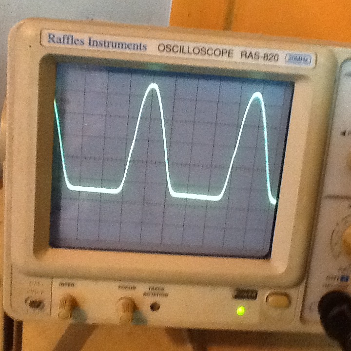

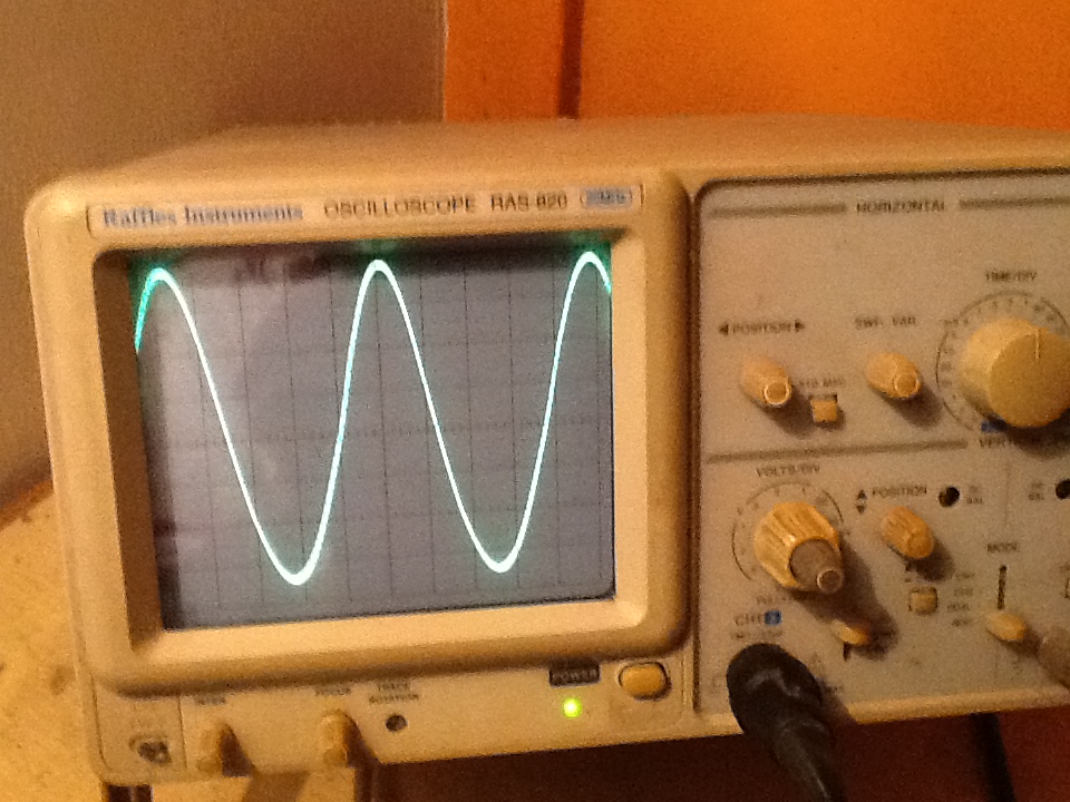

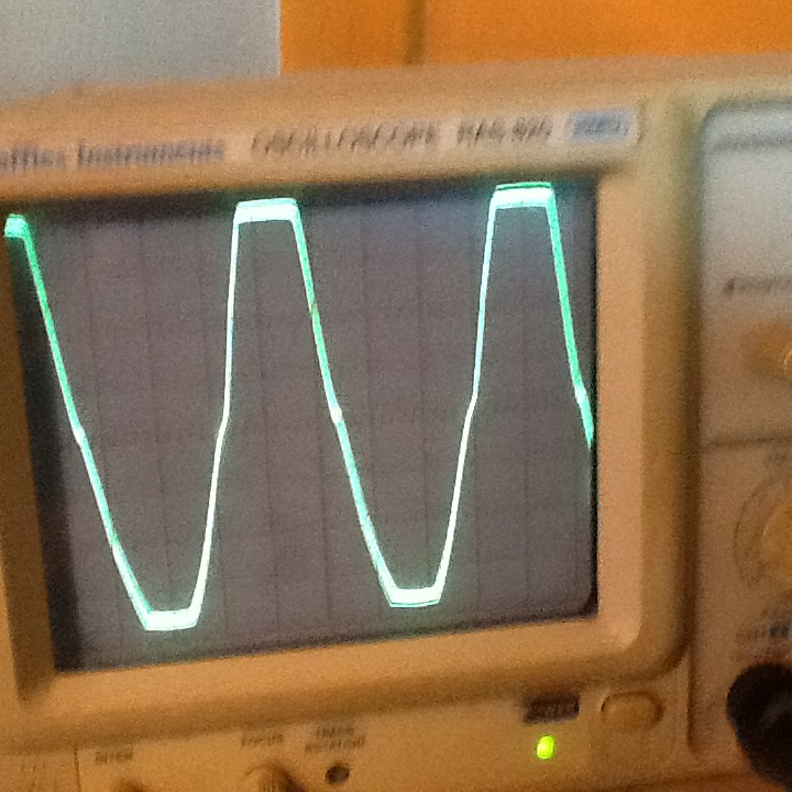

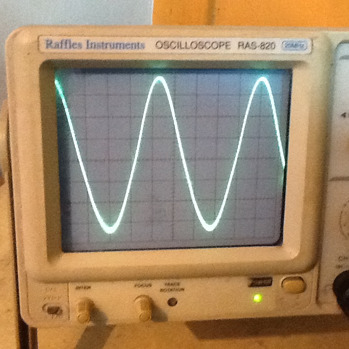

Here is the snapshots of clipping distortion.
Disabled Account
Joined 2013

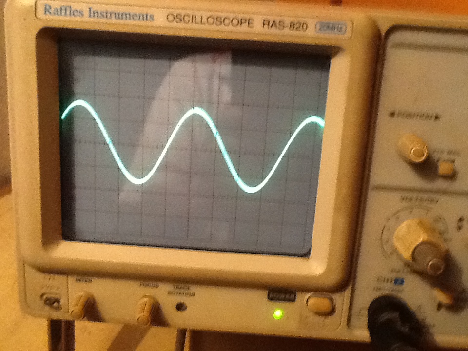

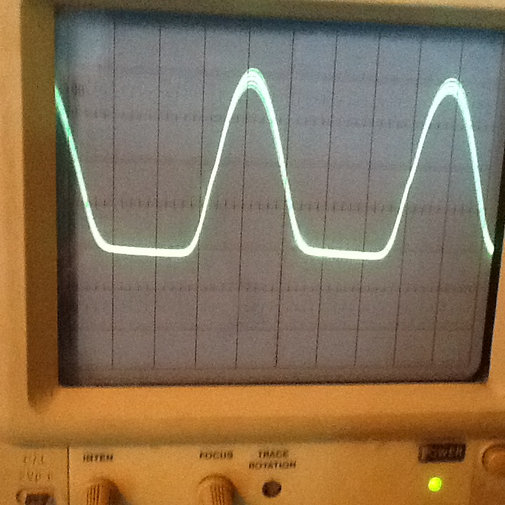

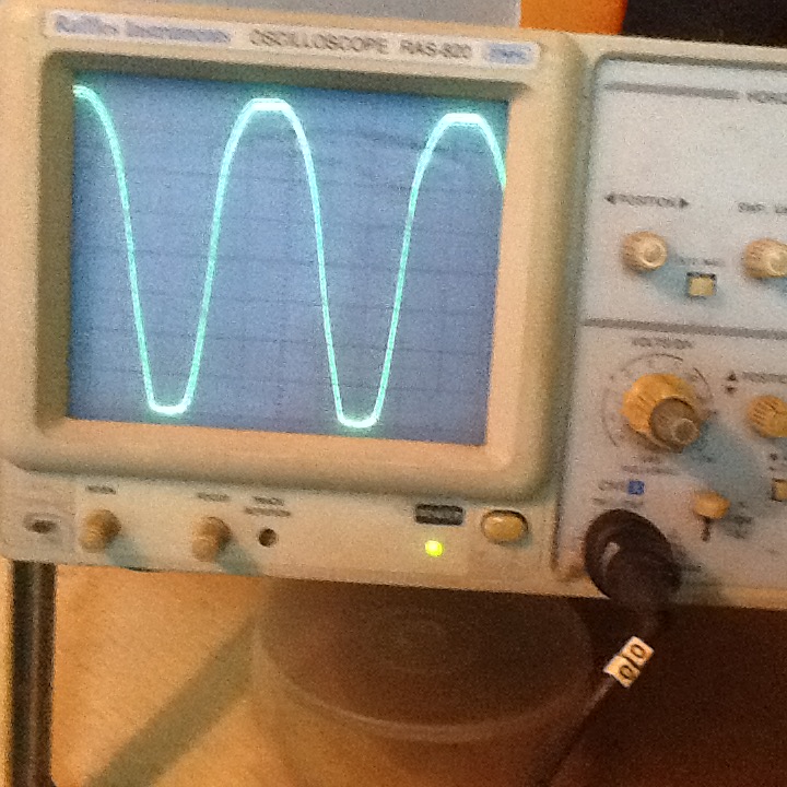

This current waveform of top and bottom tube 20*10 mV scale. Output level is just under clipping when the current waveform is taken. This is 10 tubes model 5 tubes each bank, current waveform is taken using floating scope across 1 ohm resistor in the cathode of one of tubes.
As you can see from 2nd snapshot in the last post, when driven further into clipping, crossover point shifted up further, meaning top is conducting lesser during this time due to loss of gain, as well as DC offset jumped to 1.2V at this point while normally just < 0.1-0.2V.

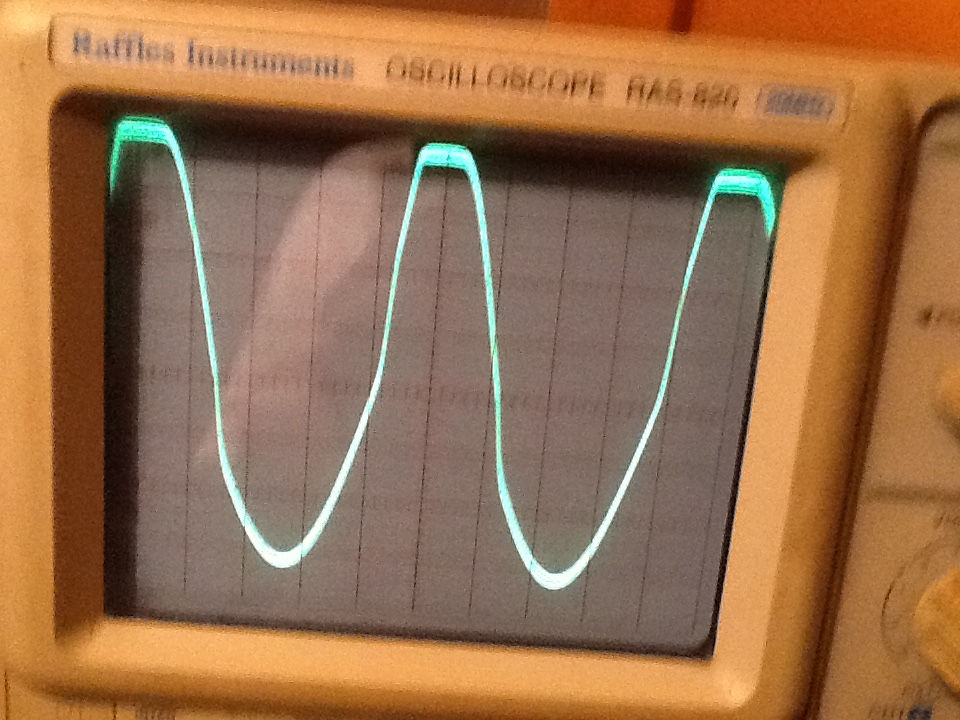

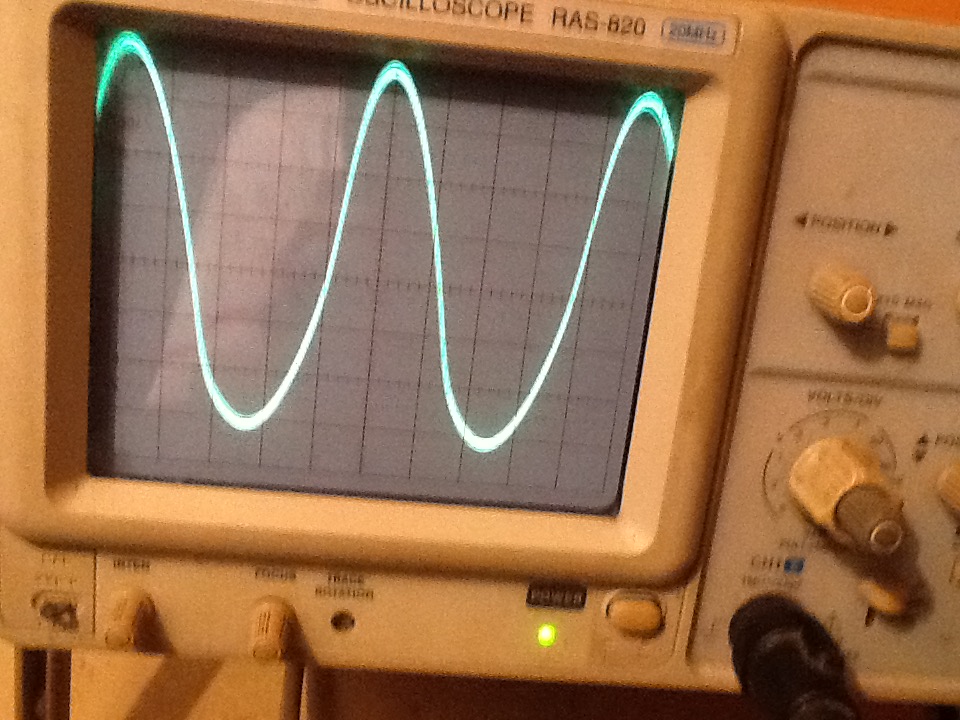

" I'm assuming the operation at V2/bottom is class A, so there is no switching on/off of the PF."
I like to make clearer answer to this:
1) yes V2 is a Class A type.
2) V2 also drives the bottom tube
3) V2 also where PF is (solely) derived so it it important V2 output not be trimmed due addition load branching. So must have sufficient gain to minimize the loss. We experienced some difficulty in very low mu tube such as 5687, and so plate resistor in V2 needs adjusted to compensate for the loss. The value in original schematic works very well including 5687 (Have to adjust the PF resistor R16 and R26 to suit my latest is R26=500, R16=100K), the others remain unchanged.
4) It is debated as why PF should be derided from V2. Ideally NFB should be able to have full control under optimal condition, these conditions can be met easier with a bit higher gain tube, with low gain is it is a bit of challenge especially boosting to same higher level. It is important the condition be met before drawn conclusion. Since the bottom tube is a voltage follower and upper tube is cathode follower to begin with, V2 drive would be quite different from V2 top in turn of wave form shape since there are not the same output type so they have different gain at low output to nearly some gain at higher output. Still remember V2 bottom is sole point where PF is derived for top and bottom. If we maintain V2 bottom level as is (it signal level under NFB control through out), it appeared to me this PF so derived appeared to be have very good result.
5) You can see why in snapshot attached. The top part of wave form drives bottom tube and bottom part wave form (actually an inverted in V1 splitter for top tube drive, as the bottom part does not actually drive top tube, it is mirror of the actual arm drive the top tube). drives top output tube This is the kind of proportion we looking for.

Thanks for all the photo measurements. Much clearer now how it is operating. The output currents indicate class aB operation of the output tubes. The NFB is swinging the drive signals asymmetrically to drive the cathode follower up top versus the grounded cathode stage on the bottom. The full NFB loop is performing the "voltage follower" function for the bottom output tube. Usually I think of a voltage follower as being a more local feedback loop.
In addition, I think what you have been saying (and I wasn't getting) then is that the PF assists "more" when the bottom output tube needs more drive signal (since the bottom V2 plate swings more then), so the PF is doing some of the output symmetry correction directly. It is an interesting approach. One might expect the adjustment of the PF gain to find an optimum level where it just exactly corrects the lower tube gain. Somewhat similar to the Error Correction (EC) technique used in SS amplifiers for fixing crossover, except here it is functioning with a large assymetry to fix.

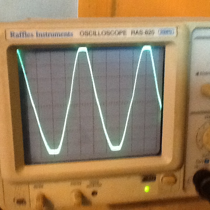

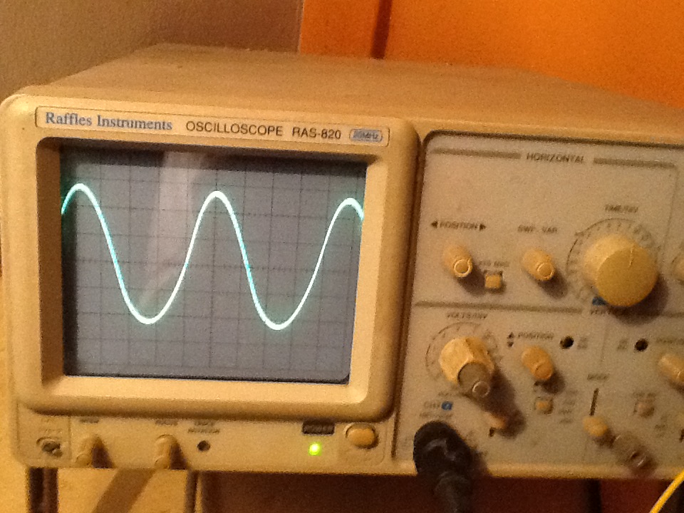

Here are snapshots of PF various amount of overdrive. Look like the bottom tube drive is losing some steam during medium to high level overdrive, appears quite normal up 30% PF overdrive. There are quite a bit of "positive" phase shift also at higher level.
