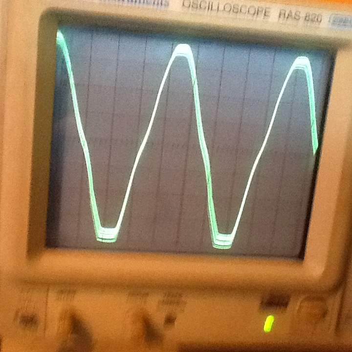

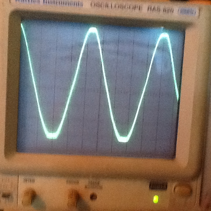

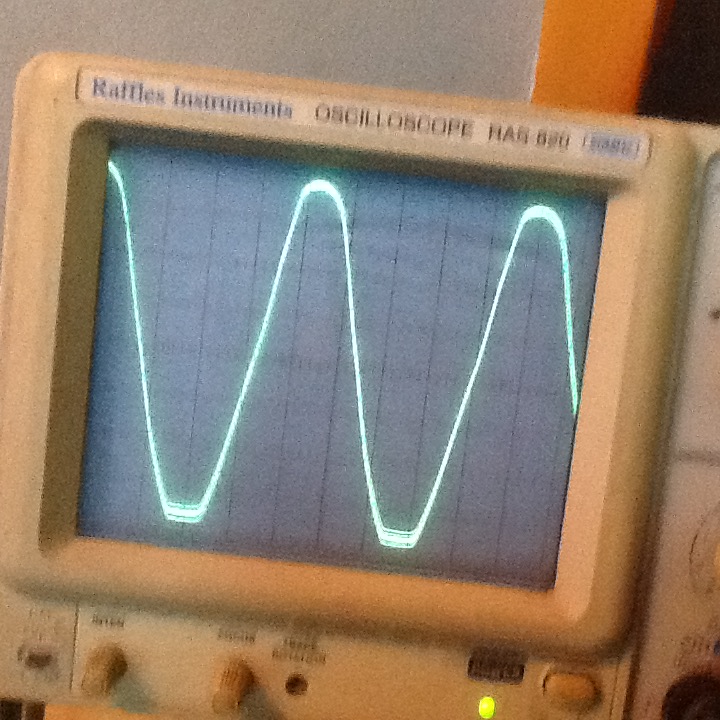

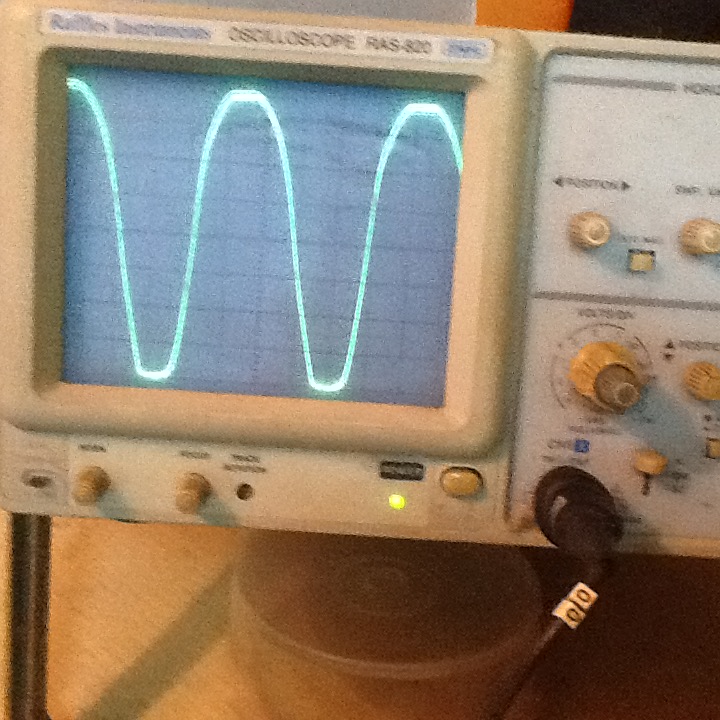

Here are some snapshots (sorry about the quality as it quite dark now). The output is about 40V-P-P(25W RMS) load is 8 Ohms (60W Dummy Load). The top and bottom tube is on 8*20 160V scale. As seen from snapshot the top tube drive level is about 110V P-P and bottom tube drive 160V P-P. This is after the last modification mentioned in this thread, V26 is 1K, R17 is 33K/2 2Watts and R18 (twice R17) is 33K/2Watts. These measurement are contradicting to conventional OTL amp, any thought? Maybe the bottom tube is conducting more than the top tube, etc..? I am still excited.

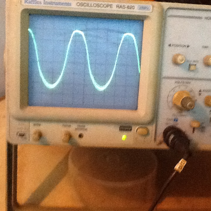

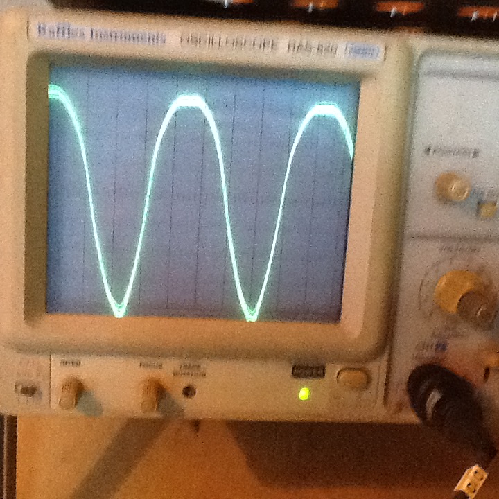

So I did another change: I revert back R18 to 33K/2 (16.5) so now is value as R17. I parallel a 1M resistor across the PF resistor R16 of 220K makes it about 180K, thereby increase PF drive to V1. The driver output (8*20V scale) is more less same level now. DCR is 0.05V at no output, raise to 1.2V at clipping as shown, drop to 0.6V just below clipping, this is an improvement over previous change.
Attached is snapshots.

.... PF will increase gain only when there is input signal and attained certain maximum gain in V1 only, say 45. Therefore the maximum gain is 45* 10 =~450, initial gain is 70.
What do you think?
Based on the last experiment, at full output 25W clipping 8 ohms load, V1 is about 270 and V2 gain about 11 so 270*11 = ~3000 actual maximum gain
This is measured data: V1 in 50mV P-P, V1 out = 14V P-P, and V2 out 160V P-P
Why do you consider the PF to only begin when there is signal on V2? (agree there is no actual PF effect if the signal is zero, but the same could be said for the NF too) Are the V2 tube driver sections running in class aB or B?
I see now that the operation is significantly different from what I had originally envisioned. I was assuming that the top and bottom tube drive signals where being conditioned for symmetrical outputs via feedbacks, but obviously they are running quite asymmetric.
I suspect that the top output tube is running the show voltage-wise, and the bottom output tube is acting as a variable complementary current pull-down. No attempt being made to equalize the outputs (other than after the fact with neg. Fdbk). So likely they are running in class A most of the time, or at least during the crossover region. This would account for low crossover distortion. But would make for a lot of heat.
It would be instructive to leave the load connected, but replace the bottom tube with a resistor capable of supporting the idle current at crossover (zero volts output with no signal). Then take a scope trace.
Similarly, remove the top tube and replace it with a resistor capable of supporting zero signal idle current, with the bottom tube back in place. Then take a scope trace. This all being to determine what contribution each output tube is making to the output, and the class of operation or range of that.
If the output stage is running in class A all the time, it must be getting fairly hot for an OTL amp. Usually the high current requirements of OTL demand a near class B output stage with plenty of feedback to fix the crossover. The other issue would then be the output Z, with just the top follower setting that impedance level, along with the N feedback. OTL amps like the Circlotron try to use both output tubes in follower mode to reduce the output Z maximally, along with the N feedback.
If you have a current probe, or a differential probe, then the currents through R34 and R35 could be viewed on the scope, instead of the R substitution idea. A simpler measurement. Or maybe put some low Ohm resistors in place of, or series with, the F1 and F2 fuses for scope measurement.

"I suspect that the top output tube is running the show voltage-wise, and the bottom output tube is acting as a variable complementary current pull-down. No attempt being made to equalize the outputs (other than after the fact with neg. Fdbk). So likely they are running in class A most of the time, or at least during the crossover region. This would account for low crossover distortion. But would make for a lot of heat. "
Very low bias only 40mA per tube, 4 tubes each bank. So not Class A, Class AB maybe. In the first experiment it was lower tube that do most of work as overlap with top tube, as I can almost detect the crossover point in my scope somehow, may be you can see it when closely examine the photos - the bottom tube clearly start to conduct very early as indicated by crossover point . The other evidence is the positive DC offset indication the top tube is conducting less than lower tube in both experiment, else DC offset will be negative. The last experiment has less DC offset showing that both banks are working correctly, just fine tuning, and that is why I think plug in VR4 come in handy ( I do understand the implication it has on circuit you imply in earlier comment). True, cross over distortion should be low and remains low when fully balanced as the amp is able to conduct to overlap earlier so no gap will occur
Only normal heat sir.
I would pause here until your response soon.
I'm not sure what point you are making about the positive feedback, it appears to match the typical positive feedback arrangements for increasing open loop gain within a NF loop. The order of the summation of the NF and PF at the input does not matter, X+Y = Y+X. I'm assuming the operation at V2/bottom is class A, so there is no switching on/off of the PF.
The output is then running class AB, with a voltage source up top and a current source on the bottom, although without some current measurements it is not clear how much of the range is in class A versus class B.
What are you claiming as advantages for this design? I just see the PF as enabling lower Mu triodes up front. The Class A region at the output helping to reduce the crossover distortion, but at some efficiency cost.
One issue I see that raises a question mark in my mind, is that the PF and NF are coming off almost the same point (and returning to the same input point), just a follower stage between them. So it would seem that the NF is just reducing the PF back down to the tube MU products again (for the NET NF). Usually one finds an additional gain stage after the PF loop to enable the NF to reduce the distortion of that output device. So it would seem the NET Neg. feedback is mainly operating on the lower grounded cathode output tube when it is conducting.
Well, that was not a very clear description on my part. I guess one would say the PF loop assists the NF loop gain for the bottom tube mainly (when the top follower is cut off).

"In fact although nearly same level it is shape is inverted is quite different, as you see from output waveform of V2 top and bottom I attached earlier. "
This is quite mystifying, since both top and bottom V2 get complementary drive signals from the splitter. Could one output tube be entering a positive grid region drawing grid current?
Disabled Account
Joined 2013
Soory I see, I see what you mean. Of course it must be 180 deg phase angle apart - that is what I really want to say not both conducting at same time.

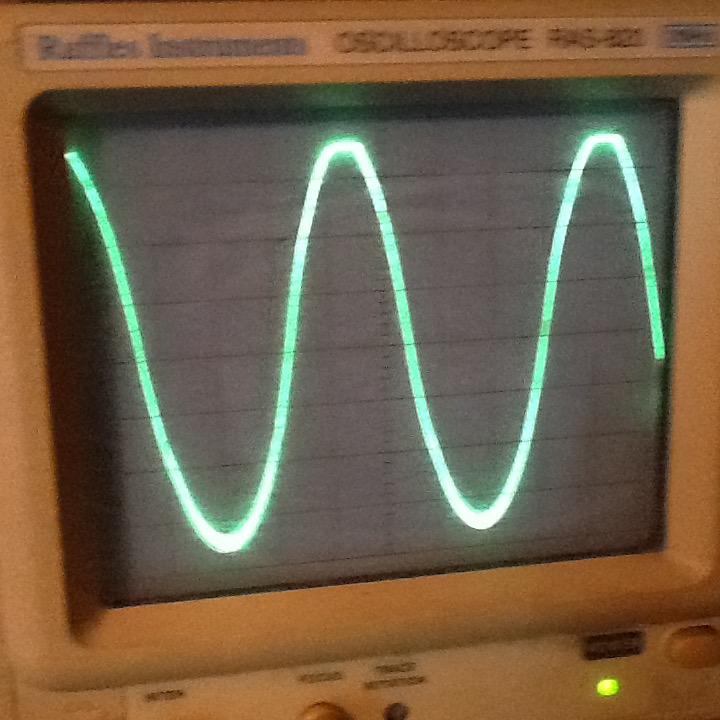

In order confirm the crossover distortion I need to remove the PF link and with only NFB in circuit, everything else unchanged. The maximum gain V1*V2 has dropped to just 77=7*10, if output stage is included, the actual gain is about 20 = 40/2 (again 77*0.25 =~20). It takes 2V P-P to drive to full power. The top and bottom drive waveforms are quite similar to one attached earlier. The purpose is to locate the crossover point which is clearly seen due to lack of NFB, damp factor is much poorer, sonic wise it s inferior.
Still it crossover at right place doesn't it?
