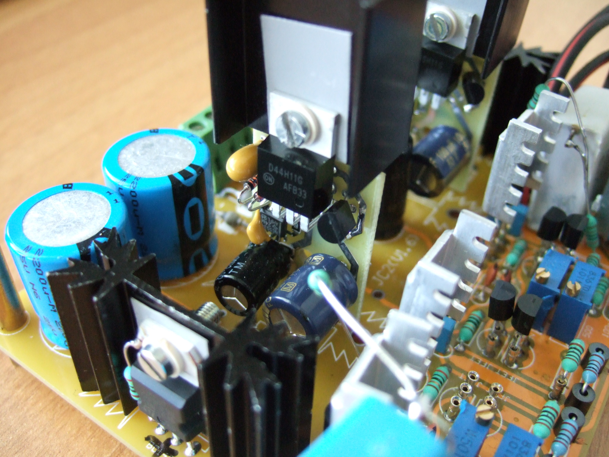

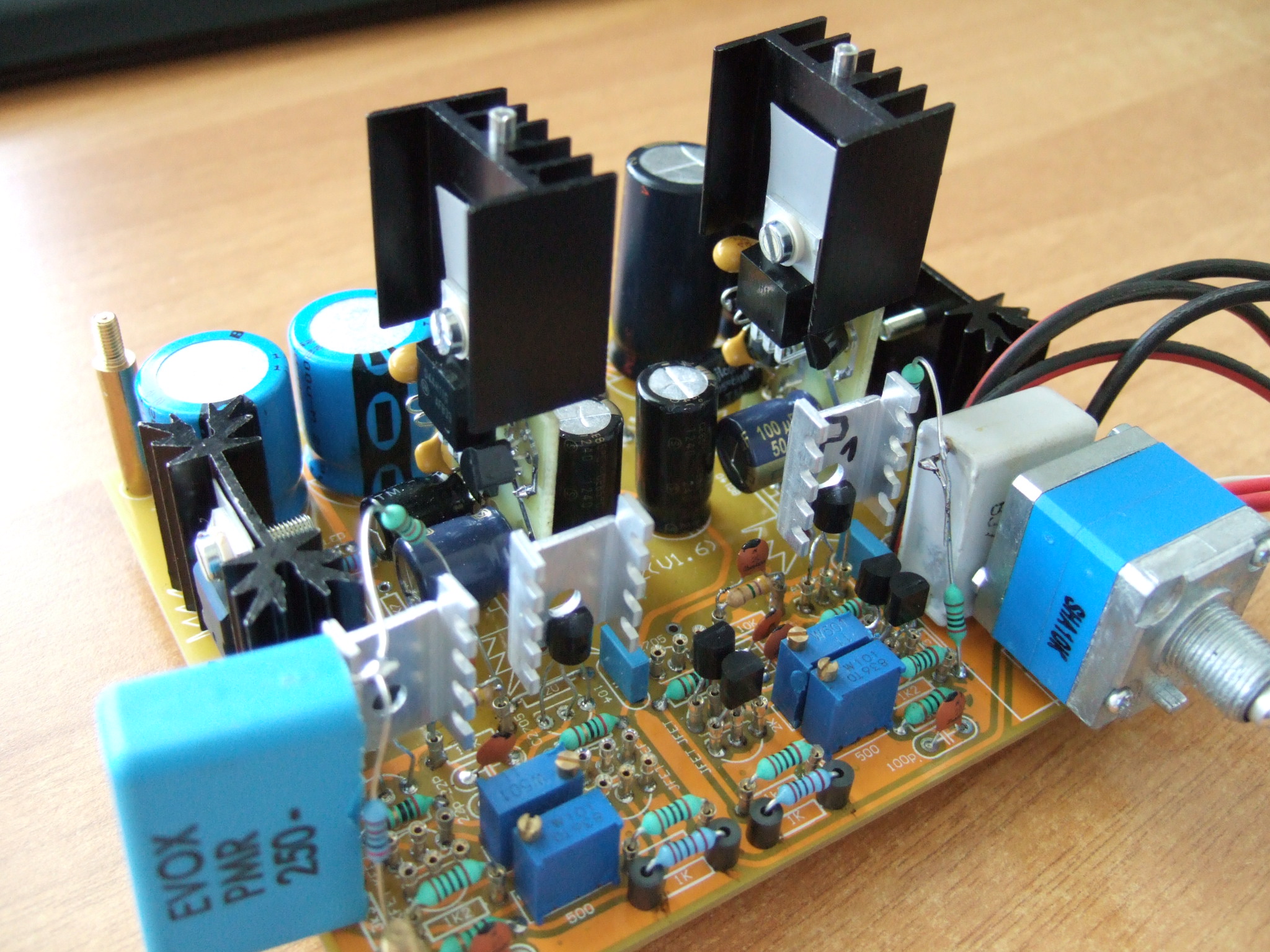

I like your build which allows various Fets to be tested. There aren´t many p-channel
options left unfortunately. How about 2n5461 (Fairchild) ?

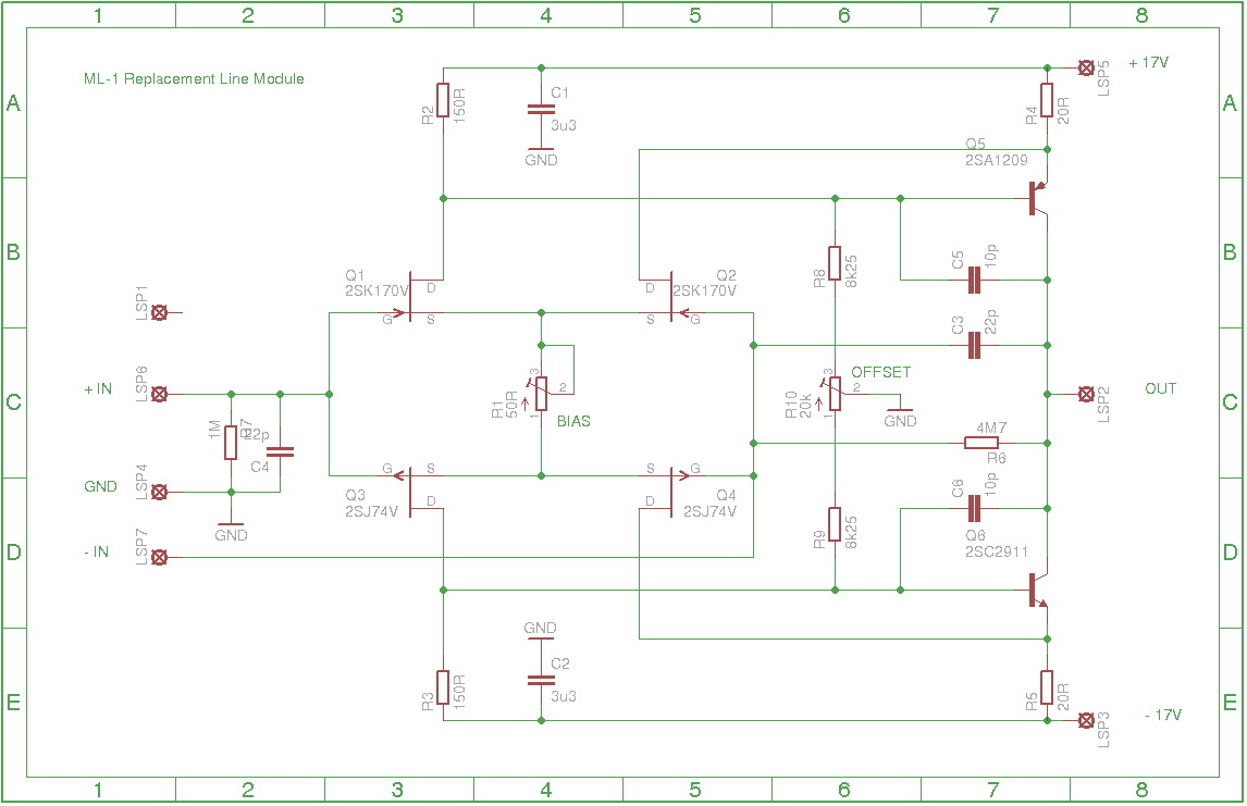

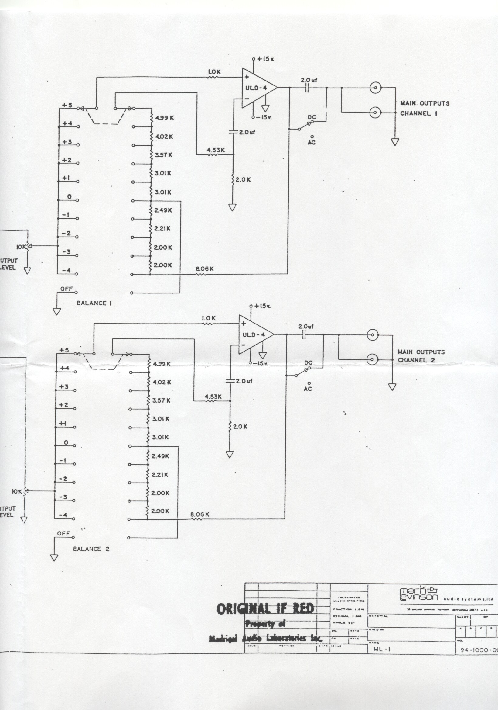

gk7, I have a question for you, if you don't mind..
This line stage schematic you've posted some time ago - transistor types aside, does it represent what was in original module or are there any additions/omissins by you?
Particulary, I'd like to know whether C1; C2; C3; C4 and R6; R7; R8; R9 were inside it.
I have a ML schematic that also shows ULD-4 module and I'd like to understand how all internal and external parts interract.
Thanks!
Thanks!
My schematic (and what I built and use, as described here in this thread) is based on
the schematic of John published. What is inside the modules I don´t know they are
potted with epoxy:
http://www.hal9000.at/audio/JC-2/ml1-project/l1000114_jpg.jpeg
R8, R9, R10 are not present in Johns schematic, but my original modules obviously have
a second pot for offset adjustment so I "borrowed" this from the ML-2 power amplifier
which uses the same topology as input stage. It works well.
R6 is only needed if you use that 2u cap in the feedback loop:
http://www.diyaudio.com/forums/atta...3101224-need-build-jc-2-preamp-ml-1_main2.jpg
it´s the feedback path for DC and certainly must be present in the original modules.
C1; C2; C3; C4 are in the original schematic.
Please post it, I´m curious to see it.
