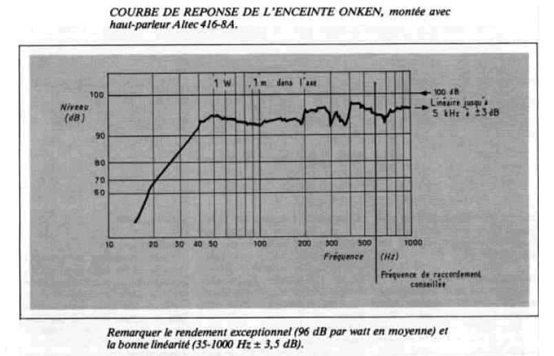

It's just a big vent reflex [BVR], which is clearly shown in Hiraga's[?] own measurement and why I recommend just using one or two large pipe vents unless one wants to build one more for its 'looks' than its performance. Better yet is to make a large vent MLTL, which performs much more like Hiraga[?] imagined it.
