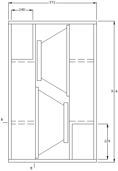

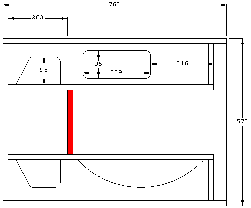

This is the way I build my manifold boxes, not that much wasted space.
With a pair of 15s it's only about 1 cu ft, the net interior volume is on the order of 8 cu ft, port is tuned to 31hz (low B on a five-string bass).

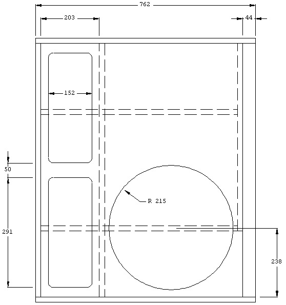

pretty cool. do you have the cab dimensions?
Mine were 36W x 24H x 30D (external with 3/4" plywood).
I use dual 15s with suitable parameters, but there are some 18s that have suitable parameters for this sized box as well.
Looking for an Fs=31hz, Qts=.312, and a Vas around 10 cu ft for this design, otherwise you will have to change the dimensions.
It should be clear from the thumbnail sketch that this is a vented design and not isobaric.

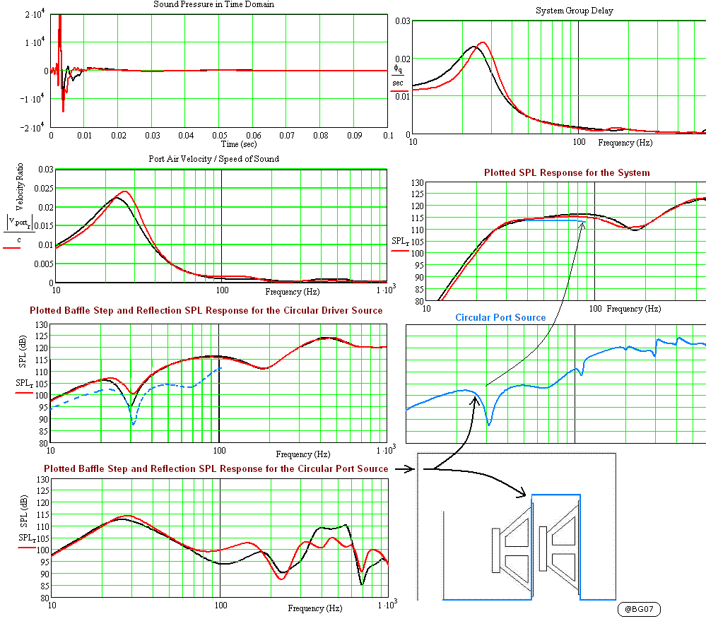

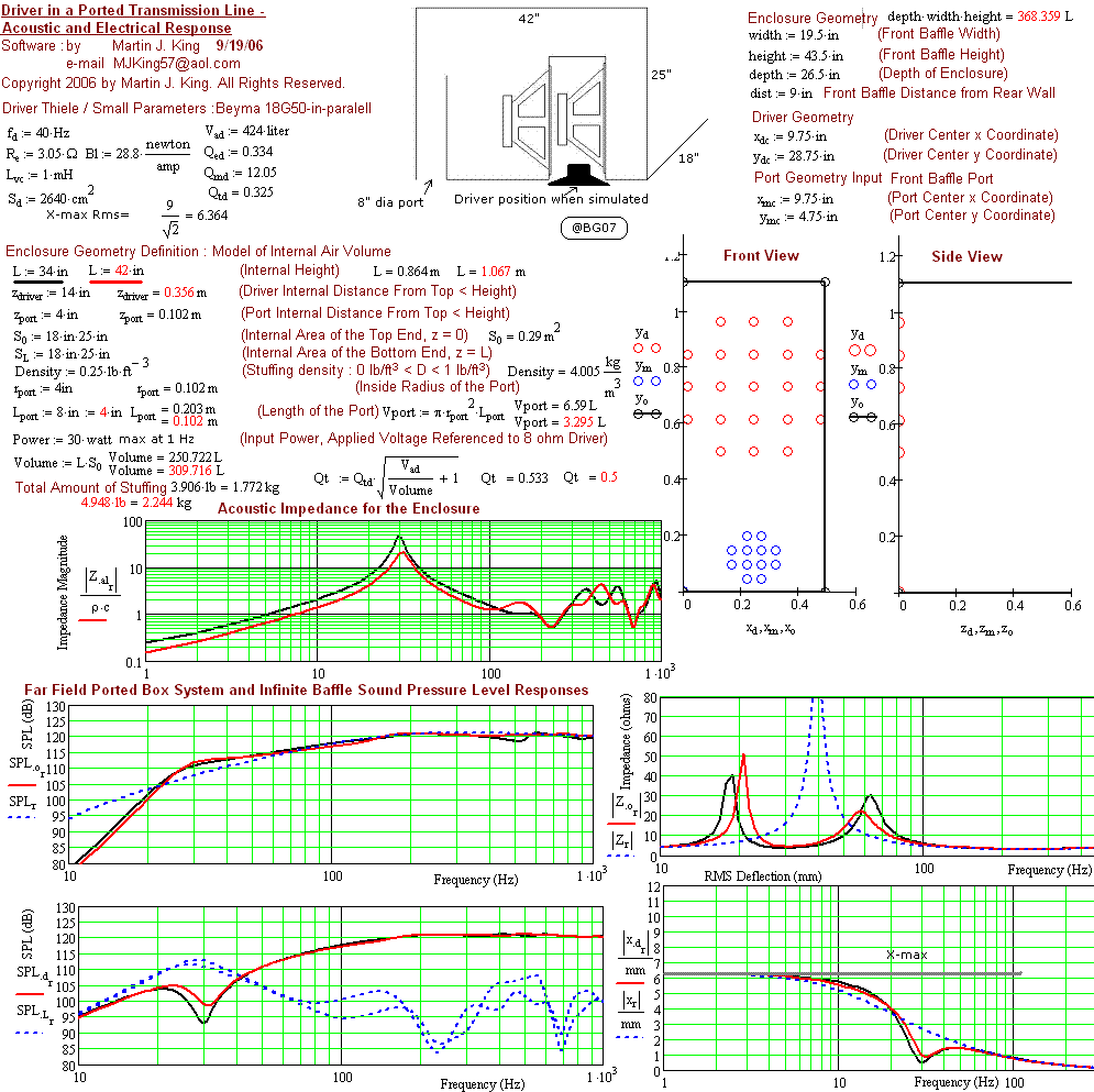

If you keep the plenum size as small as possible you can ignore the bandpass action of the plenum and just simulate it as an ordinary vented box.

I use woofers that are suitable for a 6th order vented design, so they are more efficient than a regular 4th order vented system (see post #6). Each box is about 7% efficient, about 101dB/W and 8 ohms, so a stacked pair are 107dB/2.83V/1M, and three are 110dB/2.83V/1M and about a 2.94 ohm (minimum) load. Two per side are adequate for most jobs. One user has twelve cabinets, but I have never heard him use more than eight (four per side).
