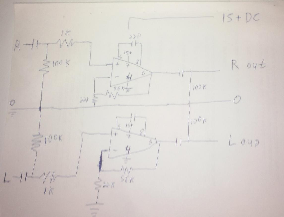

ok i will use 1N4744A which is zener diode 15V 1W
Perfect.
the pre amp works perfect and sound grate
i put it in marantz 2226

You can't easily modify this to give a boost to just the lower frequencies, it needs a major reworking. Something like this kind of thing maybe,
Stereo Preamplifier with Bass-boost - circuit diagrams, schematics, electronic projects
You can't just "modify" it to do what you want. It's a either a total redesign or an add on circuit to go before or after the preamp. To boost just the bass and leave the mid and treble alone needs an active circuit using opamp. You can't do it by just adding a couple of parts to the existing design.
Here's another one,
Bass Booster
they are all based on the same principles.
Here's another one,
Bass Booster
