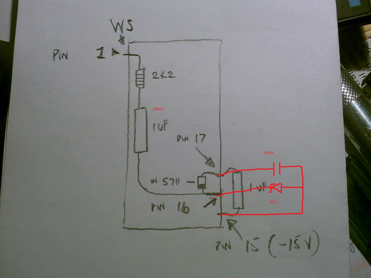

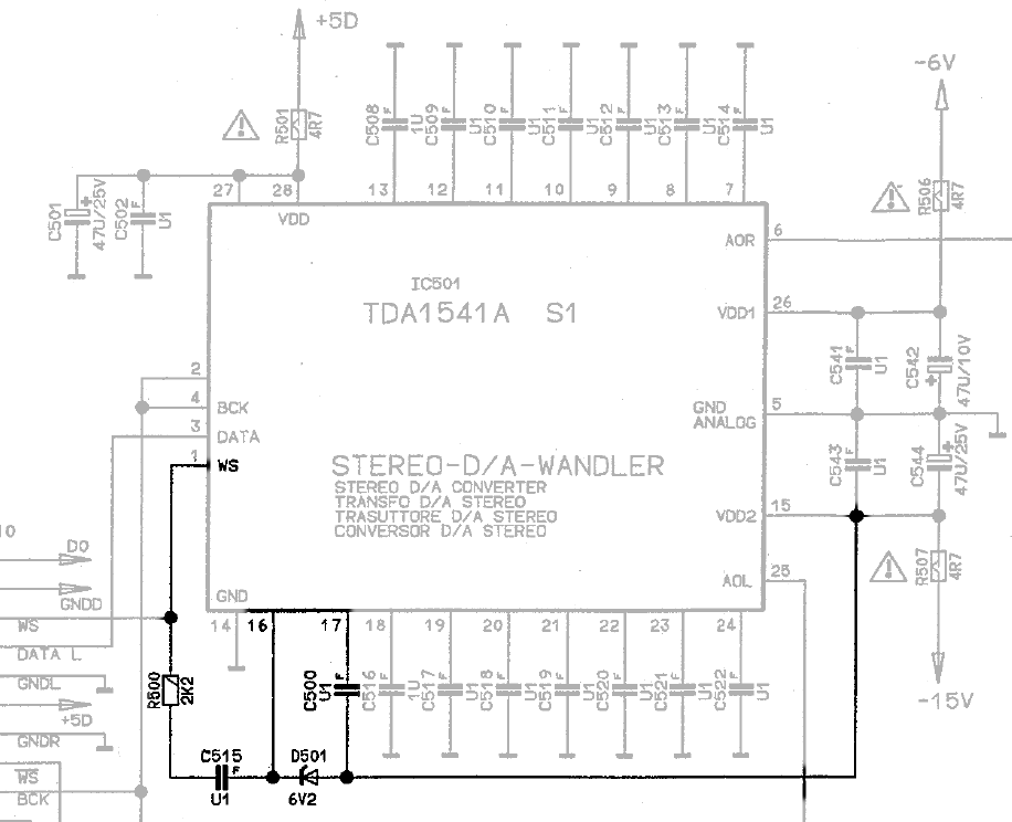

I was about to do the Grundig method of DEM using ws to pins 16 and 17 via resistor ,caps and diode.

The Grundig circuit needs no ICs so is simpler to implement and so worth trying.
Whether using a lower frequency derived from dividing bck is audibly better is down to either trying it, or taking someone else's word for it (as with any mods)

Just applied the Grundig - it works well - just as the drawing that I posted that no one endorsed or commented on.
No matter - just do it straight off WS - very nice step.
Glad I did
Andrew
Andrew, the way you drew the schematic is wrong as you are not connecting the zenner to -15V, so if you built it the way you drew it, you are not properly saturating the oscillator circuit. See attached ammendment to your drawing.
Glad I did
Andrew

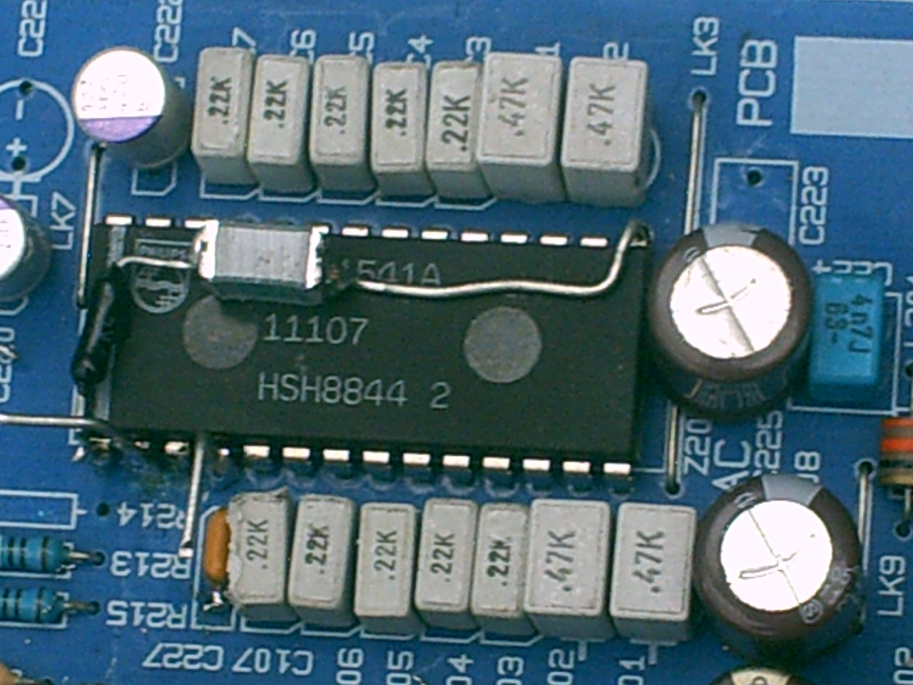

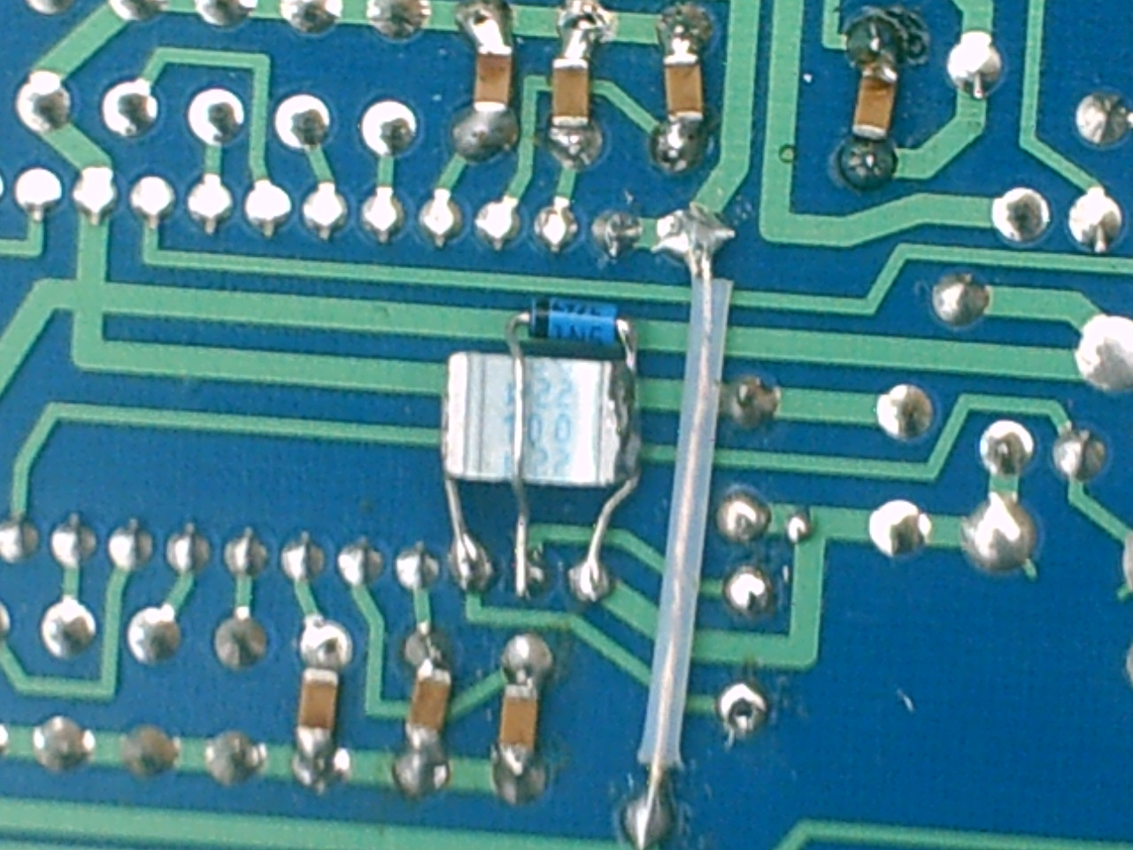

Thanks for the heads up on my other attempt - which astonishingly worked very well
New pics attached and your drawing for anyone wanting to have a go.
Sounds very nice - too early really - just fired her up half an hour ago.

Hi Andrew, yes you designed your own circuit - and it worked. Kudos to you
I think I came across a bit blunt in my other post so sorry about that. Was just trying to help. Glad its all sorted out now. Thanks for testing the Grundig circuit for everyone and letting us know about it.
