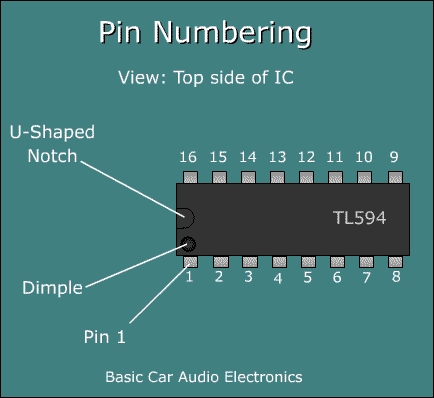

Clamp the transistors to the heatsink and insert a 10 amp fuse in the B+ line feeding the amp. Power up the amp (incl. remote) and post the DC voltage on all 16 pins of the TL594. Place the black meter probe on the amplifier's ground terminal. Place the red meter probe on the point where you need to measure the voltage.The attached image shows the numbering scheme. Copy and paste the following list into your reply.

First, thanks for the help Perry. I connected it up to my power supply and tried to get readings. I couldn't get anything but I did find that once I powered up the amp, the power supply quit supplying power (zero volts). I disconnected the amp and the supply went back to 13.68v. The 10amp fuse is also intact. I rechecked the supply afterward, to be sure it was working, and it is fine. I thought I had killed my 20 amp power supply. Sorry but I can't get any readings on the IC. Though, the fact that the power supply went to zero, I hope, will tell you something.
