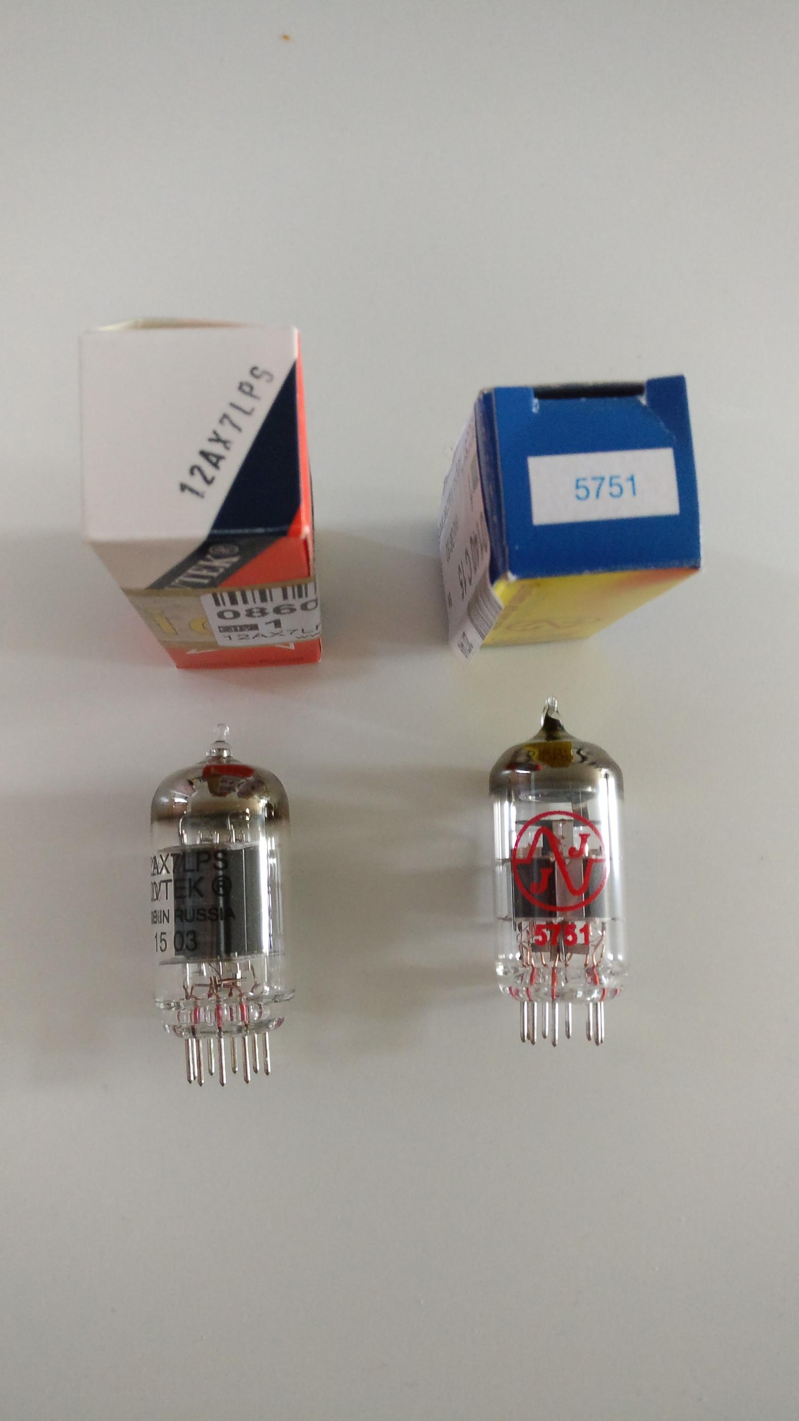

I'm still waiting on the rest of my tubes to arrive, I did make a change in the order though, I changed the 12at7 tung-sol tube to a jj 5751 tube, now when we were told that the mid socket is not a phase inverter but a gain socket (12at7 is better suited as a phase inverter and not gain, a low gain equivalent to 12ax7 is 5751).

I expect to receive the other tubes (JJ 5751 and Sovtek 12ax7lps) tomorrow or on Monday and they are for the mid slot. I'll keep you updated :).

Well, look what I got from the mail :D

I have been using a tung sol - jj 5751 - tung sol combination for about a week now and I have had the opportunity to crank up the volume a few times. It is still small differences but I think that this setup has a more dry sound with a little more midrange compared to the previous setup: tung sol - mullard - tung sol. It makes the music appear more detailed and "hi-fi" if you can say that :). I didn't notice any difference in the gain though. The sound seems to be closer to solid state sound compared to before. This is my favorite combination so far but I still haven't tried the sovtek 12ax7lps yet, so next setup will be tung sol - sovtek 12ax7lps - tung sol.
I'll come with an update when I have spend some days with the new combination :).
