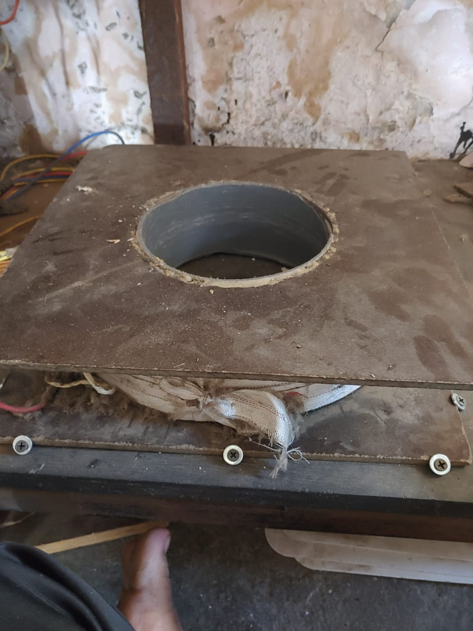

PS: have you already built the magnetizing coil?
Post a picture or two.

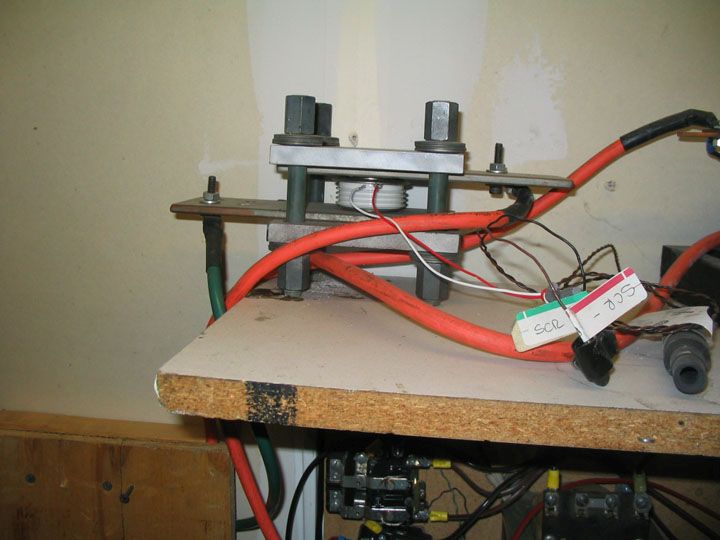

Hope you got a BIG SCR.
Many use so called "Hockey Puck" ones, because of the case type designed to be sandwiched between heatsinks.

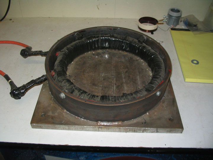

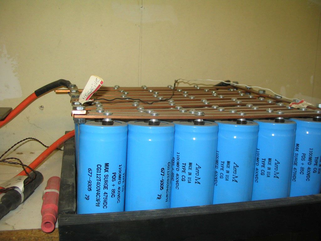

Attaching:
* "hockey puck" SCR
* capcitor bank
* magnetizing fixture.
EDIT:
Some magnetizers used in Factories (such as RCF and probably the 60´s JBL one), and my "large one" allow for magnetization of speaker already inside the shipping box.
And speaker inside box may be magnet up pr magnetb down.
But the practical way is to have a (large) DDT switch between coil and capacitor bank , magnetize both ways, and label it "North up" and "South up".
Then you choose whatever´s needed at the moment.
In my small magnetizer at home, up to 105 mm magnets, I simply plug fixture into supply using an Industrial, 2 round pin connector.
If needed I unplug and invert it, easy peasy.

I tested the SCR. I guess there is internal resistor from gate to cathode.
What i did was i connected negative of 1.5V battery to cathode and positive to gate and voila it turned on. As it was just testing it turned off as there was no current passing through it.
Resistance while on was around 0.592 Ohms.
Is the measurement correct? Also do you think i got correct SCR or went overboard with ratings?
