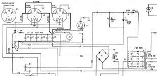

Sorry but 150-300 Amp thyristor is too small.
Look at Chinese magnetizers data I link below ad they mention 15000 to 40000 A output capability.
Admittedly those are millisecond wide pulses, but even so....
http://www.vatmag.com/products_28/364.html
Look at datasheets, "official" spec is continuous duty, such as handling electric motors, etc. , all have a much higher single pulse rating which applies here, as long as you allow for, say, 30 seconds or more per speaker magnetization, in any case derate at least to half that peak, basic "good Engineering practice".
That is a very good and complete manual for an excellent magnetizer.
But it´s a Lab/University type machine, capable of small magnet charging, designed for testing samples , say a thumb sized rod, a small Alnico or Ferrite cube , "up to" a Magnetron magnet.
Power is 440 Joules and it fits on a bench top.
Commercial loudspeaker magnetizers I linked above go from 4500 Joule (10 times larger than the Lab/Bench type) to mind boggling 90kJ
FWIW I am using around 6kJ and it works fine for up to 156mm*20mm Guitar speaker magnets, think Celestion Vintage 30 or G12H
That said, a "large" machine is basically the same as the RFL440 , only scaled up 10-15X or more.
But exact same Physics behind it.

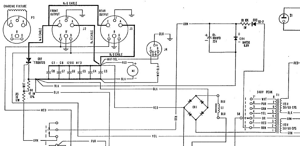

Functional and simple design, like all of Elliott´s
Does work, of course, almost same as RFL440, and somewhat higher energy storage:560 Joule.
Still in the experimenter´s area size, not industrial.
Again, same Physics apply.

Here are some pictures of what I figured out. 12,600 microfarads of capacitors(1200 volt non polar). Can charge to 1000 volts.
2 magnetizing fixtures--one for old Alnico magnets(JBL and Altec) another for up to 225 mm ferrite magnets. Saturates the magnets easily.
