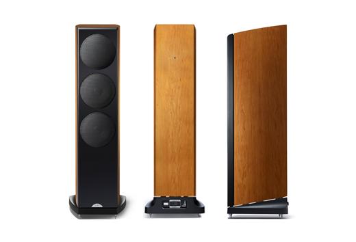

At CES 2012 I had first BMR audition: Two prototypes @ HiWave private room, Minx @ Cambridge private room, and Naim's positively magnificent Ovator S-400 in their regular room, absolutely humongous sound stage, overall presentation natural, smooth, effortless, appeared to lack all audible trace of glare, haze, grain, fatigue, and texture...one of the best loudspeakers I've ever heard and I've been hearing the best extant for about 30 years (music, recording, high-end professional...only association to this subject is HiWave made my music instrument accessory).
BMR may be the biggest speaker breakthrough I've ever heard.

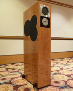

Pics for fun (Hiwave demo, Rega demo, and Naim).

Thanks for posting the BMR images. I heard that little clear plexiglass wireless speaker in the HW room! The Ovator sounded just stunning. I'd love to read a Rega review.
