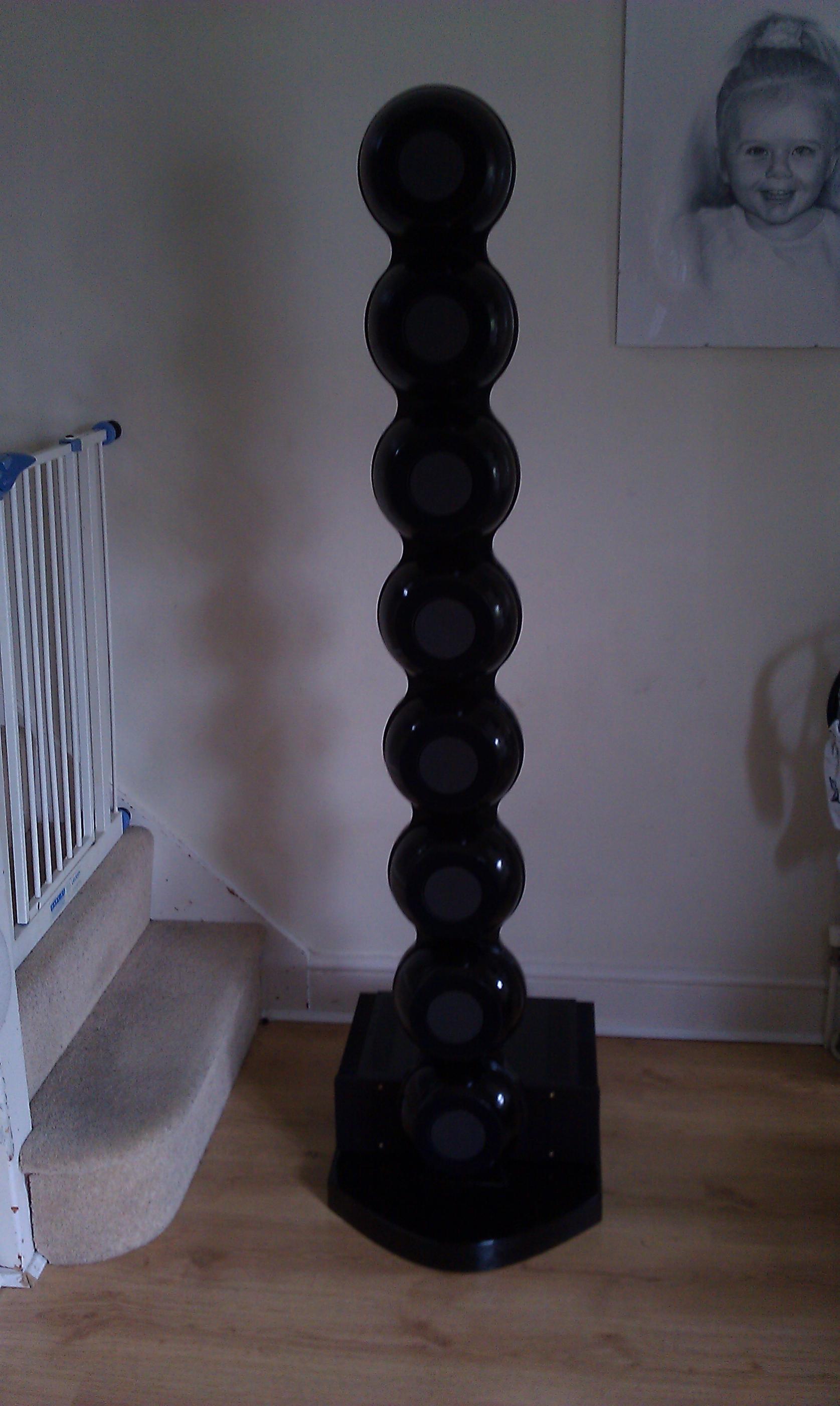

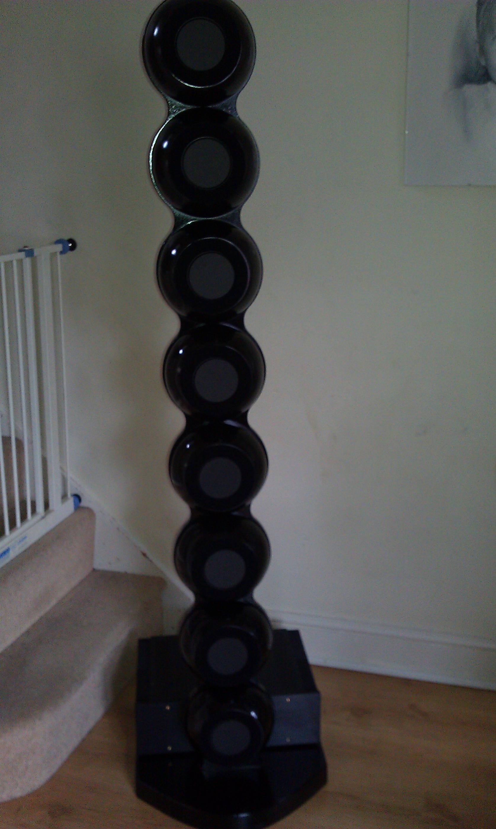

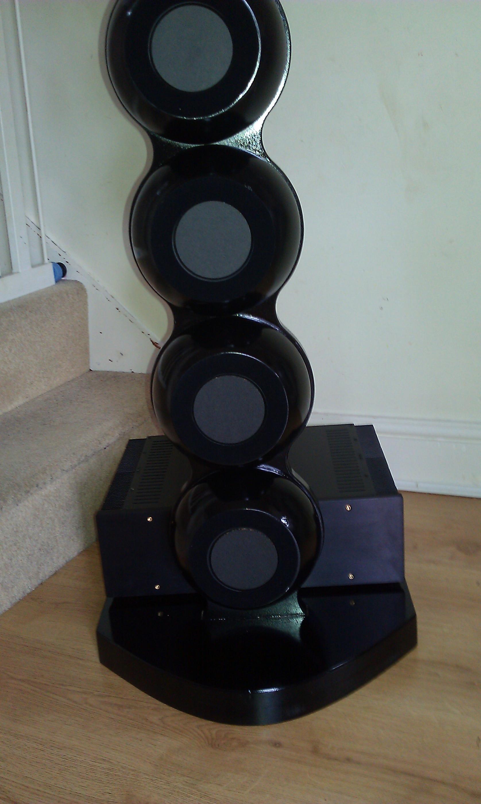

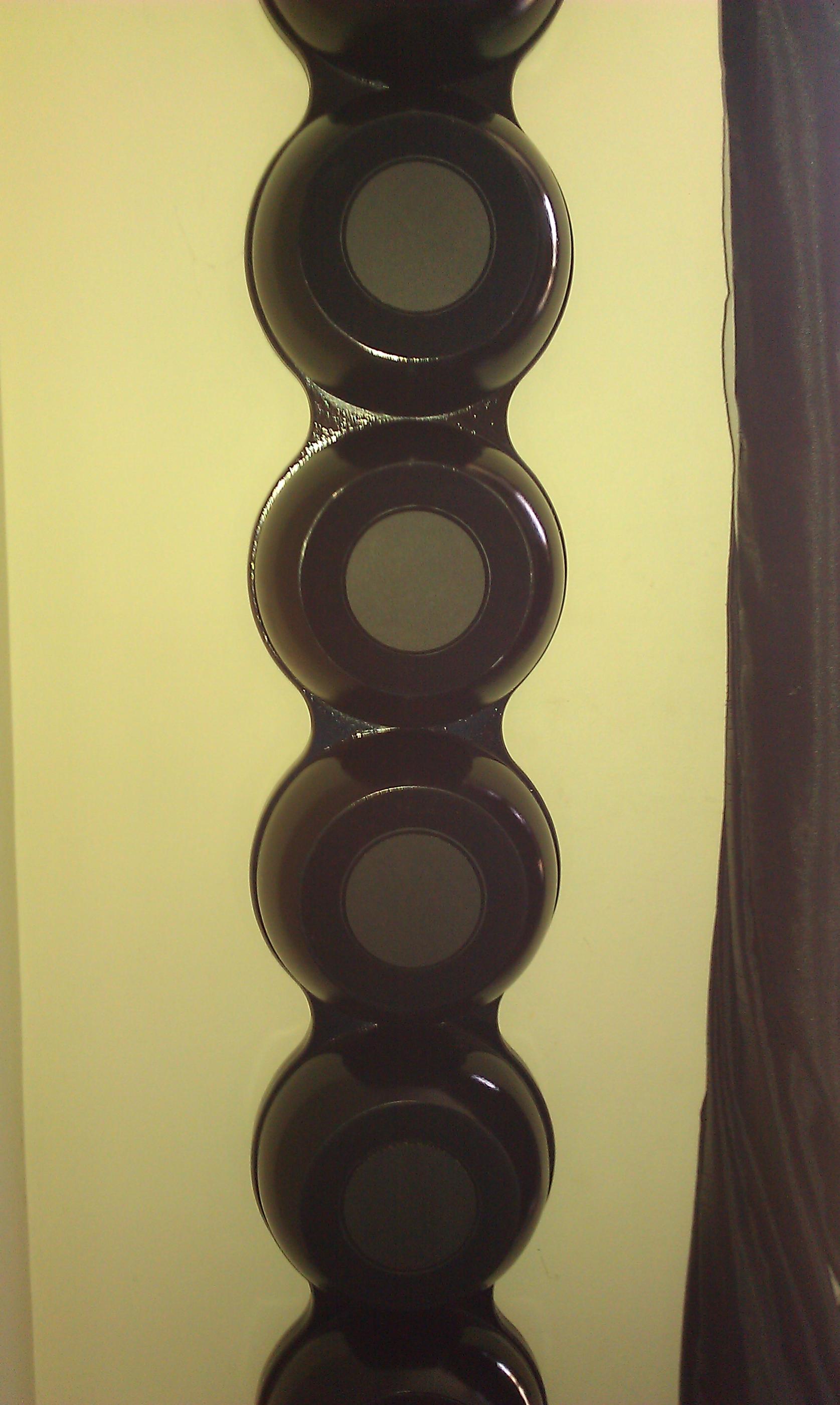

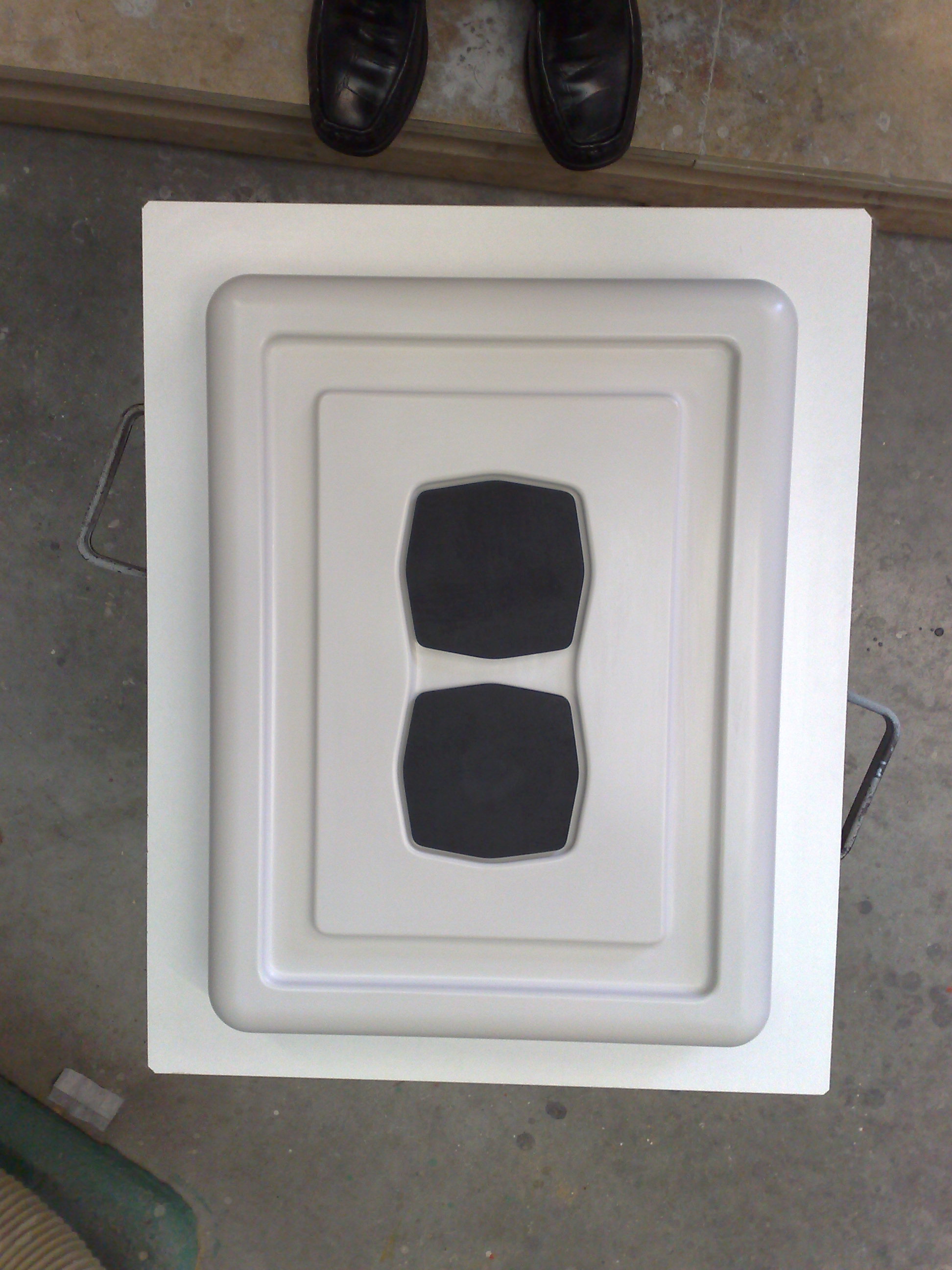

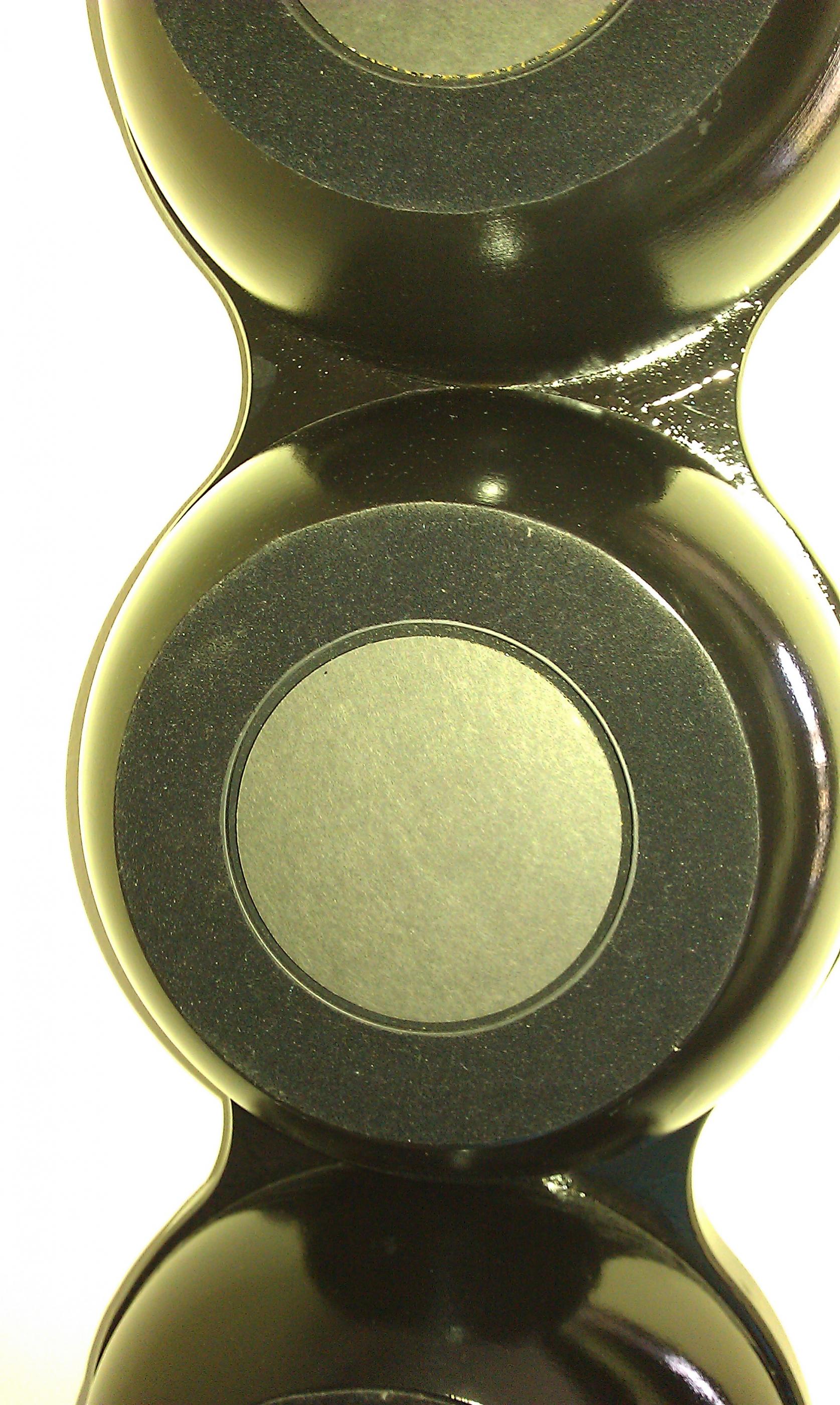

BMR Line Array
Sorry previous pic was from 4 years ago, an old on wall GRP cabinet...
The attached are the correct photos!
I have now cut off the base and mounted the array on the wall...very cool indeed, I will need to take some pics of them on the wall.
Cheers
Derek.

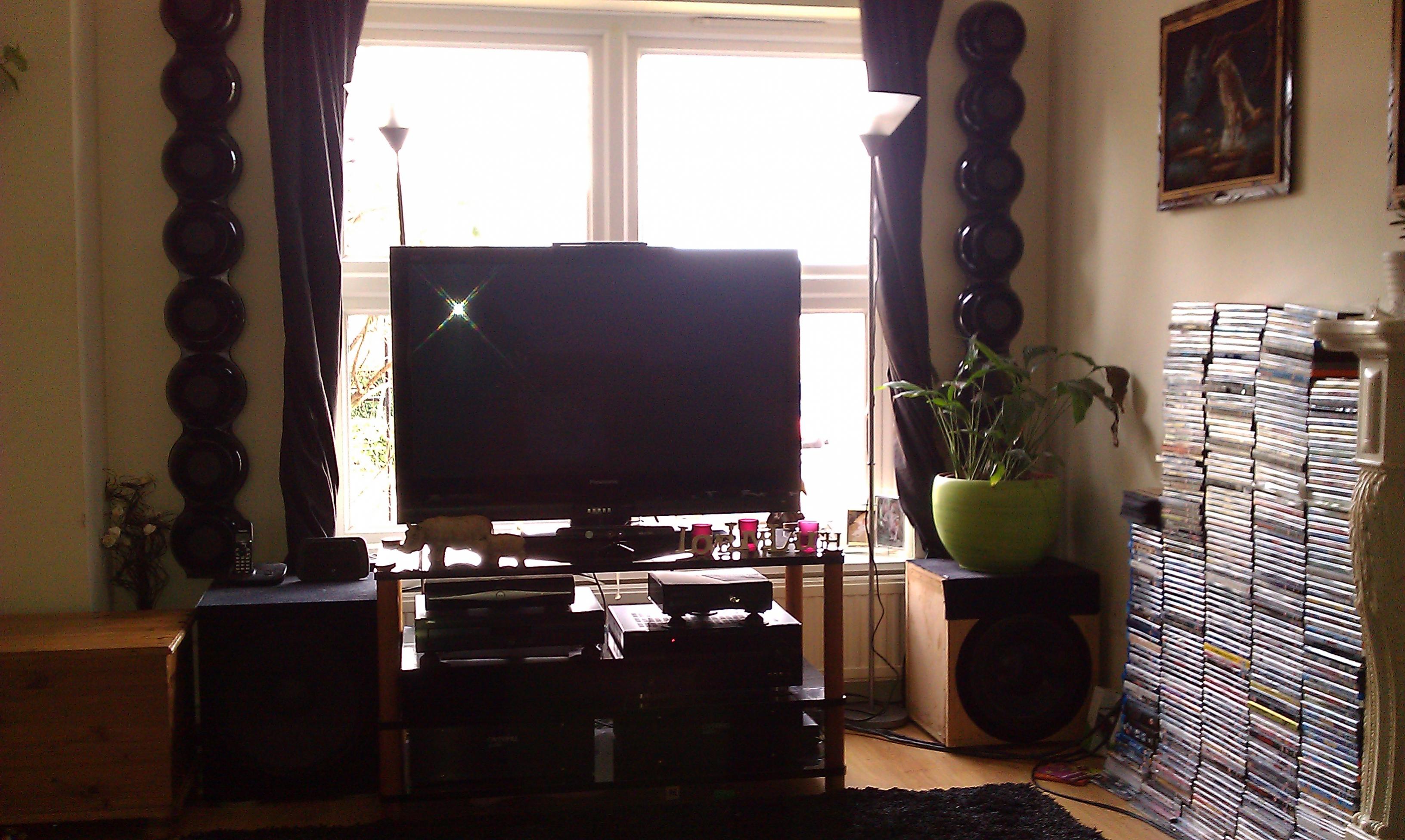

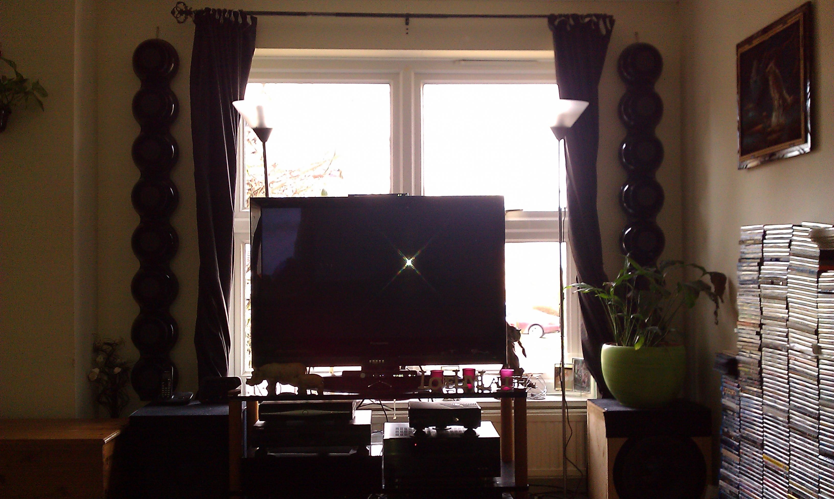

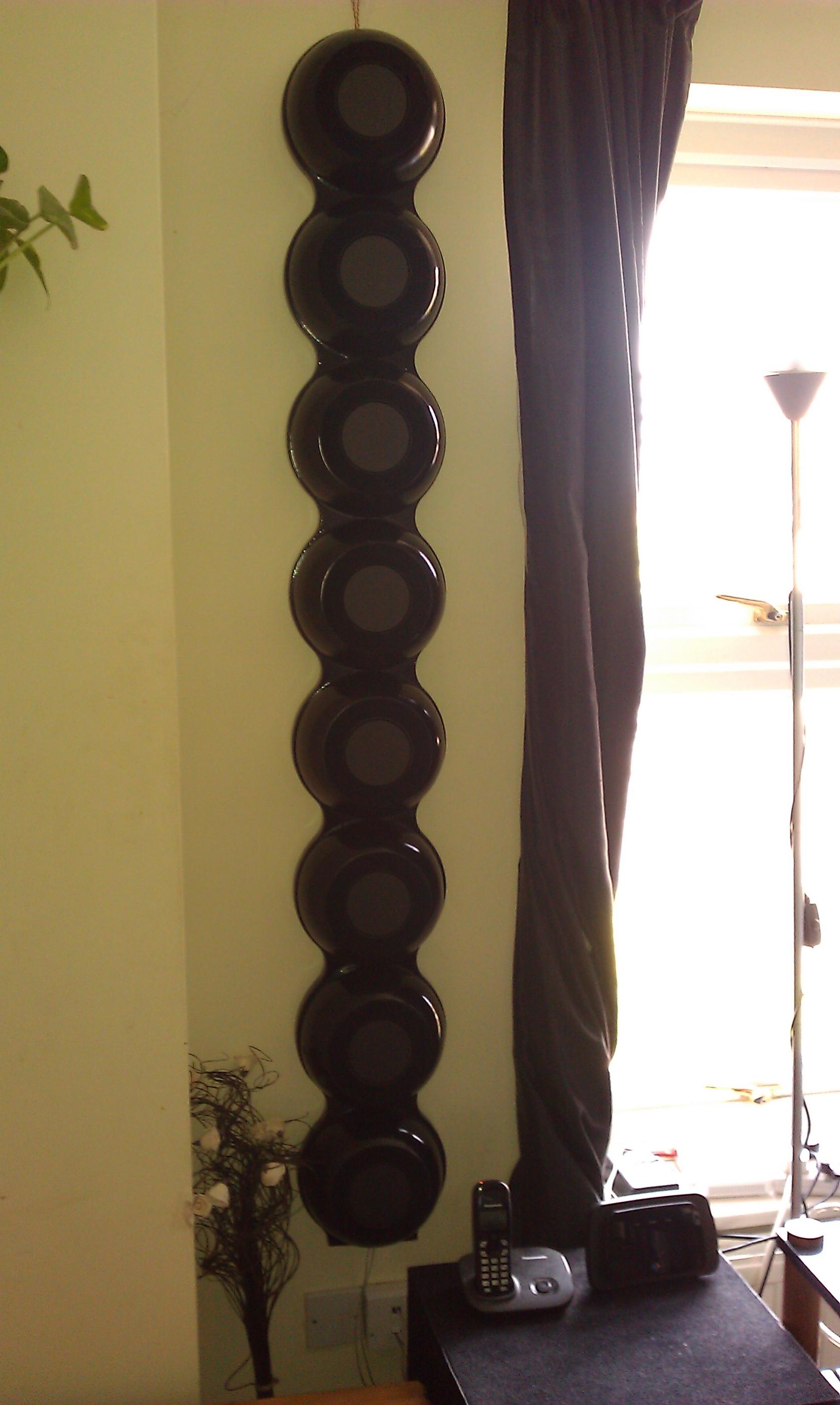

Some pics... on wall BMR Line Array
Hi Guys,
Some pics of the 8 driver array on wall.
Camera phone shots so not great quality but it gives you an idea of the asthetics in typical UK lounge.
Each speaker only weighs 12 Kg so they are easily hung on 1 screw with a raw plug.
Cheers
Derek.
That looks cool as hell, and I bet it sounds fabulous. Not sure I'd want a window right behind my TV though - seems like it could make it difficult to see the picture. BTW, where's your center?
My only exposure to BMR is a pair of Cambridge Audio Min 10's I have hooked up now, which were lent to me by a friend. Imaging and clarity from these tiny speakers just amazes me. The only thing lacking is strength in the lower midrange, where they can sound a bit thin. That's precisely why I want to build a set using larger drivers; once the midrange issue has been resolved I think it would be very difficult to find any fault with the sound.
BMR Line Array sound
Hi Jman,
I also found the lower midrange to be a bit weak with the small BMR's.
The 4.5 inch really is the "Goldielocks" drivers as it still has a lovely high end but enough Sd to move some air when you need to hear percussion and left hand piano, cello etc.
Back in 2008 I found that a pair or 4 drivers per speaker was required to reach high enough SPL's in typical rooms. Both the flat on wall models were ported to help boost the bass and also had passive crossovers.
The crossovers were designed by Chris Ellis, one of the BMR drivers designers and a full on audiuo genius so as good as it gets with passive.
There is still a big step up in performance when you go sealed, DSP active crossovers and Eq. The BMR is a perfect match with DSP and efficient power amps.
My 8 driver line array is EQ'd to enrich the lower mids and then has a Linear Phase 96dB per octave crossover at 100Hz.
The main compromise I made with this design is the centre to centre driver spacing to achieve the curvy asthetics. In theory it suffers from comb filtering but real world in room reflections even out a lot of the nulls and peaks.
The speakers have such fantastic imaging ( over the whole 4 seater sofa )that I dont need a centre channel! Two channel sound staging is rock solid from almost anywhere in the room and the sound from the next room is very much " who is playing piano in the lounge?"
