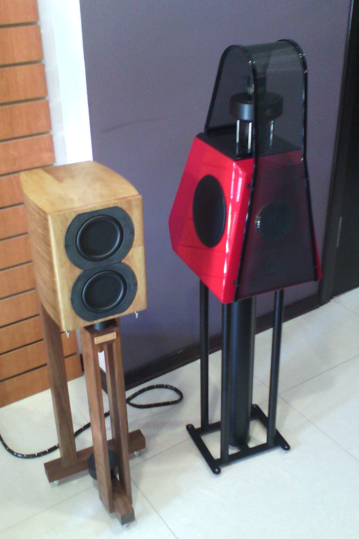

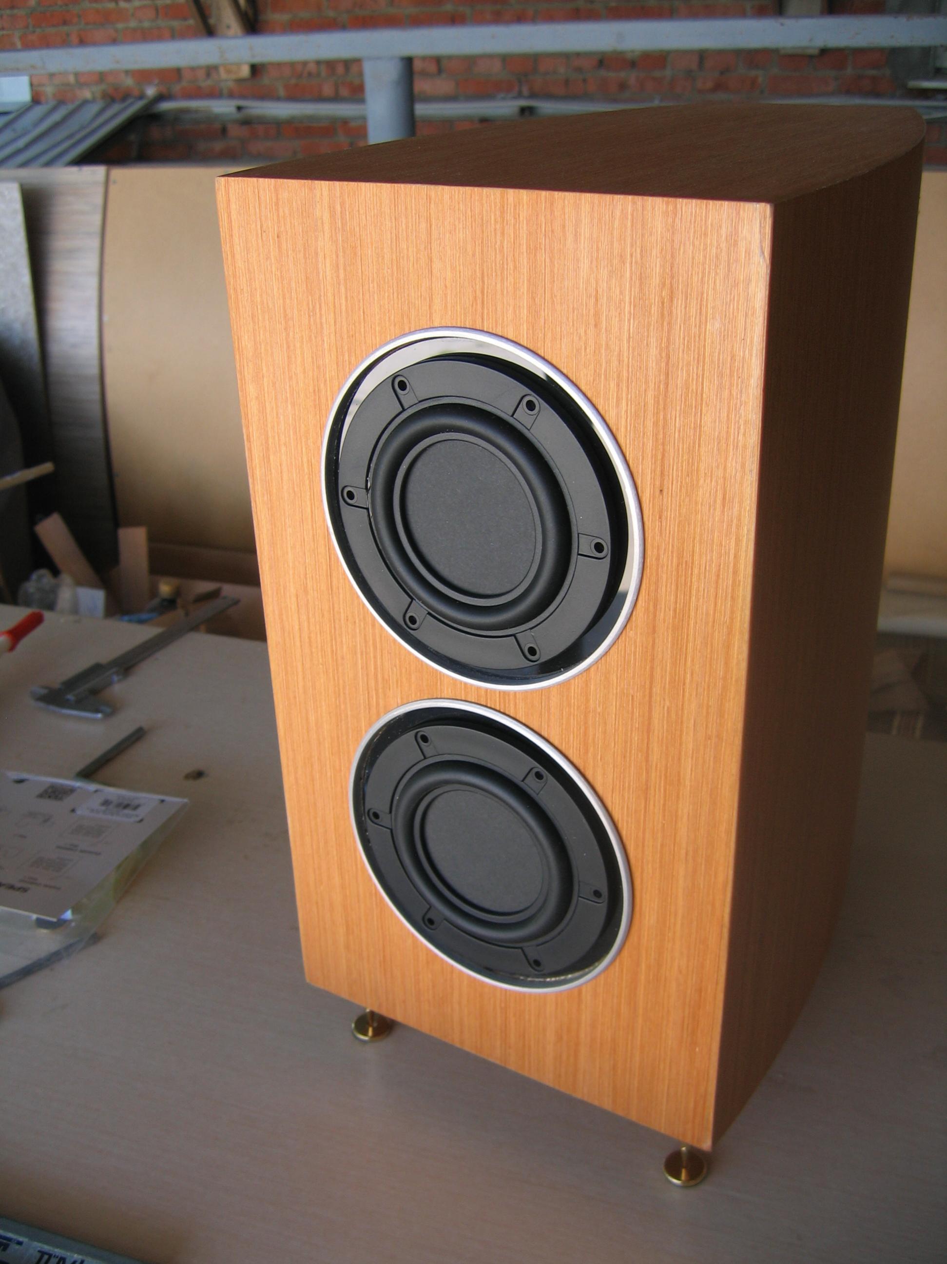

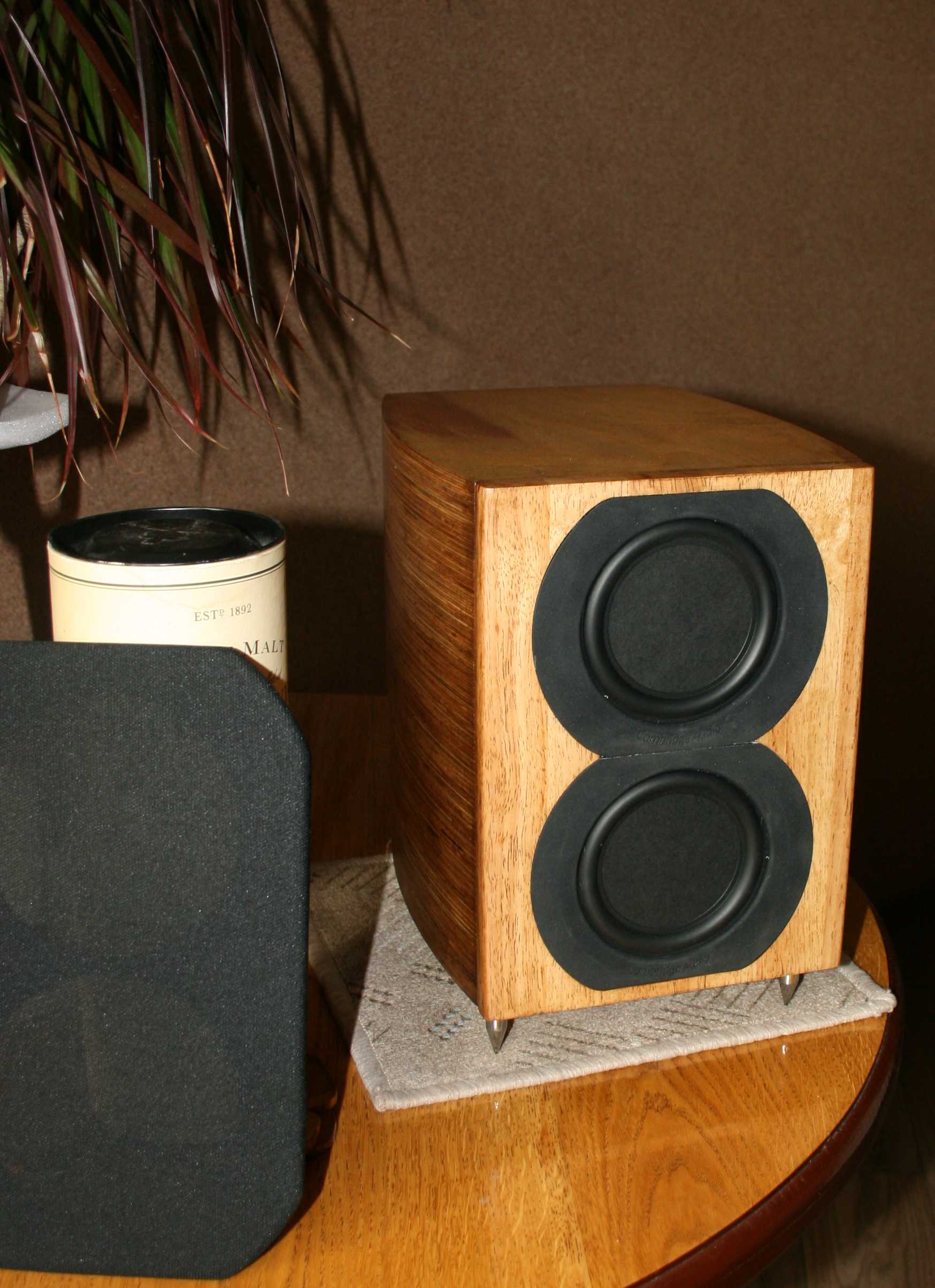

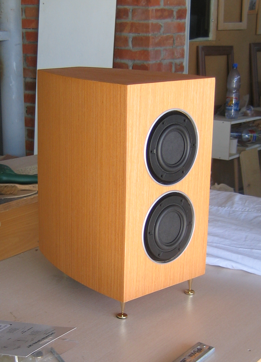

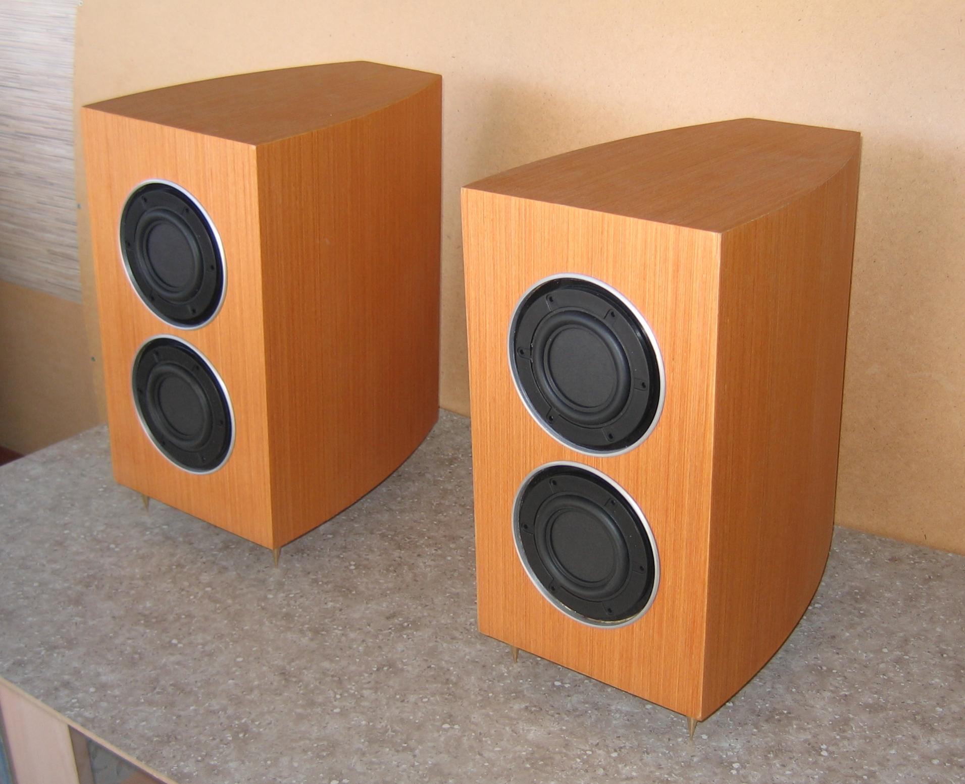

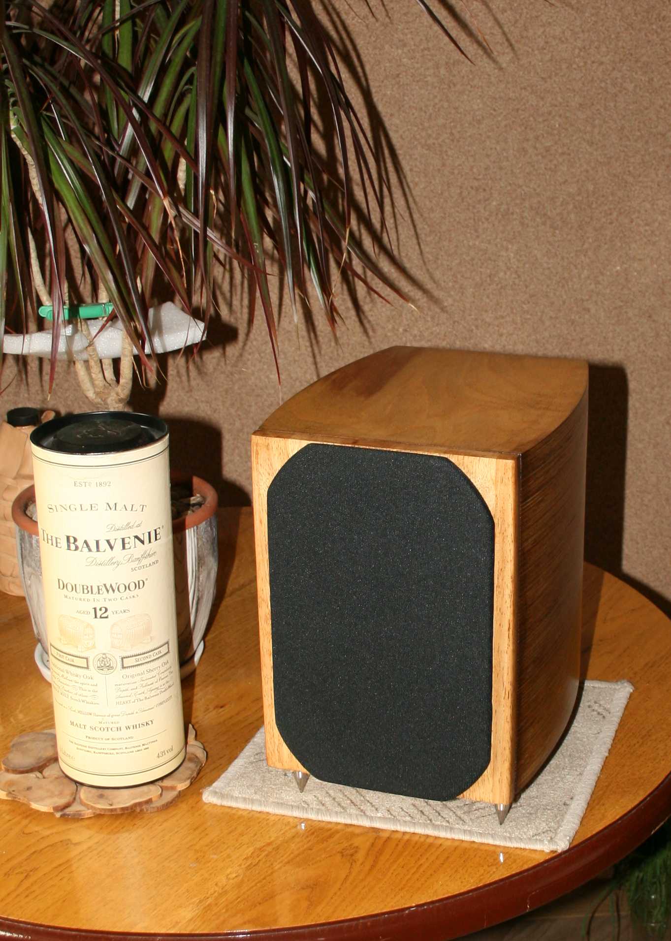

Just finished very interesting project: the customer asked to make new speakers based on Cambridge Audio Aero 3. I gladly accepted because long wanted to try a 4.5 inch BMR. And this is the result:
It is original CA Aero3 4.5 inches driversLooks good Alvipet. What driver did you use?
You can read more about my design here http://www.tornadoacoustics.ru/publ/2-1-0-22 http://www.tornadoacoustics.ru/forum/11-914-17I've heard the mbl speaker and have to say if you managed to equal or better it then you have produced a pretty remarkable speaker. I'd love to know more of your design if you care to share. Of course if it's a proprietary product design I completely respect that.
There was a chance to make direct comparison with MBL speakers. In my opinion BMR completely beat rivals
Wow, that's a big statement. I wonder why there is no more BMR like products.

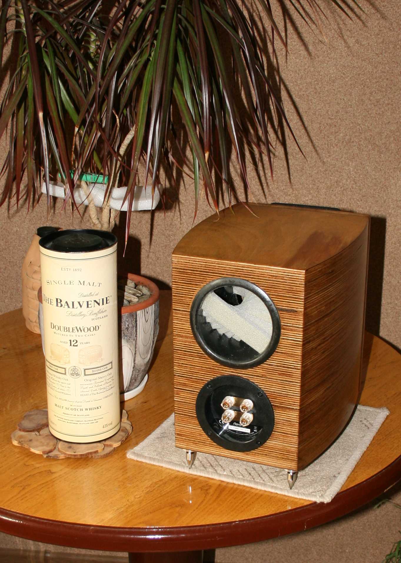

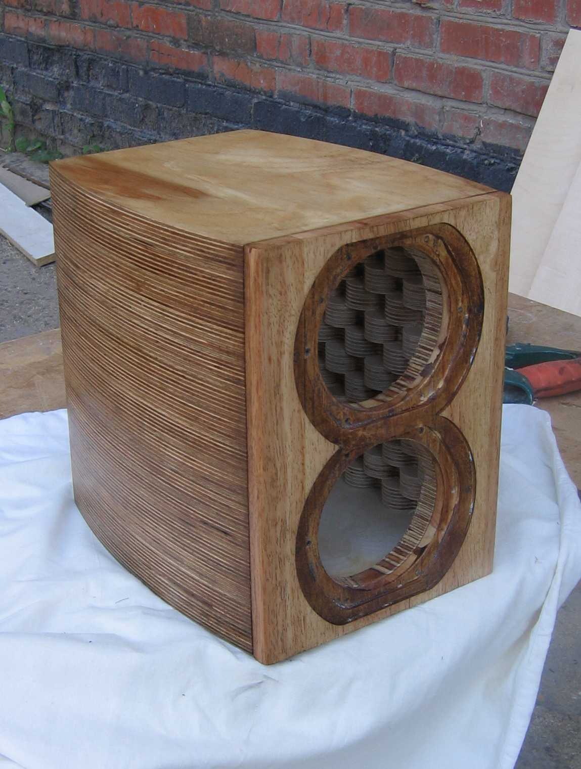

Firstly, I completely changed the design of the box (See photo). Then I removed the notch filters and the whole pack. Finally, Tornado was chosen as the acoustic design http://www.tornadoacoustics.ru/content/tech/PatentDE10338313A12004.10.21S1.pdf
Yes it is! Tornado technology allows to expand the possibilities of the conventional bass reflex and significantly reduce drivers distortions in the compression mode.So is it basically it's a well made bass reflex cabinet with no filtering and two aero3 drivers running parallel?
