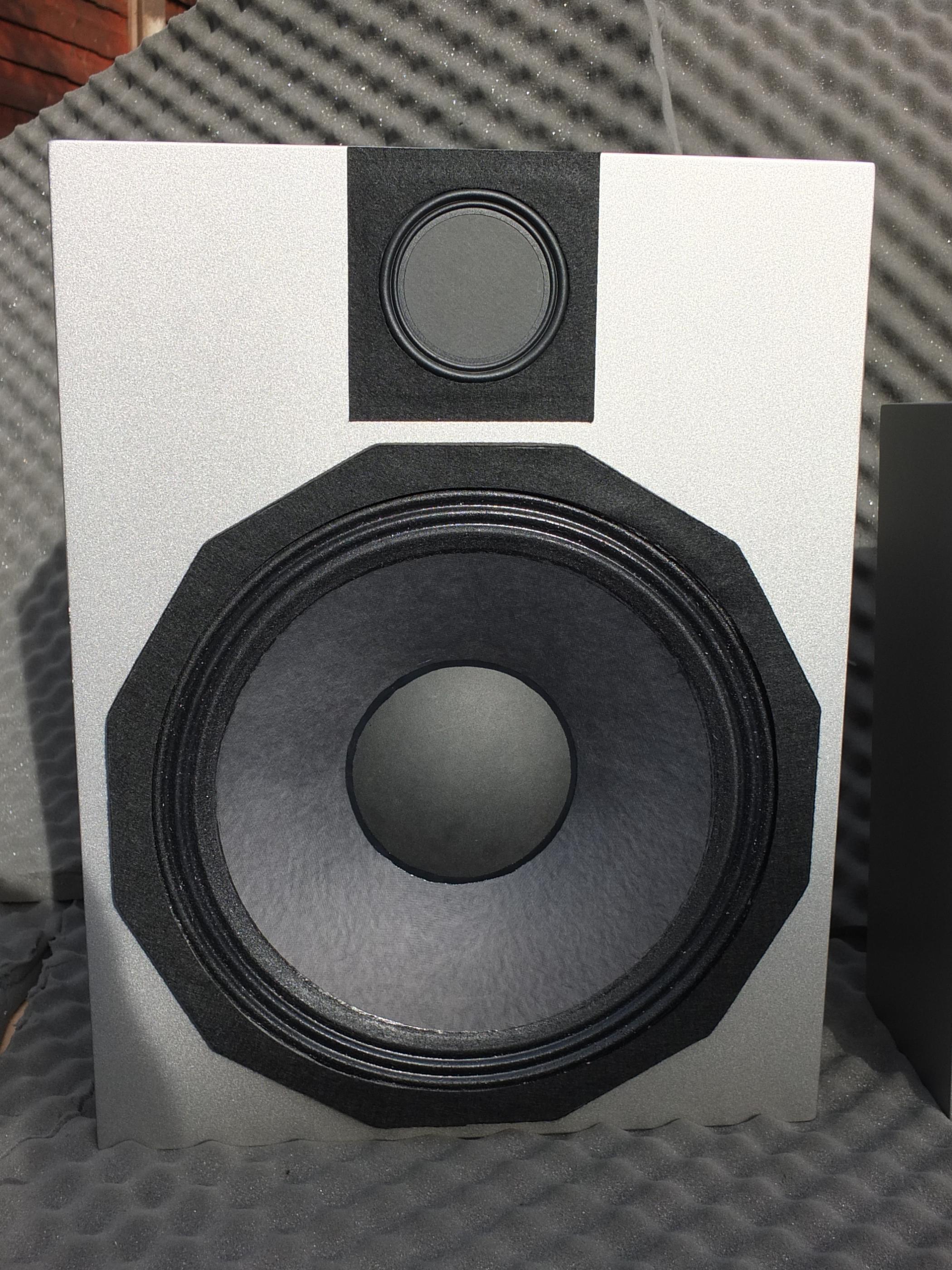

I have attached a pic of the speakers Jason heard today, the system was:
A pair of 10 year old Overkill (Belles with upgraded power supplies and Bybee's) amps.
DEQX in digital out mode.
Our new 4 channel CIA DAC (using AKM 4495 chips)
Source was a lap top with SSD and JRiver via a 5 meter long, basic USB cable.

Hi Guys,
We have been working hard on the driver (& DSP) R&D front and the news is goodbye BMR....Hello Rapid Energy Decay (RED).....Might need to start a new thread?
The bottom line is the latest series of changes to our flat coned silk surround & linen / silk spider plus new voice coil has altered the fundamentals of the driver so much that technically it no longer operates as a true BMR.
We have focused all our efforts on two aspects:
(1) The energy storage / decay performance
(2) Power response (broadest possible on and off axis frequency response)
The latest results are very encouraging......This compact near-field monitor is a real sweetie!
Another benefit of having our own driver IP is that it is now free from any BMR licencing issues & fees and this allows us to make some DIY kits available.....Yea!
The cabinet is 25cm by 40cm by 20cm (WHD) in 18mm birch ply and will come with all the fixtures and fittings required to build a pair of very high performance monitors.
The design requires a DSP crossover / Eq and we can bundle the kits with several options, more details on request, PM please.
In under 10 litres sealed air volume our 8 inch paper and carbon fiber coned bass mid is flat to 48Hz with good output down to 38Hz.
Mms to Bl ratio of 1.5 is a great match with our 1.25 silk surround RED driver and crossover can be anywhere from 200Hz to 400Hz depending on SPL requirements.
Limited availability at the moment, but should be ready to ship by May.
Hope this helps and all the best
Derek.
