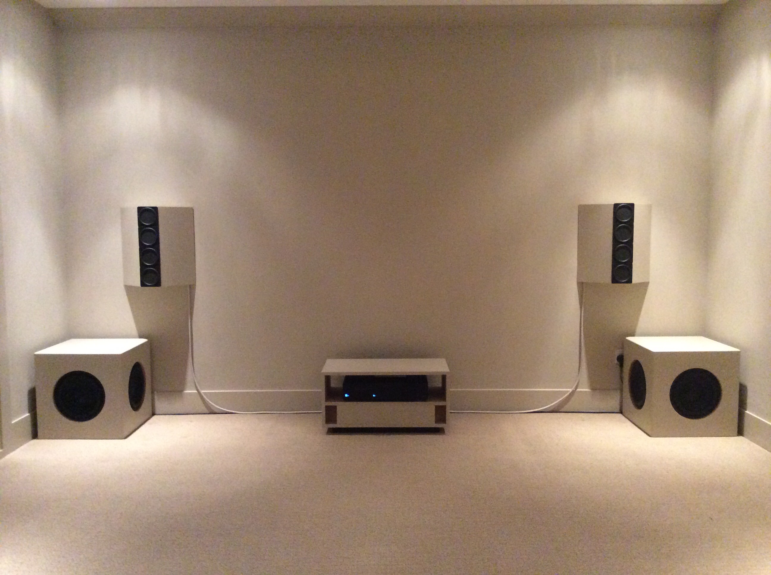

Hi Derek,
could you recommend any 10" or 12" drivers please,i'd probably use multiples,sealed & corner loaded.
Also,when will you be showing your speakers with the silk surround BMR's,i'm looking forward to seeing those.
Jason
Precision Devices & Beyma.
Hi Jason,
I like using remote subs.
Try varying the driver sizes as this helps spread the resonant frequency / room nodes in addition to multiple sub locations.
With remote subs the highest crossover you can then use is is 80Hz, this then means you will be limited in max SPL / dynamics when using single BMR's. You can still get great results, but just at low to medium volumes.
If you are seeking life like dynamics then you must increase the Sd....Line arrays are the best solution, esp if you design shallow cabinets for wall mounting....You gain low midrange output,kiss goodbye baffle step issues and have no rear wall reflections to worry about.
Given the choice wall mounting is a no-brainer compared to stand mounts / floor standers.
I dont know of any suitable 10 inch drivers, but here are some good 12 and 15 inch drivers.
PDN.12SB40
PD.1550
Beyma are slightly behind in performance and build quality but still offer great value for money.
I have attached a few docs of drivers I have used and really like, but I am sure you will get good results with most Pro drivers that drivers that conform to my suggestions a few posts ago.
Studio Au came round a few days ago to hear the silk surround BMR's.
I played a pair of single BMR's crossed over to 4 subs....A pair of experimental Seas 8 inch (Excel w22) used as subs / speaker stands(!) plus a 12 inch Beyma and a 15 inch Beyma.
I used a mid-range AV reciever (Yamaha) for all DSP / DAC's and room Eq.
Source was an Asus lap top with a SSD drive running windows 8 with JRiver.
USB out into a Meridian Explorer used to convert the USB into Toslink optical and fed into the Yamaha.
I also demo'd a 6 BMR driver mini array....I am sure Studio Au will tell you what he thought of the quality of the sound.....!
All the best
Derek.
All the best
Derek.

I have just finished a new design with 6 BMR silk drivers crossed over at 200Hz to 12 rubber surround BMR's (6 either side) so each 6 by 3 panel has 18 BMR's, silk above 200Hz, rubber surround below 200Hz.
The end product is a very compact wall mountable 18 driver full range panel 545mm by 700mm by 150mm (WHD) that is good down to 40Hz.
Re subwoofers....Using DSP / active / sealed box...This completely frees you from the traditional TS parameters and (God forbid!) the dreaded port calculations...
Any of the Pro drivers I mentioned will all work beautifully as described..... You are welcome to come round and hear exactly how great they sound good (and how easy it is to build them).....
