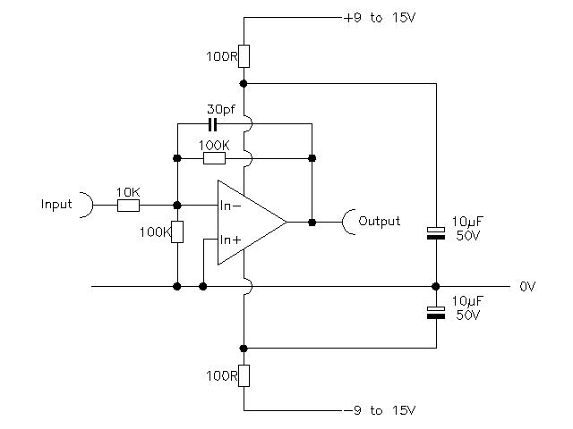

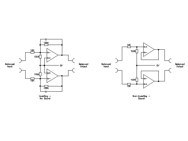

The Ebay buffer didn't work in my application.
I have finally got round to breadboarding buffers.
Application - Differential (balanced input - balanced output) buffer for Anaview Amplifier.
1 - Ebay inverting buffer - no sound used as a differential buffer.
2 - non-inverting buffer (as post 2) - works.
3 - inverting buffer (breadboarded) - no sound used as a differential buffer.
Test 3 was to prove to myself that it wasn't a fault with the ebay item.
I attach the schematic of the inverting buffer (same as post 1 - didn't realise when posting that pdf only shows icon). Half circuit shown. Both halves used for (non-working) differential buffer.

The circuit as drawn looks fine although the 100k's to ground are not needed for the inverting stage although they won't materially affect the operation. Also the inverting side has a gain of -10 compared to the non inverting buffers <1
Are the DC voltages reasonable i.e. the output being at zero volts DC ?
Pin 1 shield of buffer input is connected to Ov ground.
The Anaview multi-pin connector has a number of black wires, all are common and also connected to ground plane & thence to metal case.
One is connected to buffer and one to shield of input connector therefore the shield is connected to buffer Ov.
I have checked continuity with DMM to confirm.
I have never seen an op-amp differential buffer schematic showing inverted configuration. I am thinking this is because it doesn't work. I am curious why.
I can soon build the non-inverting buffer on stripboard and use it in my set-up.
I only bought the Ebay buffer because it was neater on a PCB.
Administrator
Joined 2007
I haven't either. The only thing I could think of (and it doesn't compute) is that you are getting 100% cancellation somehow. Why not try unbalancing things by either lifting one of the 10k input resistors, or adding say a 4k7 across one of them and then see if you get audio.
