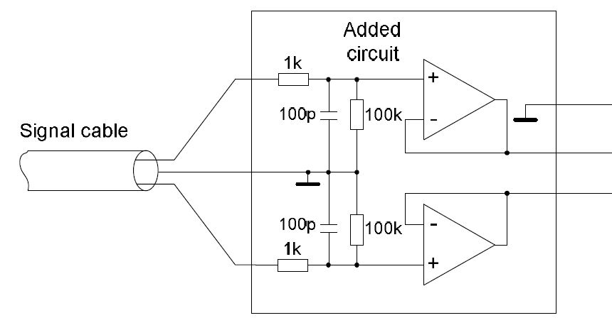

NE5532 Buffer
I should have stated, one half shown.
Complete circuit is dual.
Now I've posted the schematic I have a number of questions.
1 - The buffer is inverting. What is the purpose of the 100K to ground? Textbook examples do not show this.
2 - gain - 100/10 = 10 or does the 100K to ground change this?
3 - Why the two 100R resistors in the supply lines?
4 - the purpose of the 2 small caps across the feedback resistors?
I bought a pair, not realising they were inverting.
Can I still use as a differential buffer, using one half for Hot & one half for Cold signal?
Attached is the recommended input buffer I was aiming for.
1) stops he output flapping around if the i/p is disconnected and keeps Zin reasonable; not infinite.
2) gain cannot be >1 in this configuration. It is 1% less than unity.
100K / (100+1)K
3) these help the decoupling effect of the psu caps.
4) often required to keep things stable: eliminate output peak on square-wave and/or stop oscillation.
Administrator
Joined 2007
The 100k is odd in an application like this. It increases something called 'noise gain' and is inappropriate here, although there are instances when it can be used. Just not here :)
It does not materially effect the closed loop gain (as configured here).
The 100 ohms increase the effectiveness of the rail decoupling caps. 100 ohm is perhaps a little high though.
The caps tame the high frequencies and aids stability. It is called 'phase lead compensation' and increases the amplifiers phase margins.
Your second circuit is fine, and that needs the 100k to provide a DC reference point (which is ground) to correctly bias the input.
the post2 sch can be improved by connecting the two filtering capacitors direct to chassis rather than to audio ground.
The 100k stay connected to audio ground.
If you can fit the 100r direct to the connector pins and then from the 100r via the caps to chassis then you have the least internal cabling with the interference spraying emi inside the enclosure.
Depending on the shape of the connector pins and the housing you may be able to use smd resistor+smd cap without any wiring to maximise the filtering effect by omitting the inductance of the leads.
You are showing a connection from the screen coming in past the enclosure panel to a BAR symbol. then to the junctions of the caps and 100k.
Is this connection from a balanced impedance cable screen/shield?

The fact that it inverts is no disadvantage to the operation. Absolute phase is something that is argued about... if it bothers you then all you need do is reverse your speaker connections to correct it.
The ebay board is drawn as an amplifier of -10 gain (- denotes inverting). To make an inverting buffer (-1 gain) you need to replace the 100k feedback with a 10k. The extra 100k shown can be left in place.
The input impedance of the inverting circuit is equal to the first 10k alone. If that is to low then make both the input and feedback the same value and increase them to say 22k.
The small cap across the 100k will have its effect altered by changing the 100k to 10k but that is probably a non problem. Out of interest, what value is the cap ?
You should also add a small resistor to the output of the opamp of around 33 ohms or 47 ohms. That eliminates capacitive loading effects from causing stability issues.
If the opamp is an NE5532 then there will be a small DC offset at the buffer output which means that you may need to think of adding a small cap at the output of the opamp to block it.
