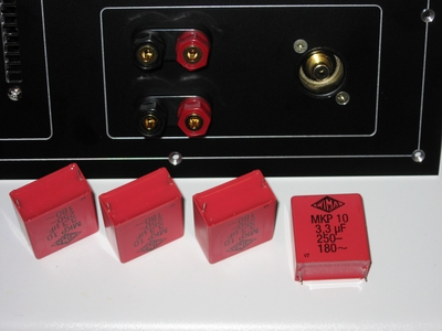

Originally posted by cdl
my purpose of posting here is triple:
1) I'd like to hear whether others have EMC issues with their NCD's- if not likely that there's something wrong with my implementation (since Eric has it too, so far no indication of error in my setup).
2) I'd like to hear some more opinions on whether the EMC kit might solve the problem, before I go through the trouble of mounting it... (and getting an extra set of caps & ferrites since I have dual output terminals wired separately all the way to the amp module output). (So far all I have here is that you don't seem to think it will do much good).
3) As you pointed out, Lars must be offering the EMC kit for a reason - and with the intent of actually sending it to those who need it. My emails may have been lost in a spam filter or in piles of work, so I'm hoping to catch his attention in here.
Thanks for the tip about the disinfectant.
/cdl

Hello Everybody
Somehow i only got an e-mail notification of activity on this thread recently, so that's why i havent replied before now. Sorry about that!
The problem about the EMC seems very strange to me, i have myself a standard NCD sitting right next to my tuner, and it receives crystal clear any station. I would like to swap a module from one of you guys who are experiencing problems, to give a good test in our EMC rig.
We have a special room in our concrete basement (for lowest possible background recepition) where we have installed antennae and a spectrum analyzer.
About the EMC kits, the problem is perhaps that people send me e-mail about getting a kit, and i must admit i am not always quick to forward the e-mail to my shipping crew, to get the goods in the pipeline.
We do have EMC kits in stock ready to send to anyone who might experience an EMC problem, but the trick is just to get the message through to the shipping people.
As you might notice from our website i don't work in shipping, but in development, and that is development of also other projects than you see at NewClassD. So sometimes when i receive a request for shipping an EMC kit, i am sitting on an assignment away from home.
I do however recognize the full resonsability, and so will do something about it.
To correct this i will go ahead and setup the EMC kit as a free product on our website. This way you can 'order' an EMC kit, and this way the word will get right up on the screen of Brenda who takes care of our shipping, and not my crowded mail box.
If you don't want to wait for this, you can also click on the E-mail address listed under 'Shipping' and this is Brenda's direct e-mail.
This way you will see some swift action.
CDL i have just forwarded your request to Brenda, so no need for you to do anything, and sorry about the delays.

Hi CDL and others,
Just a small update on my noise problems, and an attempt to revive the discussion I got the NCD kit mounted today - with the unfortunate result that not much changed
Mounting the kit as described, with the capacitors between copperstrip and LS terminals and a ferrite on the LS-cables inside the enclosure yielded no noticeable change on of the reception of my kitchen radio. Mounting additionally a set of ferrites on the speaker cables outside the enclosure did, however, make a difference. There is still noise on the FM reception but whereas before the music from the NCD amps would play through the radio (albeit distorted and noisy ) it is now the actual FM signal dominating and with significantly reduced noise.
I am a total noob on this subject - could anyone interpret this for me?? Should I try larger ferrites, or are there any other suggestions? There is still quite noticeable noise in the FM reception so an improvement of the 'filter' would be greatly appreciated!
