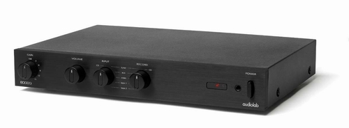

Lazy
I've got rid of the potentiometer (to much loss of detail) but was to lazy to build a buffer and inputselector.
The solution presented itself : 70% discount on a brand new audiolab Volumecontrol/input selector...(8000Q)!!
Yes, I know : easy way out, but for this kind of money there is no alternative...
Cheers, Eric.
