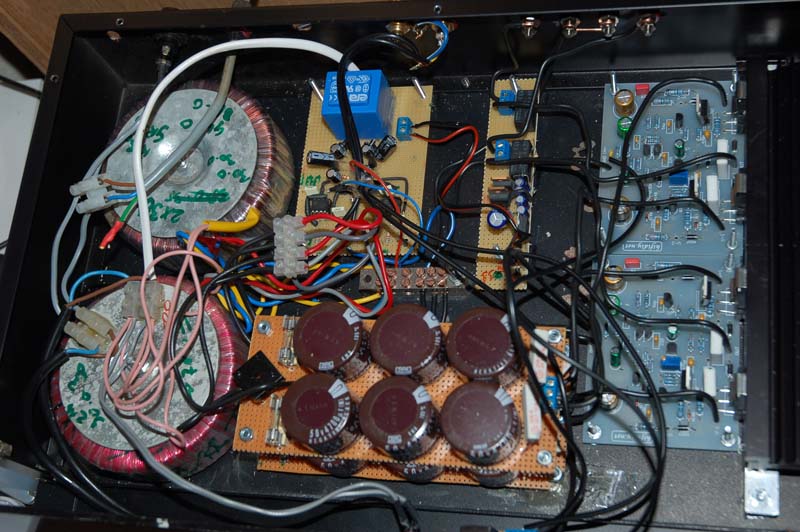

Just "finished" the build of my NAP-140 clone. Still have some tidying-up to do, but it works just fine.
2 transformers 30-0-30 120 VA feeding 6x4700 mF + 1 mF film / channel all connected with 1,5 mm copper to the NAP-clones (hifidiy.net)
Preamp is a simple single op-amp design (OP-177) with 2x amplification and a seperate power supply (78/7915) connected to the NAP with very inexpensive wire and a downright cheap pot.
Speakers are connected via a turn-on delay, but I think I need to add a fuse in the ground-line.
Of course these things are never finished, but what would you advise as the next step to take? (sound-quality-wise)

I keep seeing these referred to as NAP140 clones, when in fact they are clones (and not 100% accurate at that) of the Avondale NCC200 amp boards.
If you want to clone the NAP140 I suggest downloading every picture of the NAP140 or 180 circuit boards you can find on the net and a schematic and alter the necessary components on the Gigaworks boards. It's not too hard to do (I did it once though haven't got the relevant docs any longer alas, though could post photos of my boards) and does get you one step closer to that addictive Naim sound...
