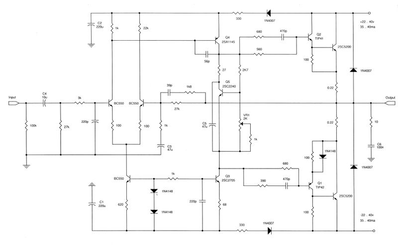

The Naim is an odd design that has some oscillation modes that are fairly benignly (ie: without setting anything on fire). It may be this benign oscillation that's causing fatigue....

I would have a look at the HF performance with a decent oscilloscope if you ever experience listening fatigue. You may be either straining to listen too hard and long or there really are visible signs of instability or maybe just harmonic distortion. Assuming you can do this testing at your workplace, perhaps they also have a low distortion oscillator that can be your 1 kHz pure reference tone.

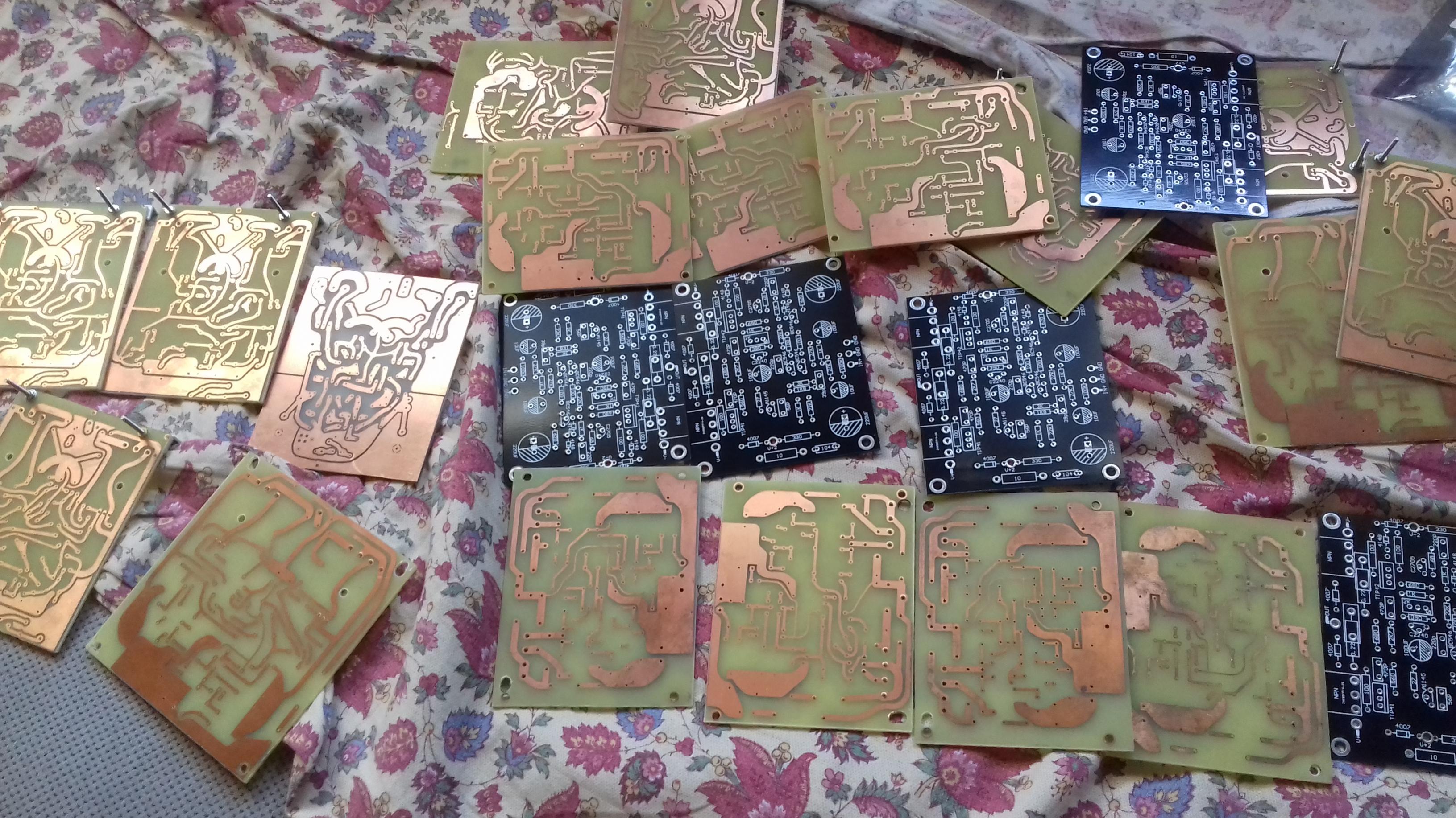

Yep, but i think i will have to solder new boards...i have thousands of them, various designs.

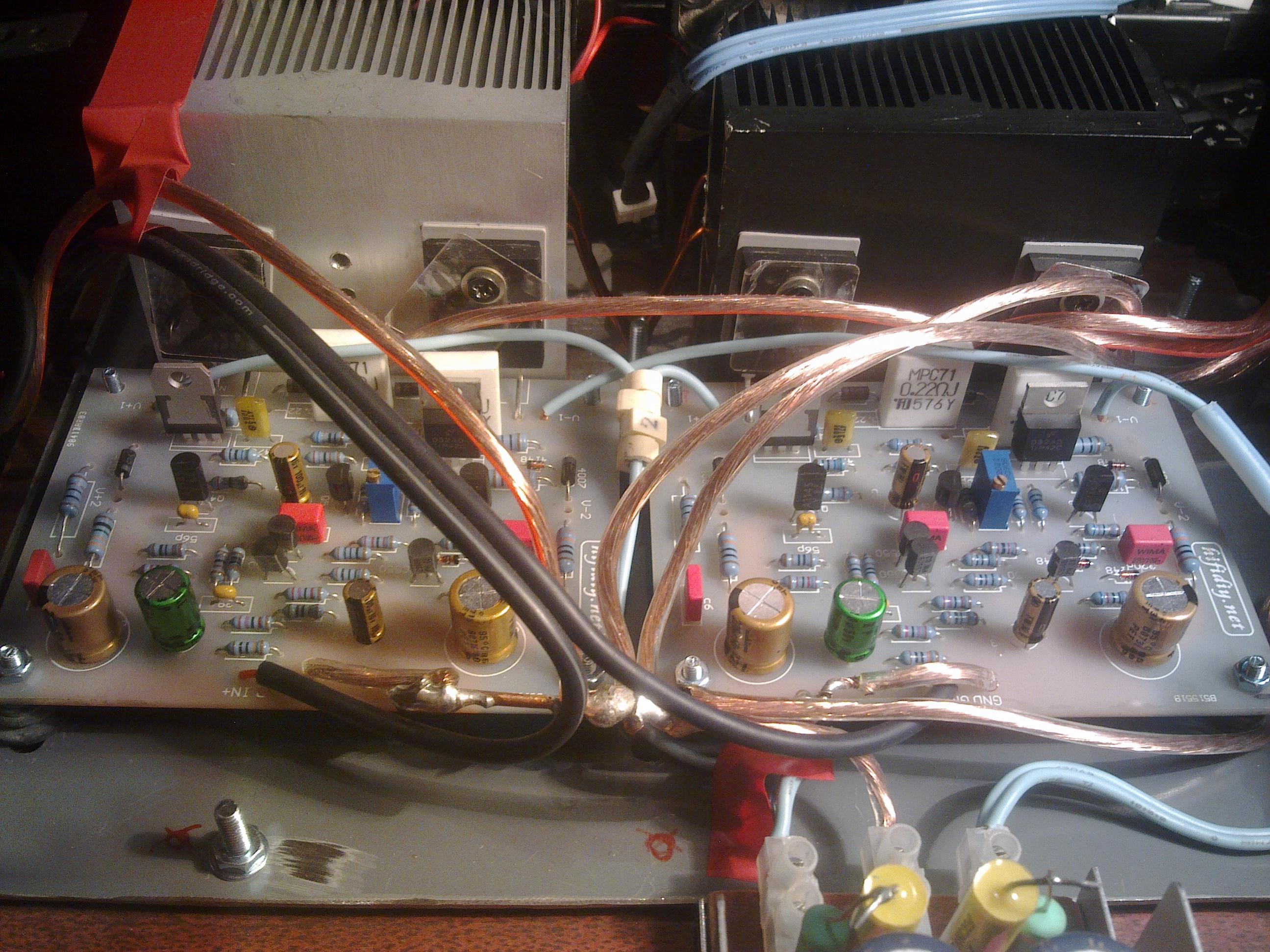

Yep legion, the first picture is legendary :D

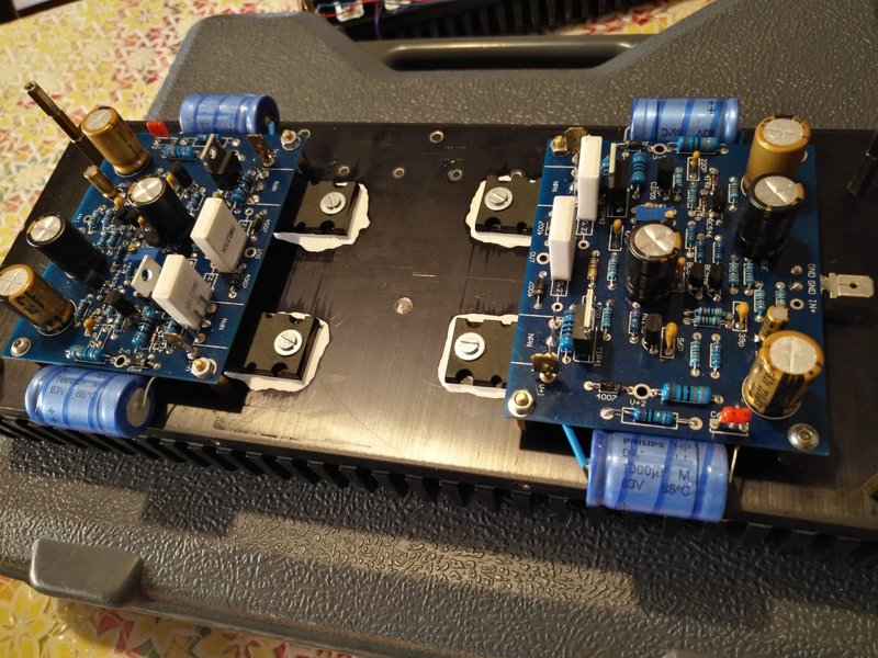

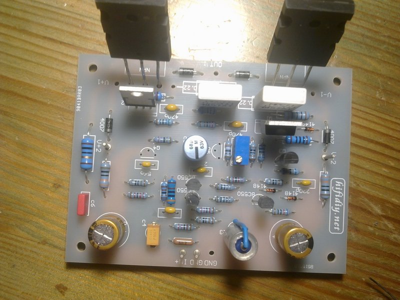

I was lucky with transistors when i first got this kit and build it as my first ever amplifier. But this amplifier thermalrunaway after month and a half... and i lost all the outputs, drivers and VAS stage + speakers and could have been lost my house also if i weren't home that day.....
This thing had this "front end" and clear sound signature... it wasn't there always.
It was a good kit... i remember i had pretty high DC offset at the output. It did only work with 2SA1145 and its counterpart, PCB trace lenghts and widths are important.
EDIT: last pick is my first amp... too bad i did not measure anything from that time.

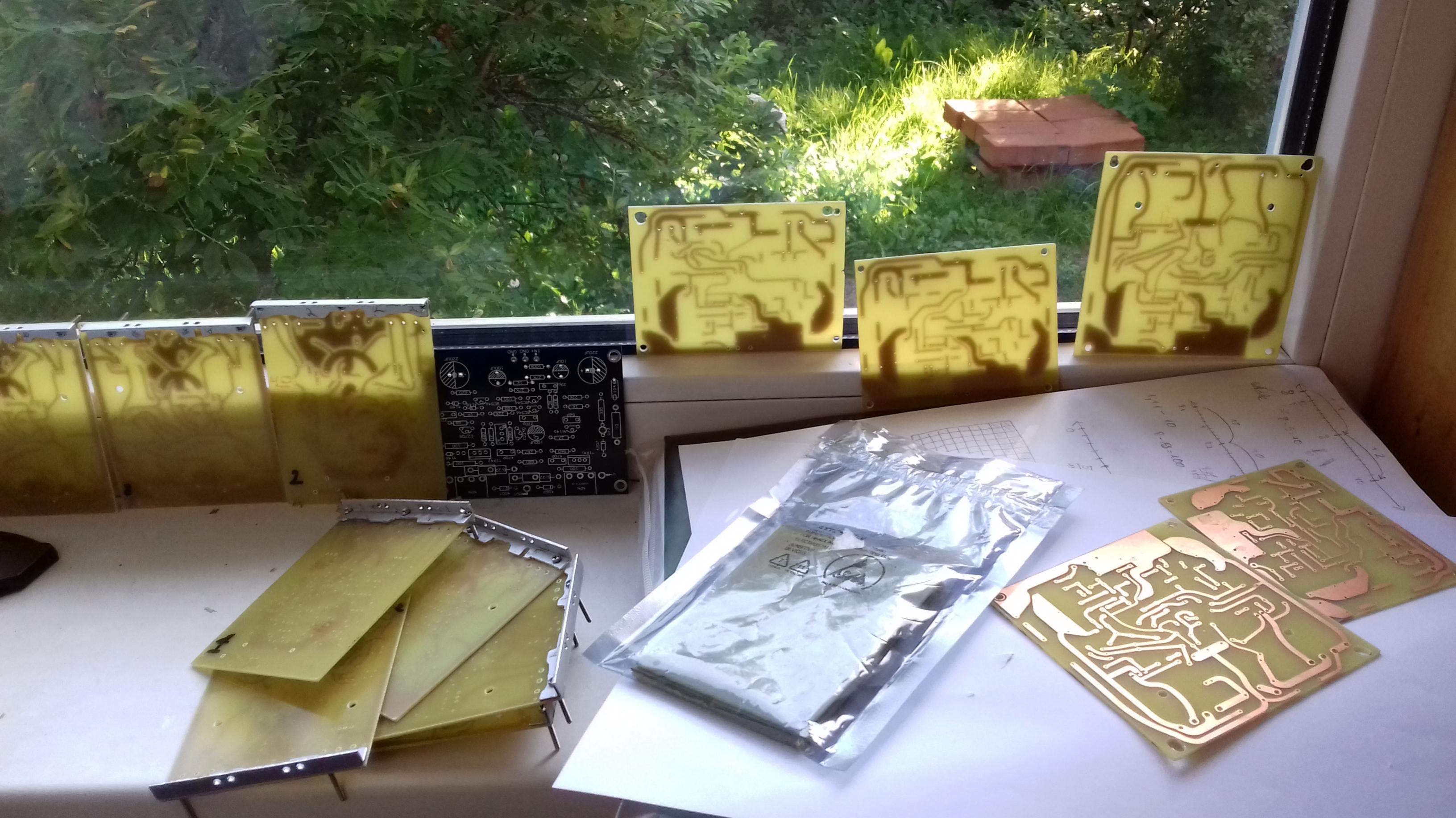

Black PCB's are ordered from china when they were still available and then i copied the design, scanning into a computer and redrawing it exactly as original :D
But to clarify, original naim(with good pcb, layout design) beats any kit out there, no questions. Does not matter how much filtering u add to the rails or psu, plain naim eats all kits easly
