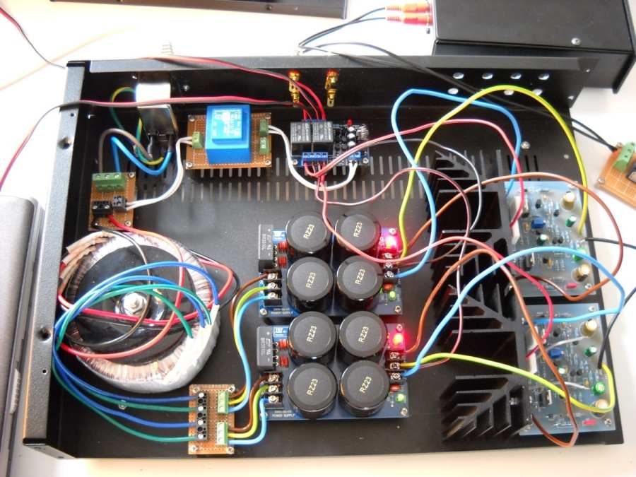

Problem with hum. This is my nap140 clone layout. The sound is ok but i found little hum. Any suggestion about wiring and grounding. I don't know how to ground it correctly.
Thanks.
Thanks.
