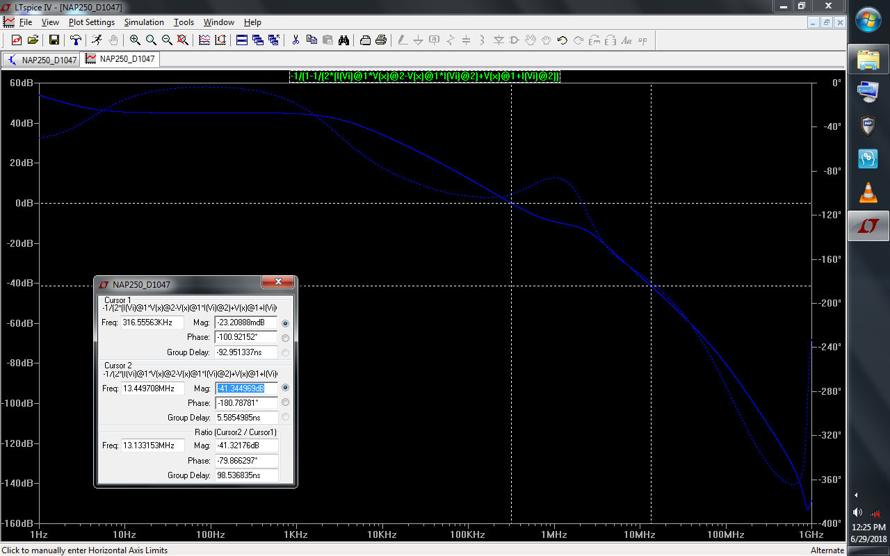

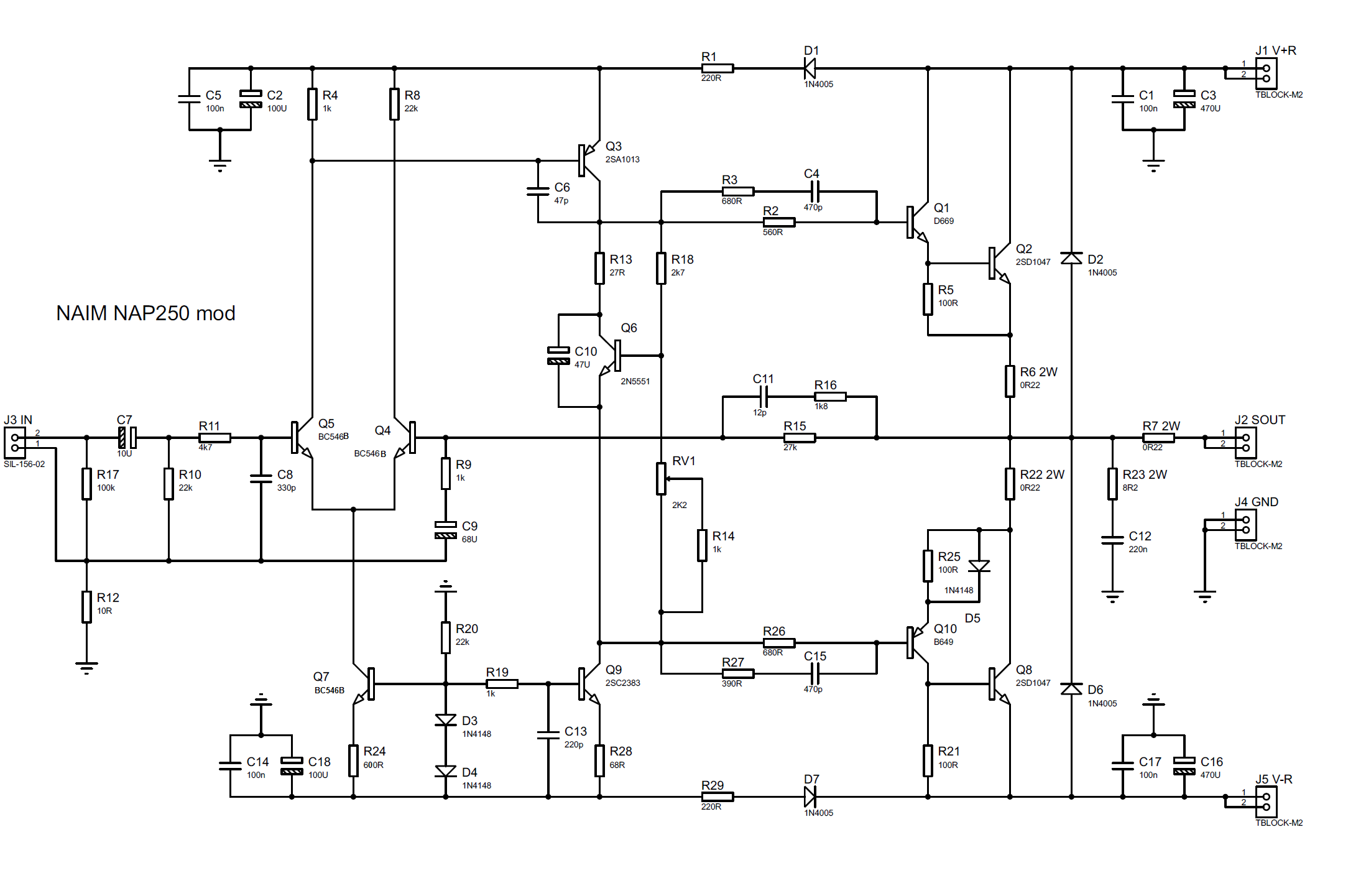

You might find it useful to have a few more values on hand so you can try different values for the Miller cap and check the sound and the bench measurements. Say, 47pF, 68pF and 100pF.
The smaller the value the less current is required from the input stage to charge the Miller cap up and down. This will improve linearity. However, as the Miller cap value decreases the circuit will become increasingly unstable. There is a trade off.
47pf might be good idea. 68 and 100 would be waste of money on nap140 circuits imo...
The need for a small Miller compensation cap in NAP designs is related to the unusually high (30pF) Cob of the VAS transistor(s). If you fit parts that are normally preferred for the duty, such as KSC3503/A1381 (3pF) for VAS transistors, this will certainly require a step up to the typical range of 70-100pF Cdom to restore stability. Unfortunately, that comes at the cost of the characteristic Naim sound quality.
The effect has been discussed here many times and Bigun last described it well enough in reference to his TGM-10 version of the NAP amplifier. I think we will find that by the time the capacitance has reached 50-70 pF, the sound quality will have become noticeably poor.

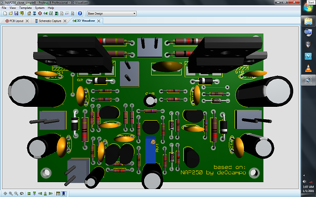

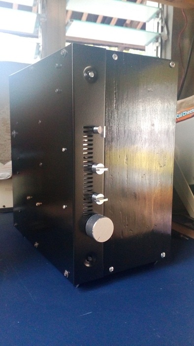

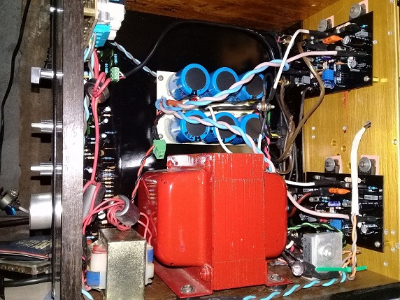

My NAP250 clone build, made from discarded stuff, an attempt of an up-cycle build.
it is a beautiful design work but I do not think you have understood the spirit of this scheme.
for example, ceramic capacitors operate but do not give the same result with polystyrene and tantalum capacitors.

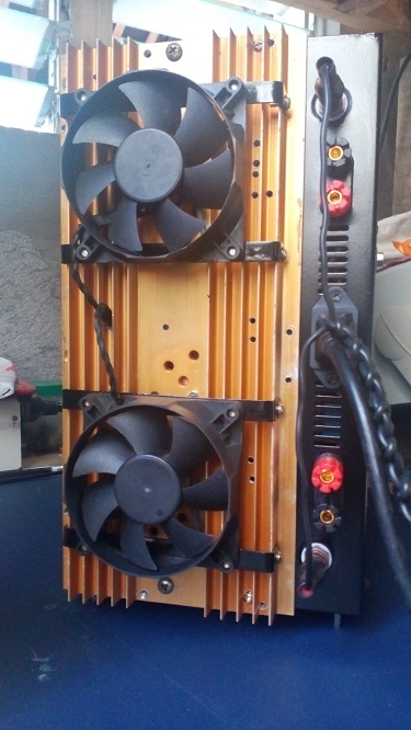

Ditto for the heatsink, unless you chose the overbiassed, it is much too massive and the fans are useless.

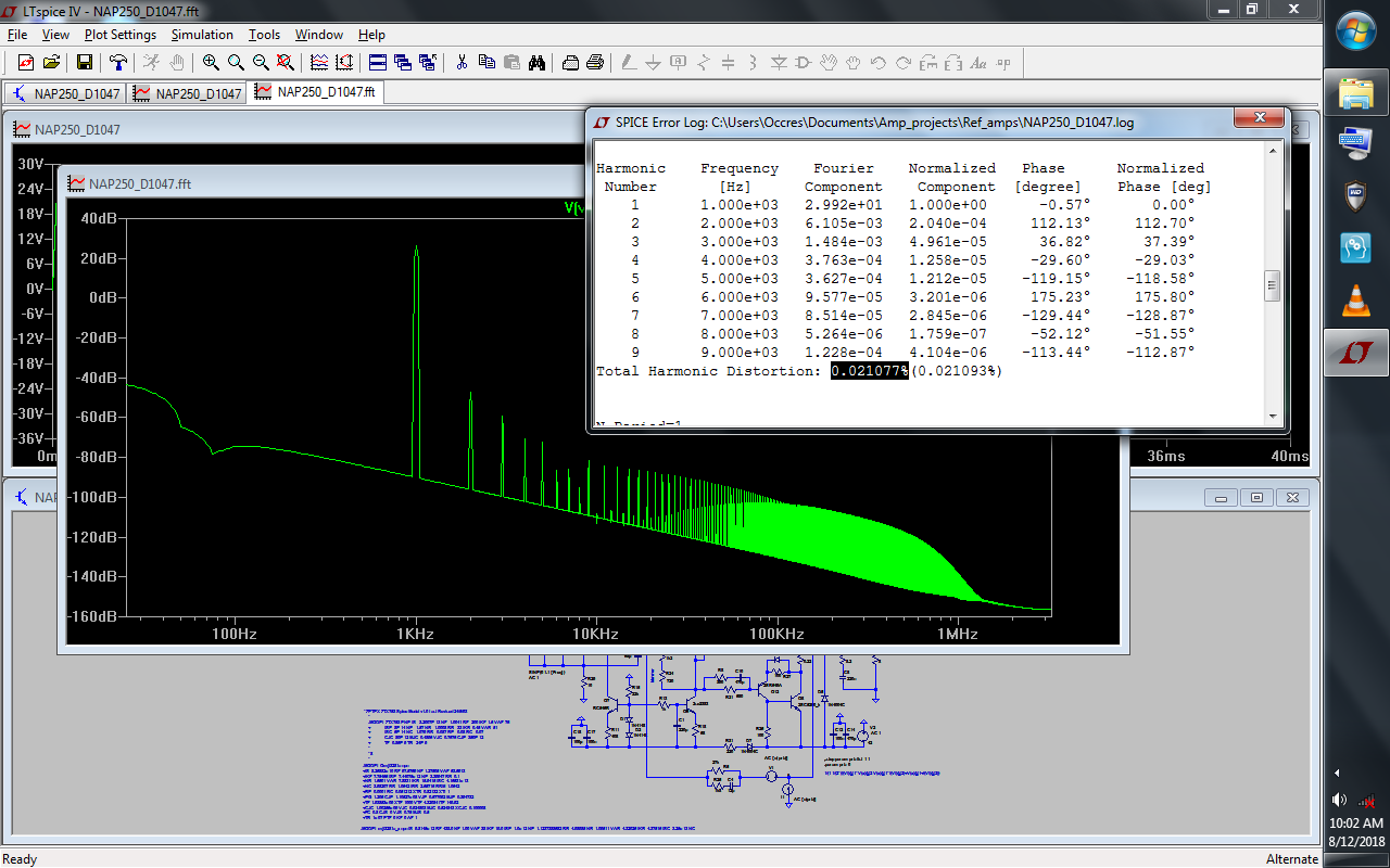

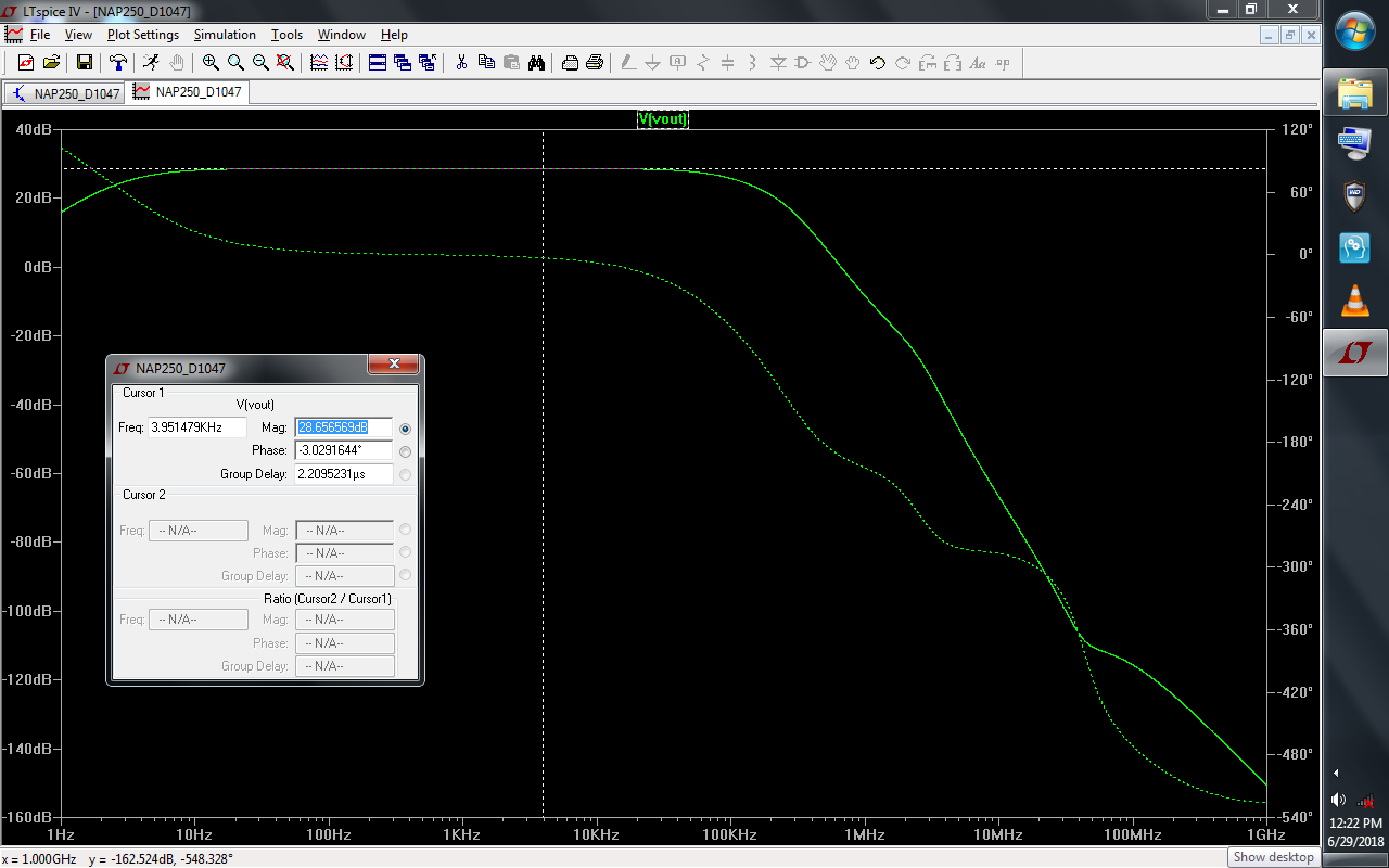

I built the clone with an objective in mind to closely follow the original values per NAIM schematic. (except the now older transistors of course). I did however made a few changes so I could obtain clean results in sim, changes was 47pf for vas miller cap (39pf works fine though), 12pf for the feedback phase network (39pf original) in order to flatten the appearing gain bump at AC analysis. Idle current was set to 25ma (about 6.6mv) and I've read at the pink fish forum that ideal was 7.1mv across re. DC offset was at 2mv. Tantalum caps is quite hard to find here in my place but the input bandpass filter 330pf was a wima mkp and the 470pf at the driver bases are polystyrene caps.
While I have not auditioned a NAIM amp I could not claim that it sounds NAIM like, if you notice however the harmonics profile in sim, the extended harmonics could be the inherent dominant even harmonics character of the NAP amp. The fan seemed to be no longer needed per my actual test (heatsink barely gets warm), the only device that gets hot to the touch are the TO92M vas trannies but it looks though that they could survive for longer hours of playing music. The challenge here is to use substitute transistors without altering much of the original values like what I'm seeing from a lot of clones out there. Over all my schematic was more of a combination of NAIM and the Avondale mod.(?) The pcb is one is single sided like the original but I made it a lot more compacted. VBE multiplier was bent underneath with the flat face touching the heatsink for better thermal tracking, it looks stable never had "drifting" issues.
