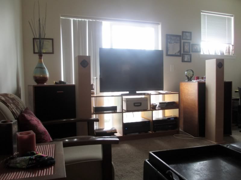

Finally at least got to hear them today! They image like crazy and amazing go really low. When I first heard the drivers I was more than unimpressed; now ... they're rockin! I played everything from Jazz to Rock to Techno through them and of course they didn't have super low punch but they still hit the notes and with surprising authority. I've now moved them to surrounds where they will reside and am about to watch Immortals which should have some good surround effects, we'll see how they do Here are some pics of them RAW and completely unfinished. I wanted to hear them before putting any effort into finishing them so please excuse the poor pics and raw images ...

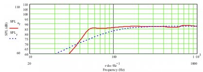

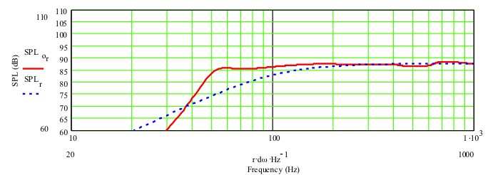

Can you give some information on the towers? type of enclosure, tuning frequency? how big are they (internal volume)?
Did you use any BSC?
How low will they go? do you feel they need subwoofer assistance?

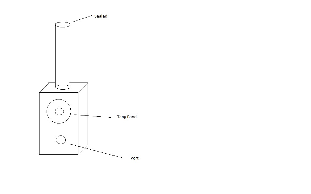

Desktop Enclosure for Tang Band
I have a pair of these Tang Bands and I wanted to build some enclosures to use on a desk as computer speakers. I would like to have as much air space as the Nano towers, or close to it. I have attached a very ugly design, but was looking to get some feedback before I start. This will be my first cabinet construction so any advice is welcome.

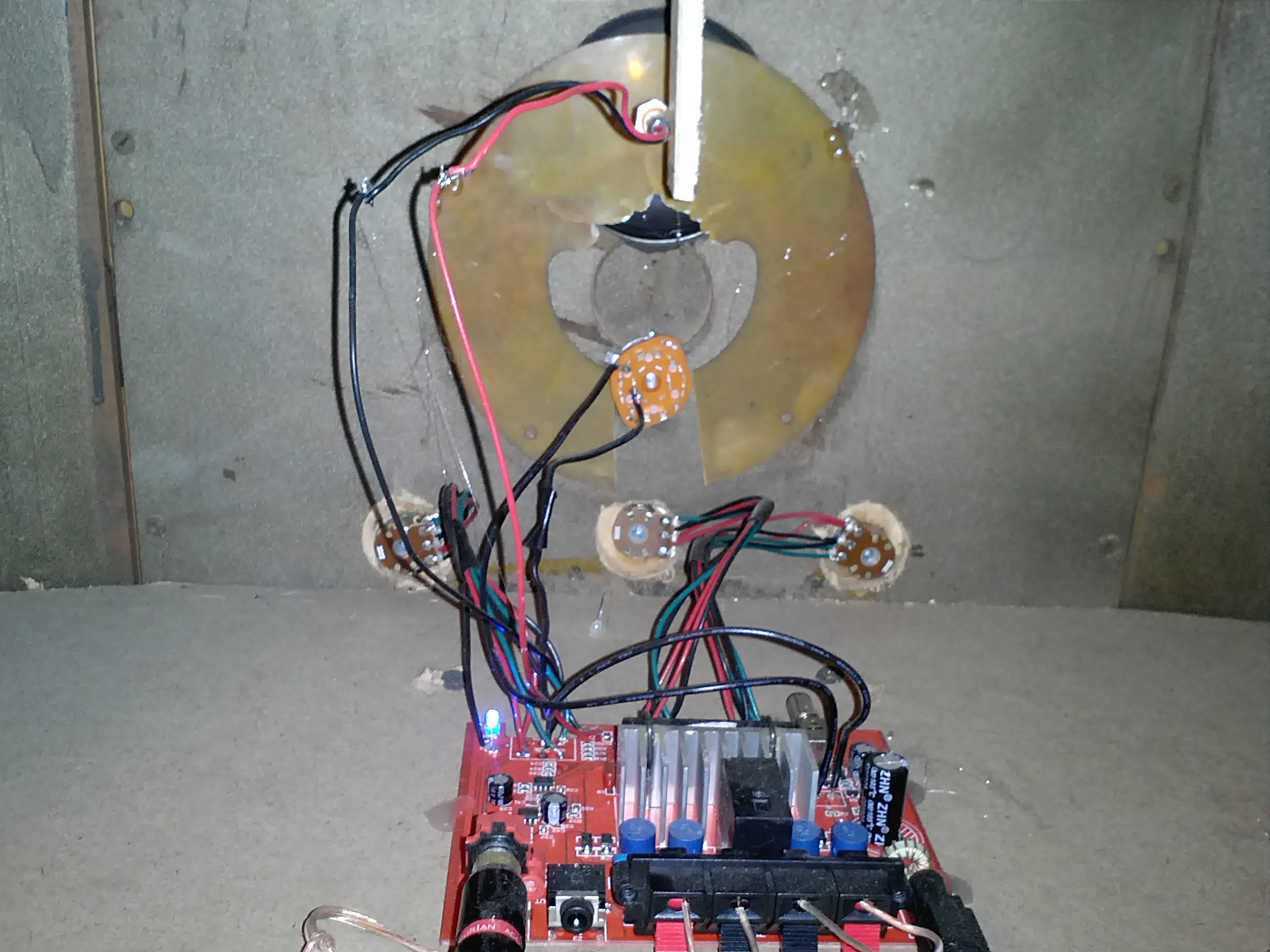

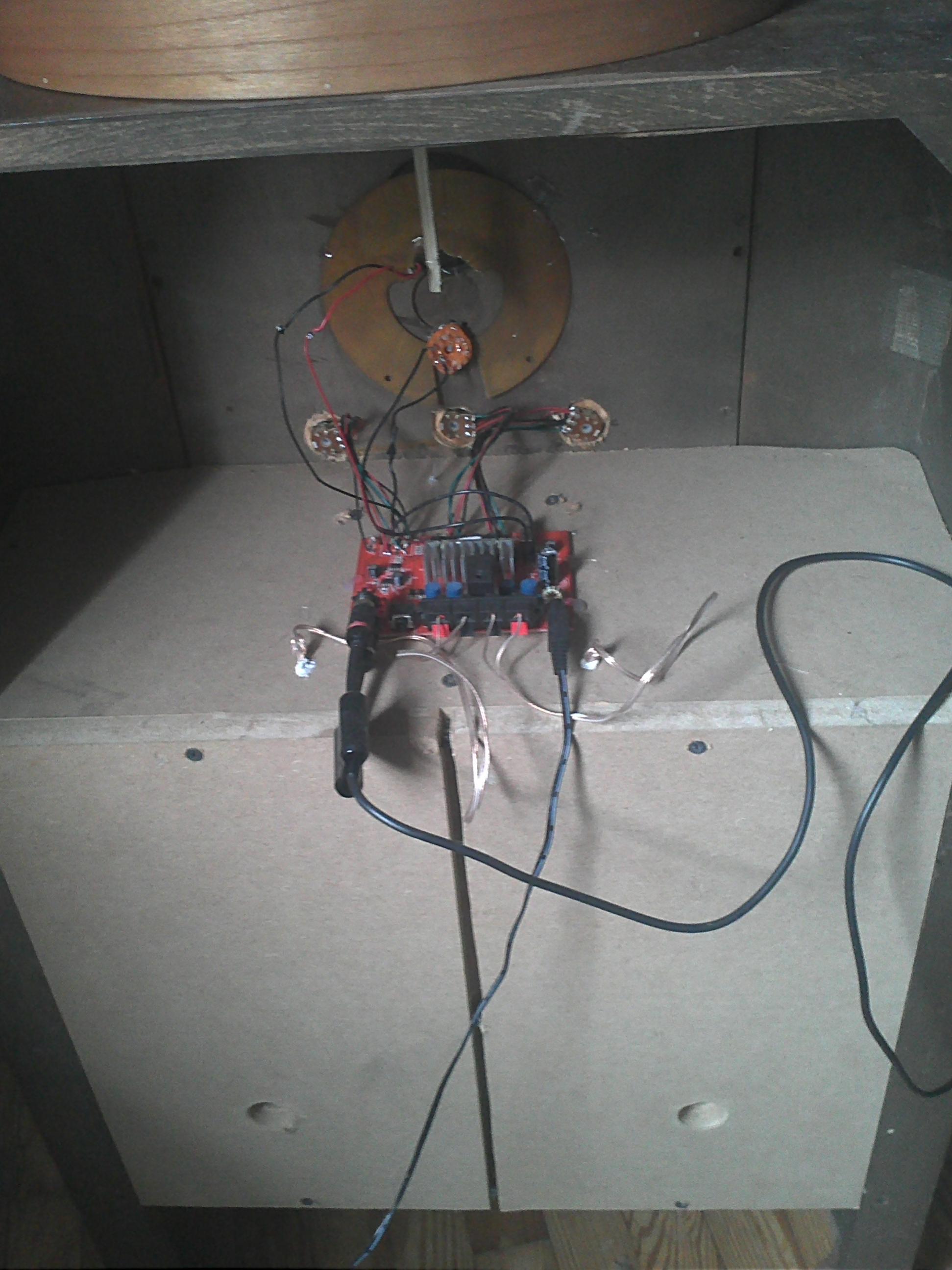

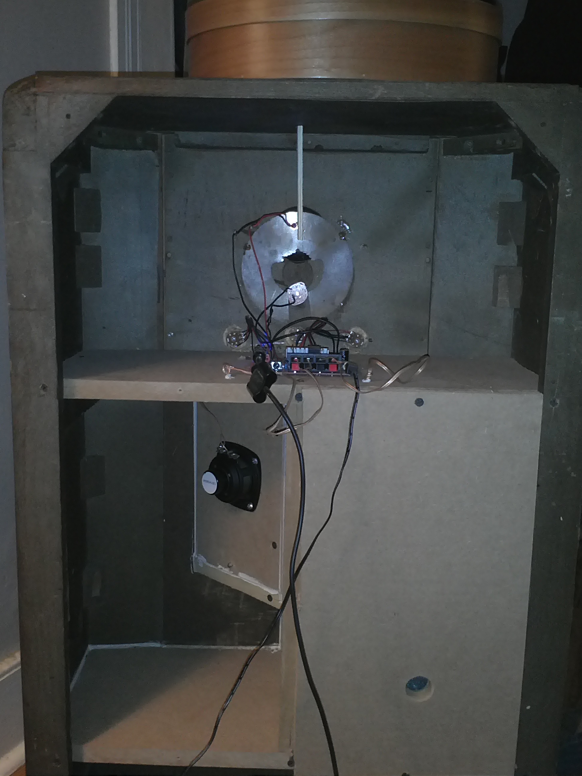

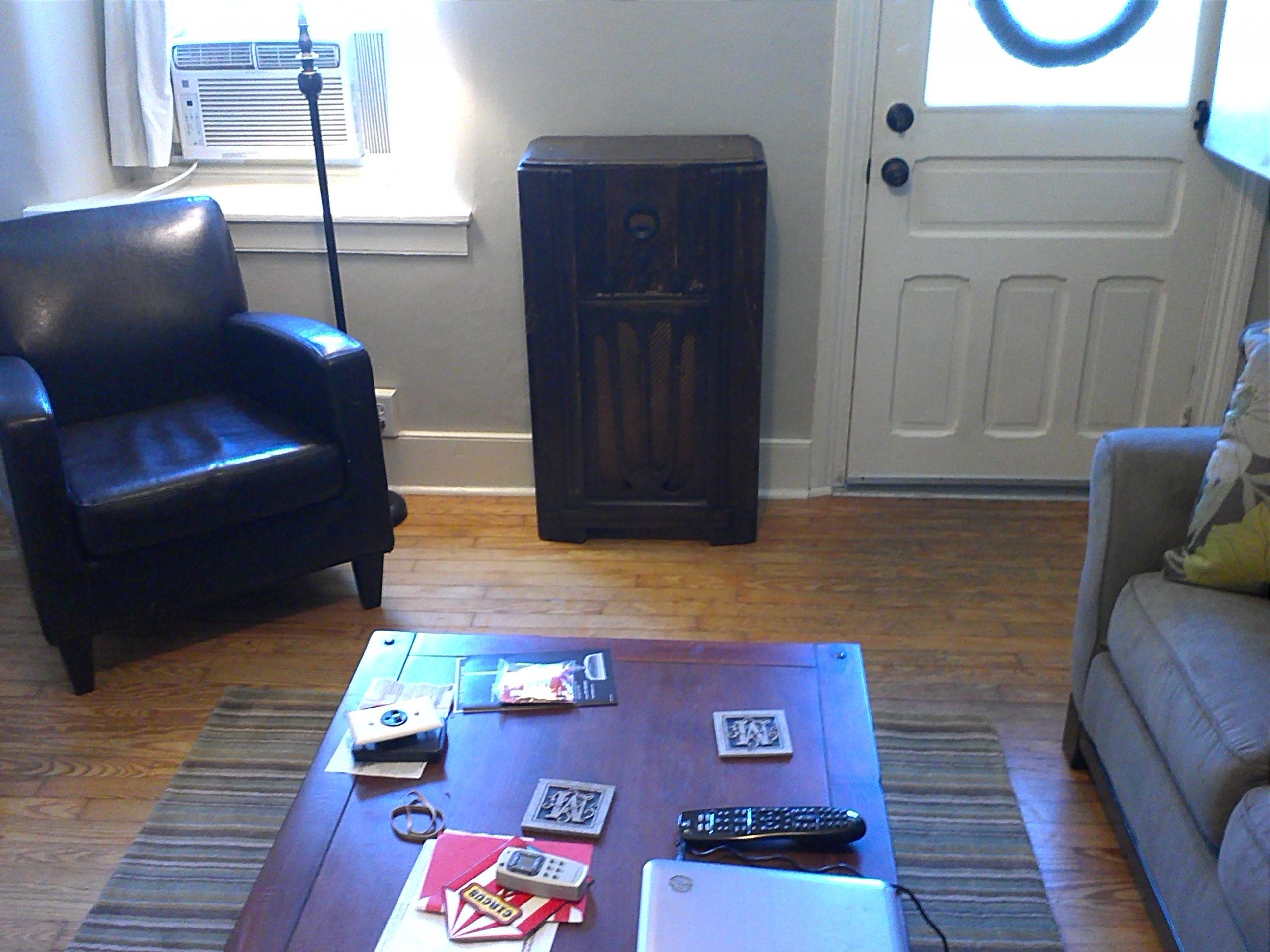

Hello all. I've read this thread several times, but I've never posted. I was inspired by the design at the beginning of the thread, and I wanted to share my experience with it. I modified the original design to fit in an old floor model Philco that I found in an antiques store. The tube amp was beyond repair, so I gutted the interior and built a couple boxes of the same volume of the original poster's nano towers. I filled the boxes with poly-fil, and modified a lepai ta2020 to fit the original control panel (basically I just extended all of the controls about 6" from the unit). The unit sounds great, and people are always interested to see how I am able to play my iPad through a 1937 radio.
Thanks to the original poster for the design!
