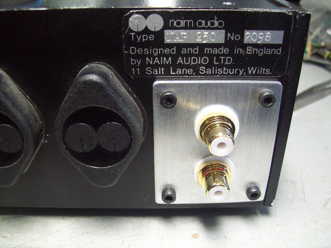

i am still working on the naim 250 that came in the shop today and will post details of my work and findings till monday ...
From a first look is a terrible machine and sorry to say it has things that i dont like ...
obviously poor choise of LTp and also eventhough thermal coupling was very very possible to do the never did .....Beyond sound improvement from matched LTP thermal coupling will also provide extra stability ...
I am just started so give it a bit of time and see how it goes

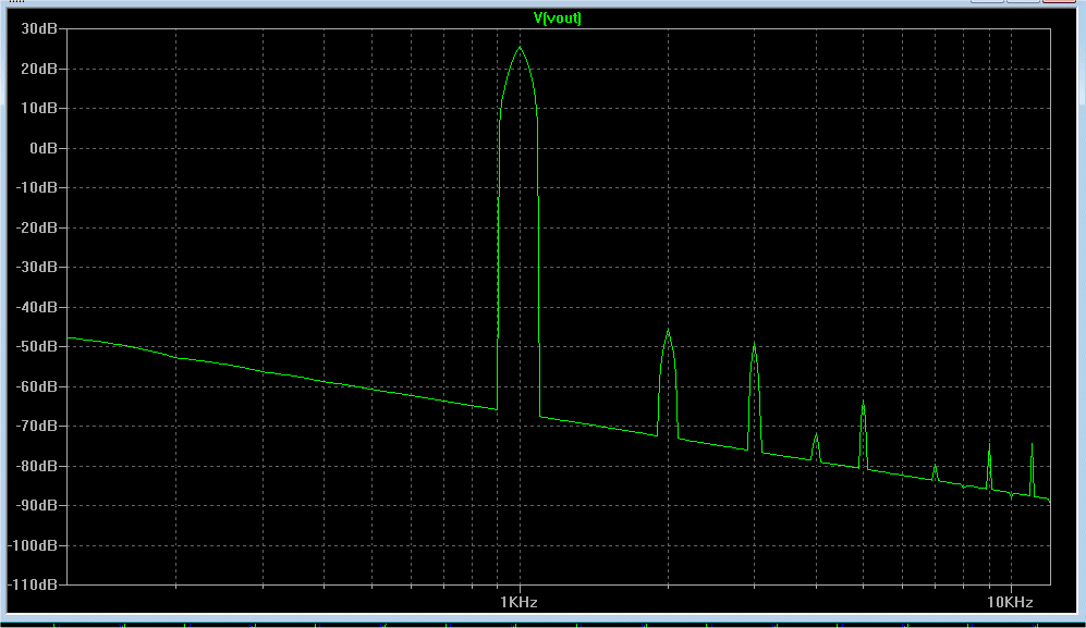

LT says
-22V/us slew
-.08 -.1% 40vp-p THD20
-.03% 40v p-p 1k
-Only conditionally stable....
2sa1381 is 7pf vs 20pf (zetex) 100hfe , just about the same
2sc1845 is essentially the same as the BC239's 200Hfe 100mhz ft.
I would say whatever "unique sound" this has is the result of being designed wrong (intentional) , brought to the edge of instability, or over it. (hence the special wiring arrangements).
These flaws(or enhancements) do nothing for making the amp faster (it isn't)
It does oscillate with my slightly faster models .... 33r VAS degen. makes it work for the tests.

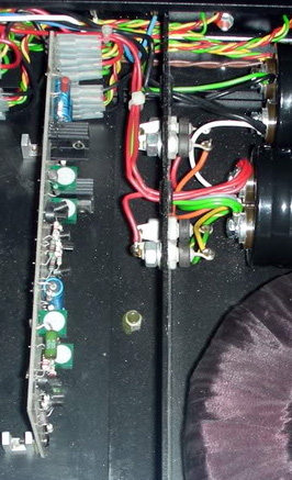

Did you change main PSU capacitors yet? Has it ever been refreshed for those? Also the MR2002 can be still fit or not, depends on what kind of use it had seen for on/off cycles.
Thanks for the interest Salas .... sorry to say i am not there yet as said only
----the ltp is replaced
----better cap in the input
---- VI limiter removal
---- bit of decoupling and bypass
---- multiturns for the idle
---- and first picture of ofset and idle
As we speak i will dare to play on the risky side and with danger to degrade and compromize the sonic signature ,and the long grown and refined sonic balance i did this ....
