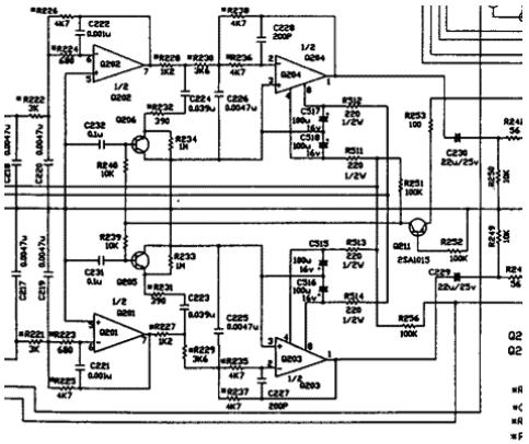

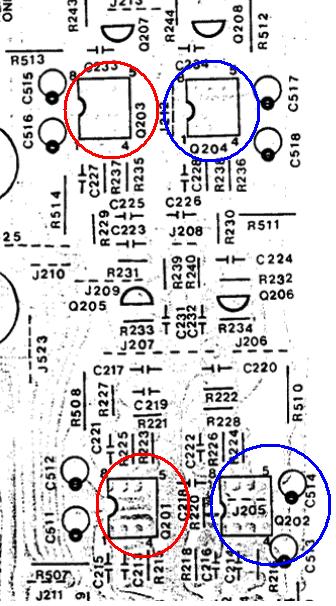

I've been wondering, with regard to the NAD audio output section, if I could delete that last pair of opamps [Q203 & Q204] and take my output from Q201 & Q202. I've got plenty of gain from a Burson Buffer and my pre-amp so in a way, less gain would be good.
If this is simple ... great, if it raises all manner of tricky issues, then I'll keep things as they are in terms of the opamps.
parrot
parrot said:
[B...I've been wondering, with regard to the NAD audio output section, if I could delete that last pair of opamps [Q203 & Q204] and take my output from Q201 & Q202. I've got plenty of gain from a Burson Buffer and my pre-amp so in a way, less gain would be good.
parrot [/B]

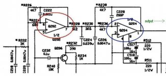

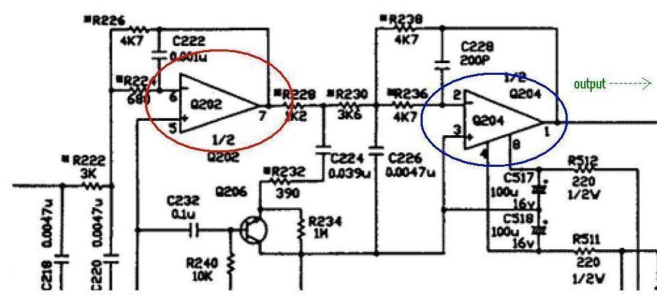

Q203 and Q204 are low pass active filters which remove high frequency digital-to-analog conversion artefacts from the signal. It is possible to avoid the filter, but the following preamp and power amp may not like the added "noise". Its worth a try though....
R227-234, Q205-206, C223-224 form the de-emphasis circuit. It's turned on and off by switching the the junction of R239/240 between +V and 0V.
If you take the output signal from either end of R227/228 any CDs that were recorded with emphasis ON will not have the correct equalisation, and they'll sound like s**t.

In a word "No" ;) Q203/4 and components form a low pass filter that is needed to "reconstruct" the audio and to remove HF noise from the DAC's. Do you have an oscilloscope by the way ? There's a bit more as well, Q205/6 are for discs recorded with pre emphasis. They switch C224 & R232 into circuit to alter the filter response. That said very few ( I believe) discs now use this, it was mainly Japanese discs in the early days that did, that said I do have a few in my collection that use it.

From what you've said, meddling with the Q203/Q204 opamps doesn't sound likely to lead anywhere particularly useful. The de-emphasis circuit looks as though it might not be useful, most of the time but it seems there might be the odd occasion when it is, so for now I don't think I'll fiddle with it.
Do the different roles of Q202/Q201 and Q203/Q204 have implications for the types of opamp to try in these positions? Is it worth experimenting with both sets or could I be better off just to fit say OPA 2604s in one set of positions and experiment more with the other, if that makes sense?

I think you really have to try it and see. The OPA2604 is a FET OpaAmp, the NE 5532 were a more conventional "no fet" type. You need to keep it all "as is " really, particularly without a scope to see the effect of any changes. You can freely swap the OpAmps, trying diferent ones in each posistion.
