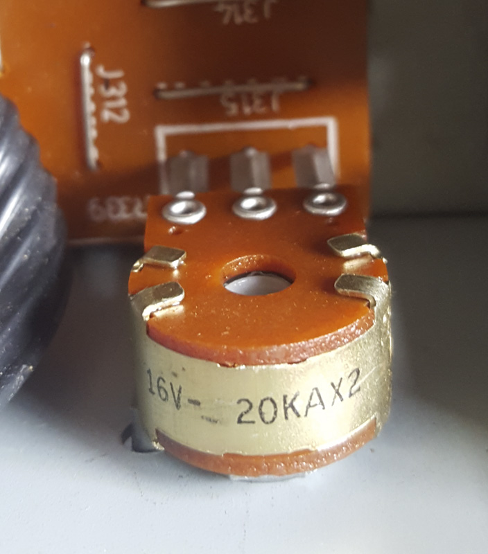

Thought the volume pot might get better with use but it's not so it's time to replace.
The schematic suggests that there should be a 50k pot but it's a 20k that's fitted. A quick search for 20KAX2 brings up some Alps pots but none that look the same.

Are you sure the ones you will replace with have Audio tapering rather than linear tapering? Sometimes a pot is not a pot....
I'm never sure of anything! That's why I rely on you knowledgable types on forums such as this

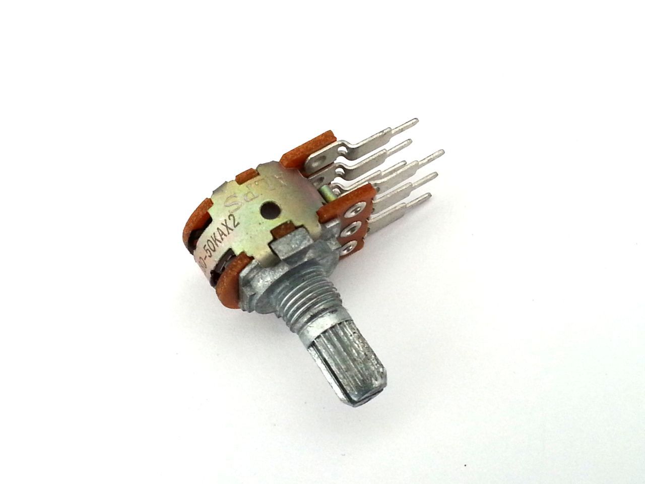

Here's a 50k pot with centre detent - I guess that's just a physical bump and wont actually do anything?
2x ALPS Potentiometer 50k log Dual Pot Japan - 50KAX2 - Centre Detent - NOS | eBay
That is probably a balance control and the log tracks will run in opposition to each other, so no good I'm afraid.
Would anything like this fit ?
POT, DUAL GANG, LOG, 22K - OMEG | CPC
Just a note for others. The volume pot on the earlier 3020 models have a tap on the volume pot connected to the loudness control, and it's not a centre tap. The chances of finding a replacement are roughly zero, except robbing another amp, so a standard pot would leave the amp with no loudness control. No big deal really. It is best to try and clean the original if possible. Thankfully NAD gave up on the loudness switch with the 3020i.
