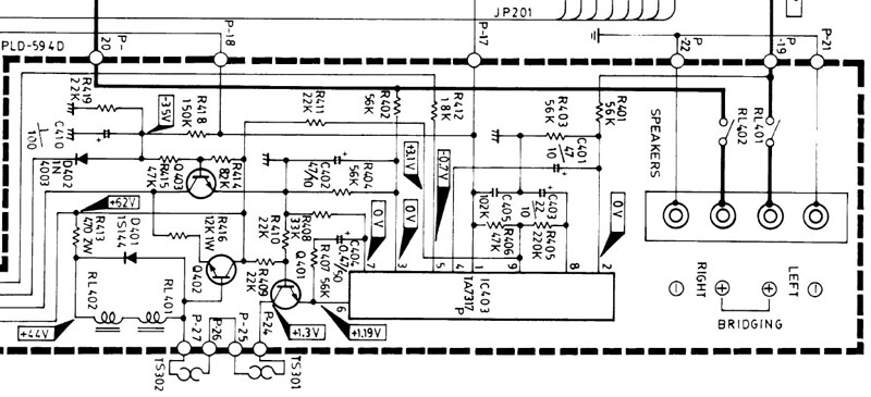

I followed guygo's recommendation and replaced the relays on my 2200 with IMO units. Works great. Here's a video detailing the process...
NAD 2200 Protection Relay Repair - YouTube
Relatively easy fix. Most difficult part is drilling the PCB to support the IMO relays but it's really no big deal if you're careful. I had one pad lift during desoldering but that's because my vacuum pump is on its last legs and I had a problem getting a good seal.
The punch-through effect as well as some high frequency attenuation in the problem channel is gone. Amp sounds brand new again!

Anyway. - NAD 2700 is sitting on the kitchen table and playing - for what I guess will be happily ever after. The new relays measures 400 Ohm across the coil vs. 500 Ohms on the PXSs. 20% up in power drain, but fingers crossed it won't be a problem long term. They engage with a nice solid click, so it looks like all is well in the world again.
You have to cut one pin on the new relays, then they're a straight drop in - see picture.
Again - thanks for all the pointers to helping sort this.
The IMOs also have a lower coil resistance, 362R versus about 515R, so changing the resistor was probably unnecessary. I just did one without changing it and it works perfectly.The IMOs take a bit more current to solidly toggle so I replaced R413 with a 240 ohm, 2 watt carbon comp resistor. Each relay now has a solid 22VDC across their coils, it is all working marvellously, and they make a very nice "click" when they energize.
These are definitely an excellent choice for replacement relays in this amp. Thanks for the clue, swinnea.
Having said that, if I had it to do over again I would definitely just clean the contacts in the existing relay. They are very easy to get at.

Installed them into a 2200 but i pins where slighty off and i drilled all the holes a bit bigger and it went in quite smooth.
Nice click but amp takes a bit longer to energize the relays so delay is now maybe 4-5sec. I also changed caps around this area so can be that too. This area and the 470R /2w is going hot!

for the NAD 2200 - use the IMO relay
https://www.newark.com/imo-precisio...dc/relay-automotive-spdt-14vdc-45a/dp/74R1551
for the NAD 2155/NAD 3155- use the OMRON described here:
NAD 3155 Relay replacement | Audiokarma Home Audio Stereo Discussion Forums
I have used both solutions multiple times with excellent results

I put this job off for too long so finally ordered the IMO relays from Newark and installed them into my 2600A today. If you have one of these amps with the original relays don't hesitate, replace them. I had cleaned mine several times and the issue always came back and it's as much work to clean as it is to replace. I left the original resistor and the relays activate nicely with a nice solid click. I had a 330 ohm ready but after testing with the original 470 I didn't bother. It works great and has actually improved things. It used to be a bit weak on the left channel, that is now better.
