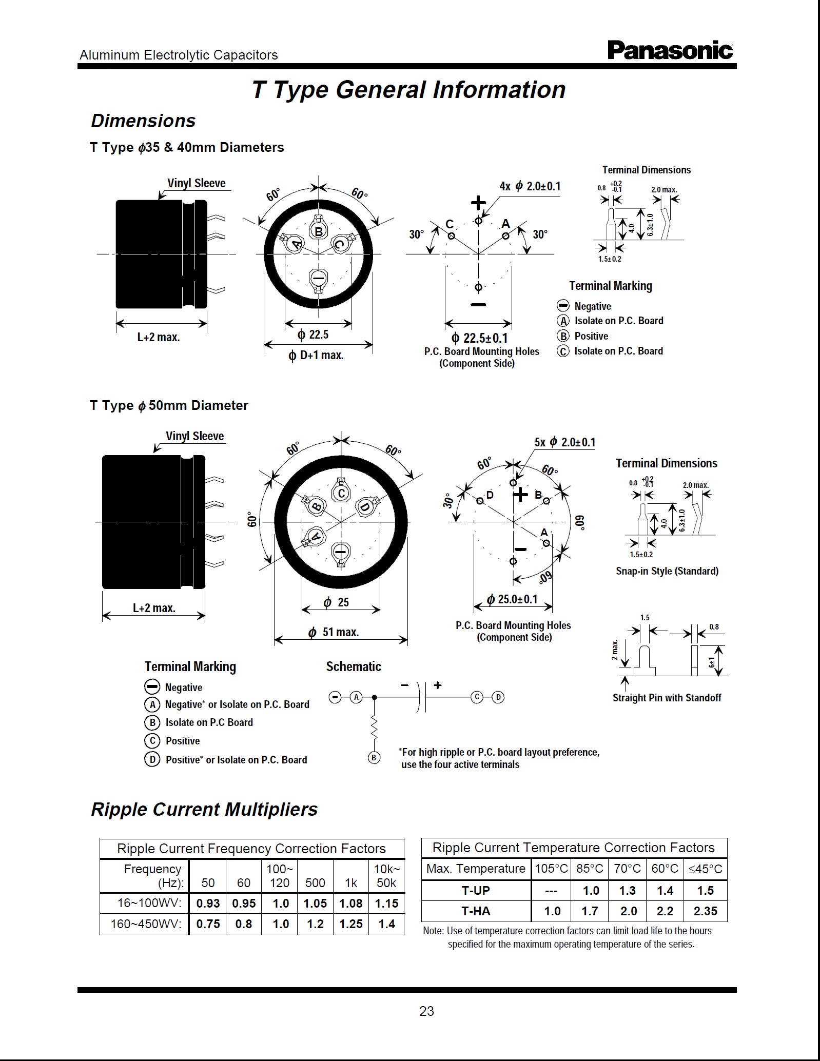

I just measured an unused Panasonic cap, and I noticed that there is a potential between the NC pins and the negative pin. There's also a slight amount of capacitance between all of the pins. So, the possibility of a connection problem exists.

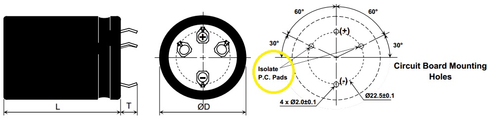

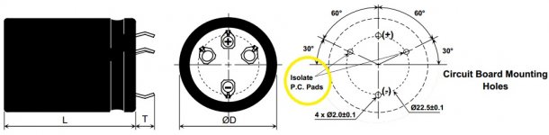

In furthering my research, I see that the United Chemicon datasheet states:
"Use the blank terminals for mechanical support only. The blank terminals must not be connected to a solder trace on the PC board, but be electrically isolated from the negative or positive terminal."
This agrees with Panasonic, but doesn't explain why I'm seeing the issue on one cap and not the other.
However, when I found the EPCOS datasheet for 4-pin capacitors, it states:
"All pin holes must be drilled into the PC-board, since the unconnected pins serve as mountings. These pins must be soldered to isolated pads or pads with the same potential as the negative pole (solder pin and 4-pin snap-in terminals)."

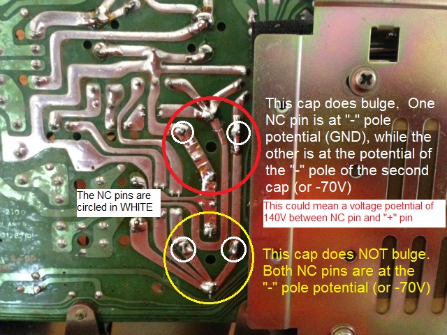

Well, check out this photo of the NAD design. I used a red circle to highlight the location of the "bulging" capacitor and a yellow circle to highlight the location of the "good" capacitor:
Lo-and-behold there's a possible reason for one cap bulging and not the other. The "bulging" offender has one NC pin connected to its own negative pole, while the other NC pin is connected to the negative pole of the second capacitor. I.e., there's a chance for 140V of potential across that cap. This may explain why it bulges slowly....
The second cap (the one that doesn't bulge) has both NC pins connected to the same cap's negative pole - which is what the EPCOS datasheet recommends.

Continuing my research:
Cornell Dubilier Electronics has this to say about the NC pins:
" Use dummy terminals for mechanical support only. Make no electrical connection because they resistively connect through the electrolyte to the negative terminal."
Vishay says:
"Pin numbers 2, 3 and 4 (if present) should be free from the electrical circuit or connected to the minus terminal."
So yes - I'm going on a limb and guessing that this is my issue. Specifically since the electrolyte restively connects the NC terminals to the negative terminal, this could be a big issue for anyone with a NAD 2100 design that's replaced these caps. I'll change out the cap again (minus the NC pins connected) and let it run for a few days to see if the issue disappears!
