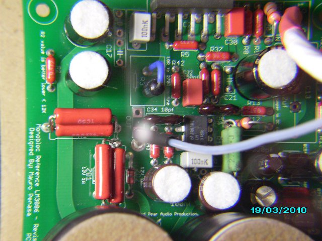

The problem with using a large, high-quality resistor such as Mills at R3 is fitting it on the board.
See the attachment, to me it fits better than the Caddock with his heatsink...
He used a 5W Mills.
