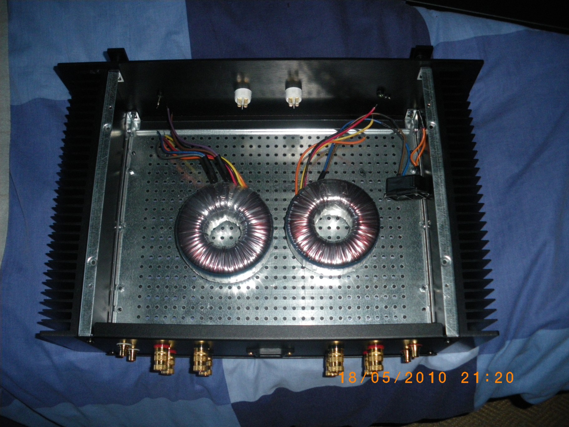

How will you not have hum if you have speaker outputs running so close to the toroidal? Making turns or partial turns around it will induce 60Hz voltage into the output. The more the turns, the mores the voltage you have.
Like some said before, when you tidy all up induced noise will be reduced (as long as you do wiring in a proper way).

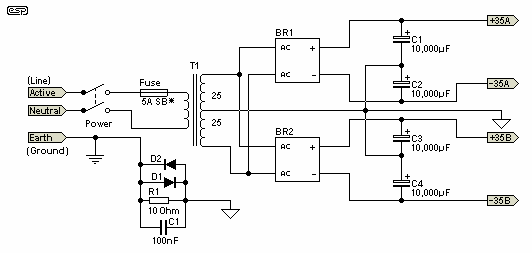

As a polling purpose for all builders: Are you going to tie GND from the amp to Protective Earth, as all regulation agencies and safety certifications oblige? That is NOT an optional decision when you talk about final prototypes.

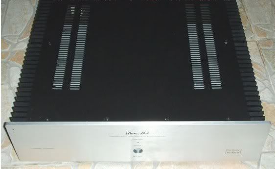

I got a chassis from the guy who makes the lampucera DACs on ebay about one year ago. Total cost shipped was around $100 (I think). This included IEC Plug, Fuse holder, RCA Jacks and Banana Jacks. I have emailed him to see if he has any more of the chassis and the price.
This is my build with a lm3886 from chipamp.com:

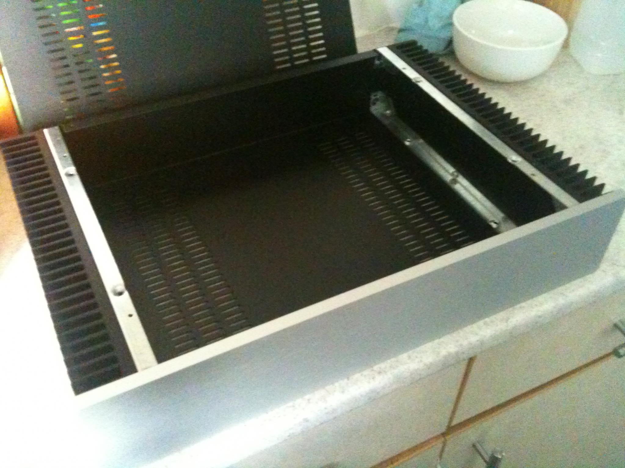

This is a photo the seller uses on ebay. I think this photo is taller than my chassis, but the general look is the same. I think mine is acually a POA-200:

Hey, if you are going to presume of high end enclosures, I cannot keep quiet

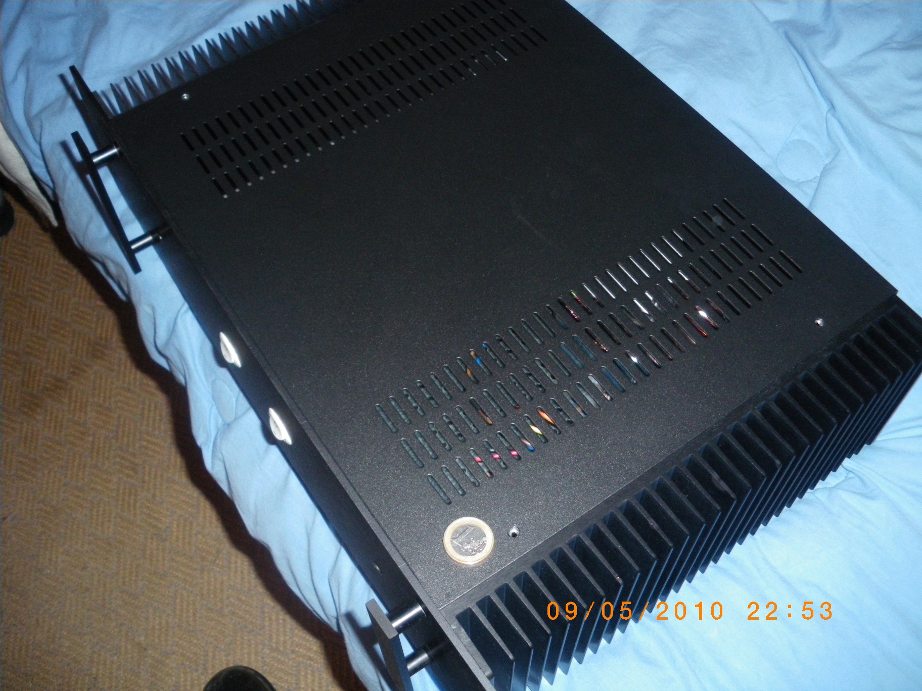

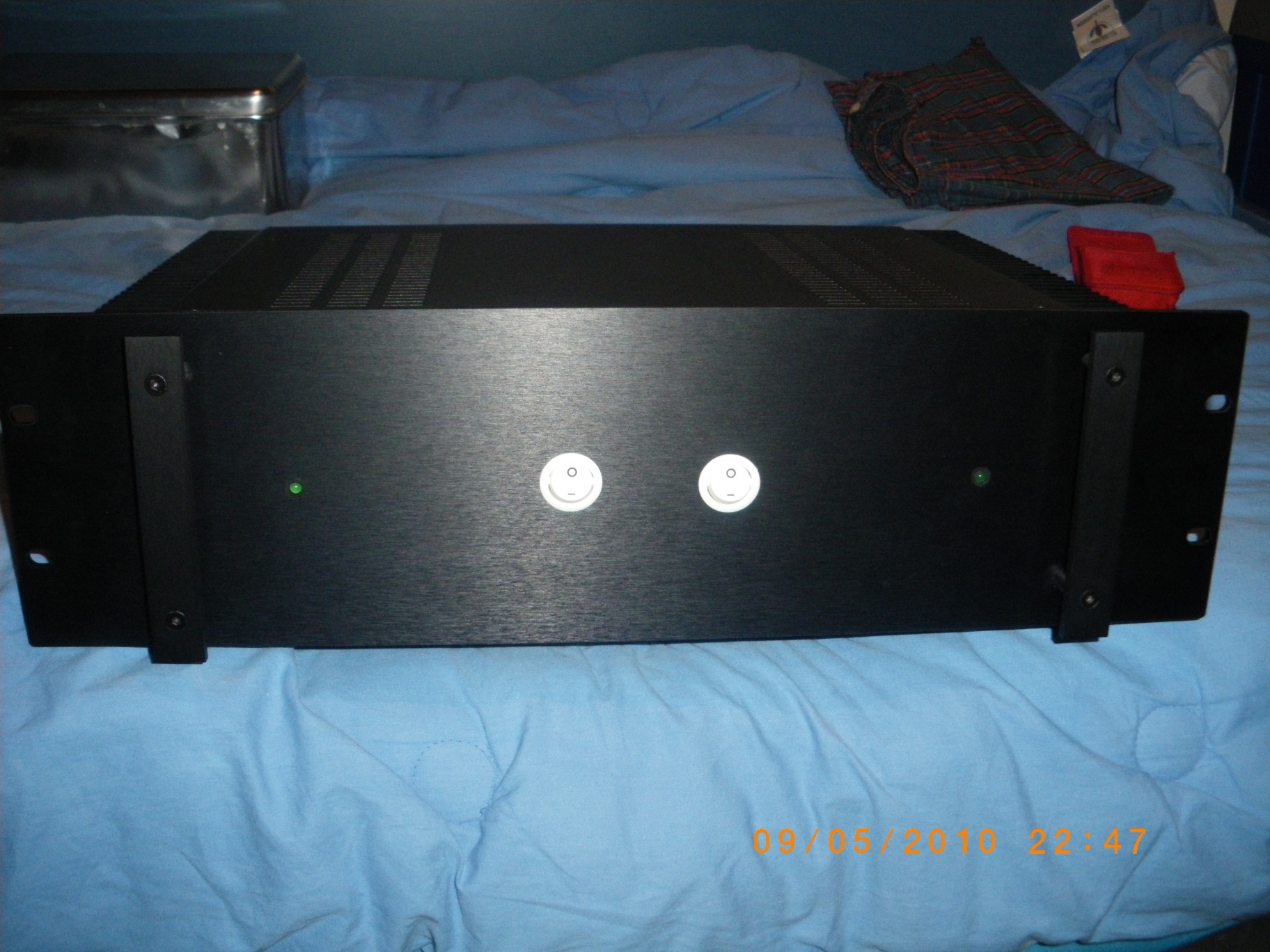

Shark, I really love the 2U case you have from modushop. I went for a similar one, but it is 3U tall and I preferred the rack-mount front panel. It gives it a more professional look IMHO, some kind of industrial look like the ones that you can see at concerts and workplaces. Your's is more refined, but without loosing a bit of solidness.

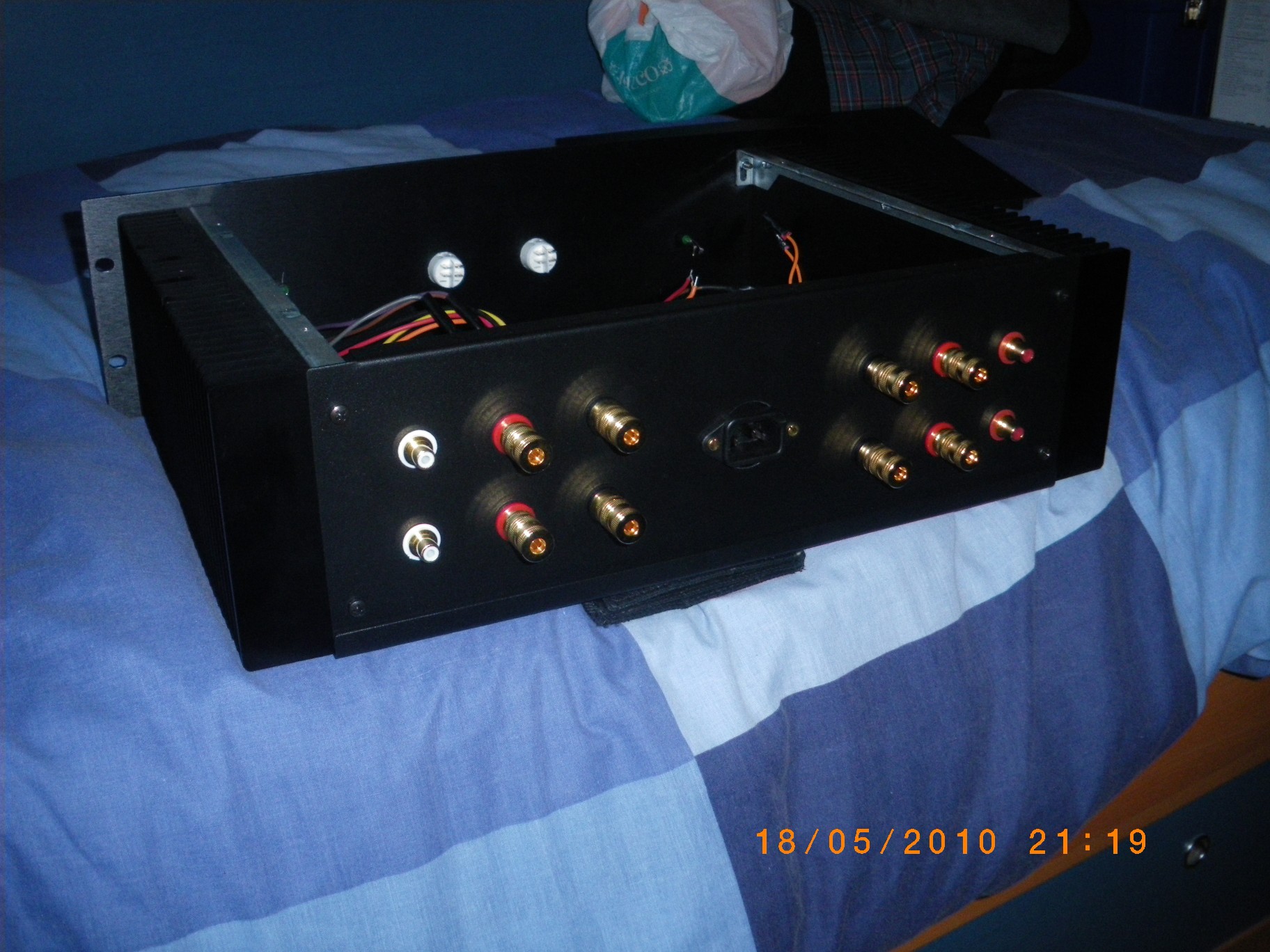

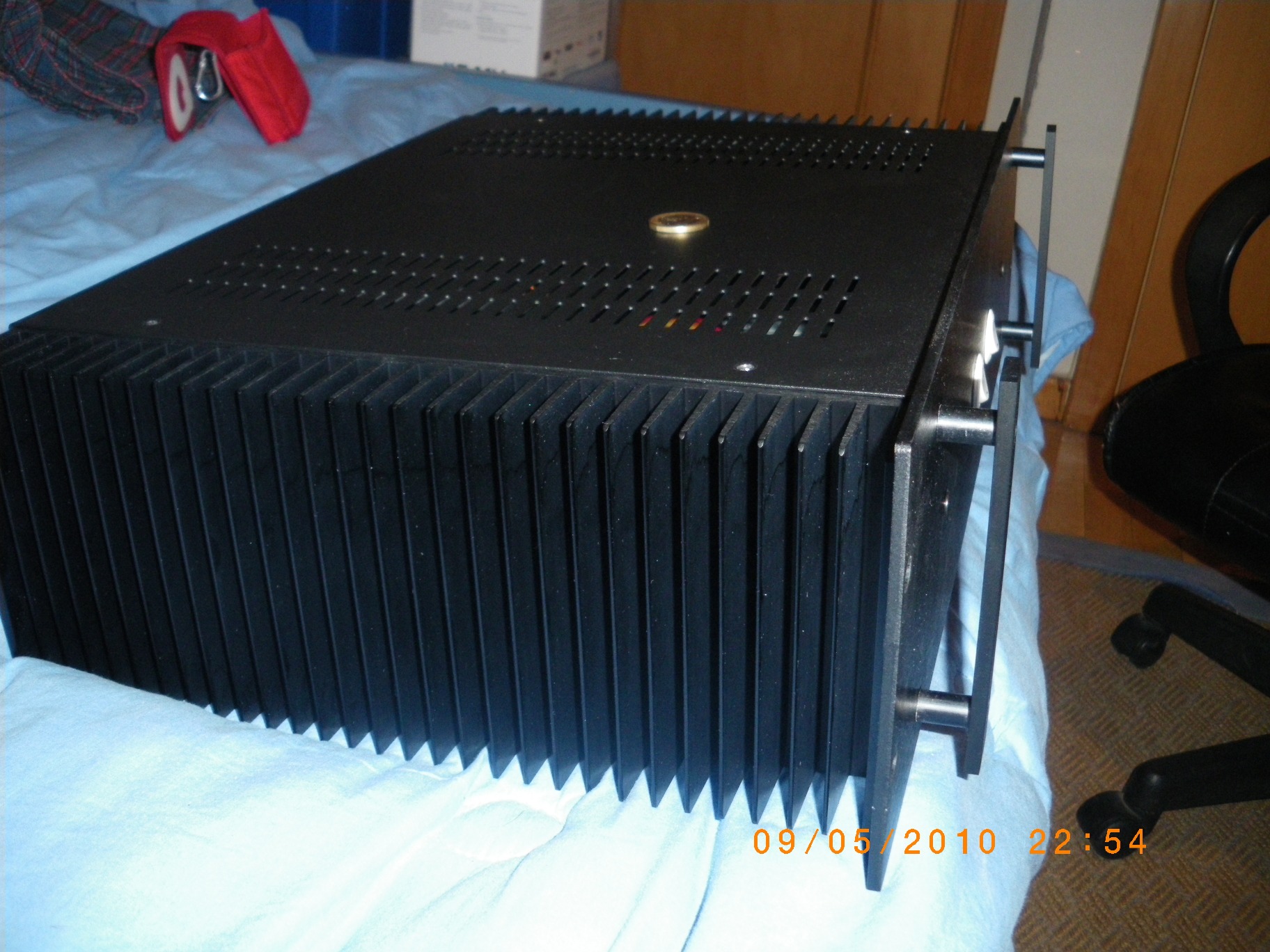

Here is my anxious-waiting enclosure. It really NEEDS to be filled now
Regi,
The safety grounding issue has been discussed before. It has been stated that the amp ground does not need to be connected to earth ground, for safety or for any other reason. That is where a lot of trouble with hum enters the picture.
If the incoming mains safety ground is connected to a ground lug SECURELY fastened to the metal enclosure, it should make this amp safe. And that is the ONLY conductive element that should be touching any part of a metal enclosure. If there are hum issues, it is usually caused by accidentally grounding some other point in the signal path, or by routing wires incorrectly or dressing them poorly, or from some other point upstream of the amp, such as a volume control or switch not insulated from the enclosure.

That will give yours a nice and practical touch.Very nice regiregi22,You are spot-on it is a 2U case from modushop.biz very nice cases ,I went for the milled handles not fitted yet....
What I love most of mine are the holes in both ends to place it in a rack Only thing I need now is a rack

Oh dont get so worried about my wiring and case. It shouldnt be perfect right now anyway. I have yet to finish messing with it.
The hum was what you thought Tom. Signal wire was on top of power supply caps on other channel. As soon as I touched it the hum stopped.
As for the Sonance I just removed the guts and drilled a few holes.

Hi Regi & Madison,
The chassis must be permanently connected to the Safety Earth. No choice.
All exposed conductive parts must be connected to Safety Earth.

We are not competent to design and build and test and guarantee the safety of ClassII devices. We must build Safety Earthed devices. No choice.
Do not bother with a poll on unsafe practice. I will talk to the Moderators with the purpose of shutting it down.

Before anyone gets their panties in a bundle...
Generally accepted definitions.
There is no such thing as "amp" ground.
There is:
Earth ground = which is the zero (0) volt reference the power company makes at the breaker box.
Chassis ground = which SHOULD be tied to Earth ground using a three conductor power cord. (edit: Always an exception such as 2 conductor pwr cables that generally go to source components and TV's.)
Signal ground = which is a reference point for the audio signal AND DOES NOT need to be at the same potential or in contact with chassis ground.

Thank you Andrew T... your vigilance is helping keep us DIY folks alive and kicking to the beat.
Here in Japan a standard AC 100V 50/60 Hz (by region) domestic supply socket does not even have a polarised plug/socket. Washing machines, dishwashers, air conditiners... anything mixing water with AC volts local code requires an earth, so I have managed to tap a reliable earth supply for my bench and listening zone. Therefore I can pin down the live and neutral by referance to earth... Otherwise, especially with common gang socket extensions, you have no idea which pin is live...
Personally I would rather have some hum problems to isolate than be 'noise free' by virtue of not being alive anymore.
Thus I religiously switch and fuse both AC lines rather than relying on one side being live.
Regi once recommended a very thorough grounding solution for all non-chassis grounds, can you remind us all please Regi?
