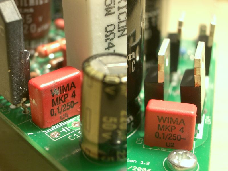

Ouch!, it seems that some parts don't fit well...
the two MKS4 seems 10mm lead spacing and not the MKP4 7,5mm lead spacing I've specified (perfect fit, see attachment).

The two WIMA are an odd fit but do fit with bending one lead a bit. I used the part number specified by either you or Tom on those but its no big deal as they dont get in the way.

The Mouser code 505-MKP4.1/250/10 is correct, I've ordered it two times and you can see the actual ordered parts in the photo of my previous post...

It seems the only difference is lead length but nevertheless, they work.
Sure they do.
A little bending here, a little squeeze there...
That Obbligato is enormous, at least twice the size of any other cap I tried there. If leads do not have insulation, wrap them with teflon plumber's tape. Enclosure will now need to be a bit bigger. Those PS caps also look pretty tall!
The Blackgate looks good under the board, but now the standoffs will be longer.
I don't know why so many PRP's don't fit. They look kind of big. Did you get 1/2 watt instead of 1/4 watt? No harm, other than size, I guess. All of mine except one or two (R14 or R23-- can't remember which, maybe both) fit in the space with room to spare, no oddly bent leads. It would probably cause little sonic effect to use other, smaller size resistors in those spots. In signal path, PRP's are really nice.
I could not find the WIMA caps with 7.5mm lead spacing either. Using 10mm caused only minor difficulty. 7.5mm is a totally weird size.
