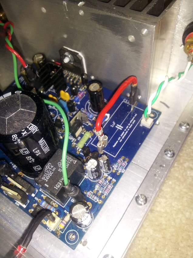

It can be easily checked doing the same tests I did, all it's needed is:
  • TCs
  • copper wire
  • faston tabs and receptacles
I would love too to have feedback about it from someone who compared TCs Vs DC coupling.
Hey D, I'll do the test when I get the build with the TCs back. Looks like it will be near the end of this month. I'm using the betas with Audyn Plus for now. Might try it there if I know it's safe. I'm feeding the FEs direct from the Subbu DAC. Just insure there is no DC on the DAC output and jumper the cap position on the board - correct?
It's safe to DC couple when you have 0V DC (until 5 mV it's still good) at source/preamp output.
You will need to mount faston tabs on C13 pads and faston receptacles on wire and caps.
In that way you can replace the cap with wire, fast and easy.
Faston tabs: Mouser 534-1267
Faston receptacle: Mouser 571-60197-1
Well, I was successful in not blowing anything up, but it will take more time to understand what I am hearing, Using my own test mix track (same as used in both beta and RC build process) I can hear differences compared to the DC couple. If DCC is to be considered "pure", the Plus caps do impose a slight veil. First impression is the upper mids near the crossover to the tweeter is most significantly effected. The very top (cymbals/fret noise) may hold more color with DCC, but that might be a trad-off against a bit wider and more (seemingly) transparent presentation the Pluses prresent.
Bottom line - this will take more serious and long term listening than I anticipated. I still have the Mundorf ZNs and will buy some Mundorf Supremes later this week. When Uriah returns the amp with the TCs I'll dedicate a big chunk of time and report back. This is 1.5mm Mundorf wire, and I might play around with Cat6 and the small silver coated stranded from ApexJr during the extended tests. Doubt I'll hear anything - but what the heck. ;)
BTW- the Subbu DAC reads absolute zero DC on it's outputs. If I need a pre - a couple months ago I added an 02 headphone amp that is the closest I have heard to the purity of Uriah's LighterNote. It is battery powered.
Will be fun to explore this new DCC option knowing that stinky green smoke won't fill the room. :xfingers:
Maybe you'll discover that evern wire has a preferred direction... :D
Prefer solid wire over stranded one.
