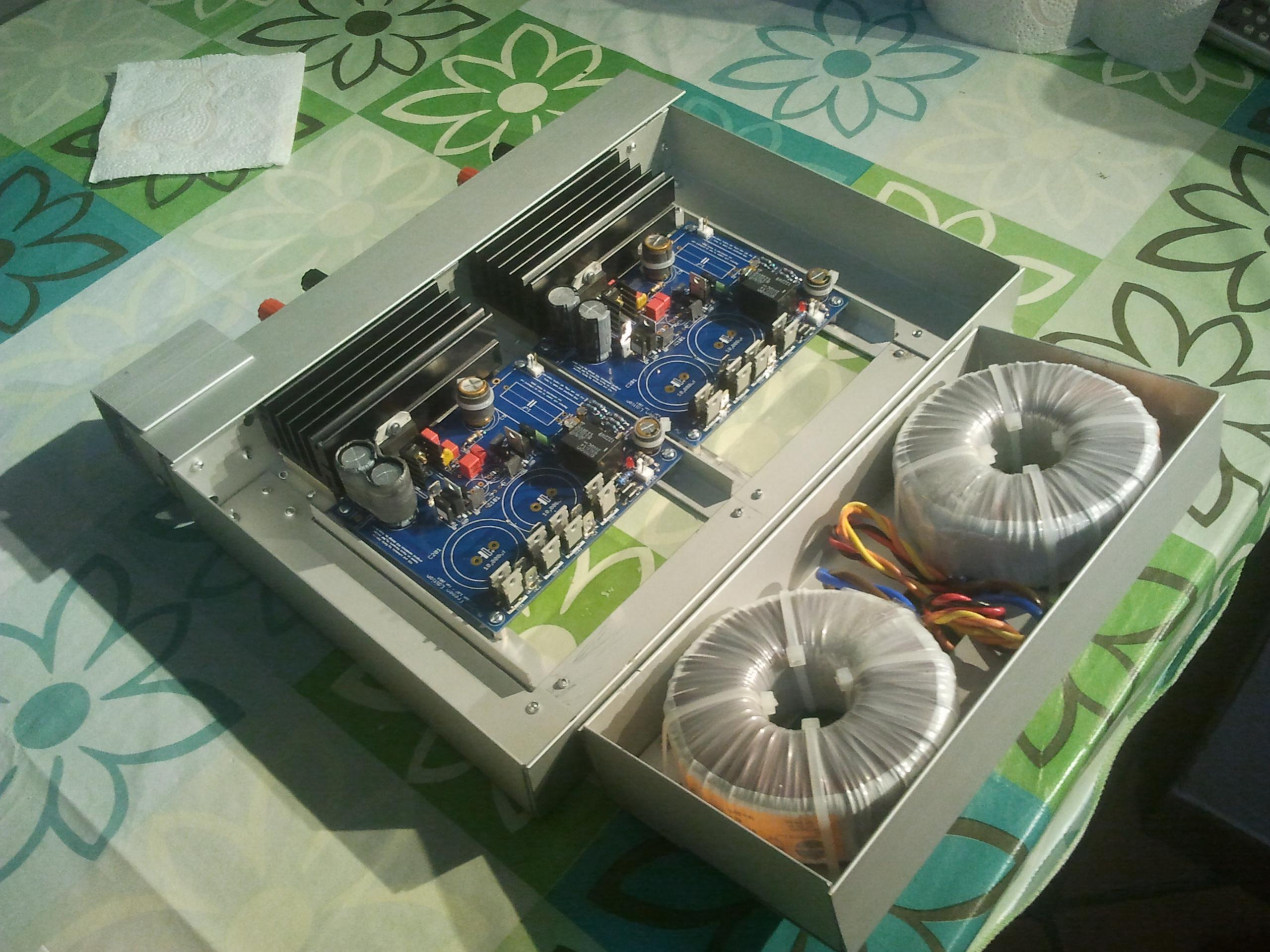

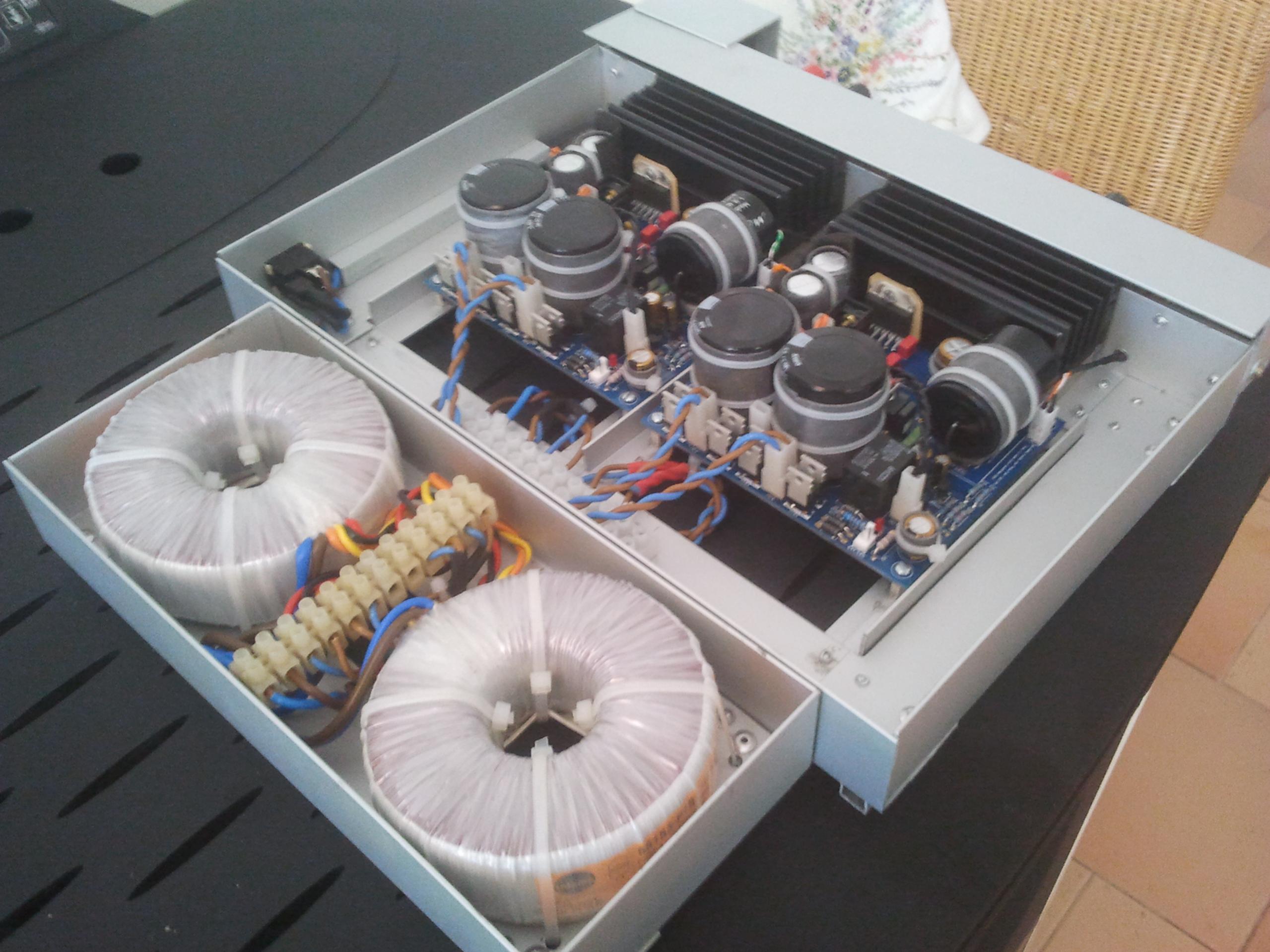

I built the amplifier starting about 2 months .I used your BOM even if some components are not at all the ones you've recommended as a final choice. I reserve further action with the necessary calm. Attached present my creation done by hand, piece by piece. I wanted to make a rigid and lightweight aluminum structure divided into two parts: the one where they lodge the splendid PCB and the other with separate transformers in another case.
these two, the features are then hosted in a yet to be built that will welcome them to implement an inertial confinement through the elastic suspension.
After the wiring I tried to turn on the amp: the LEDs are turned on and there was the click of the relay. I measured the DC offset and I found a channel on the 0.5 mA and 0.7 mA the other. More forward I will do the listening test

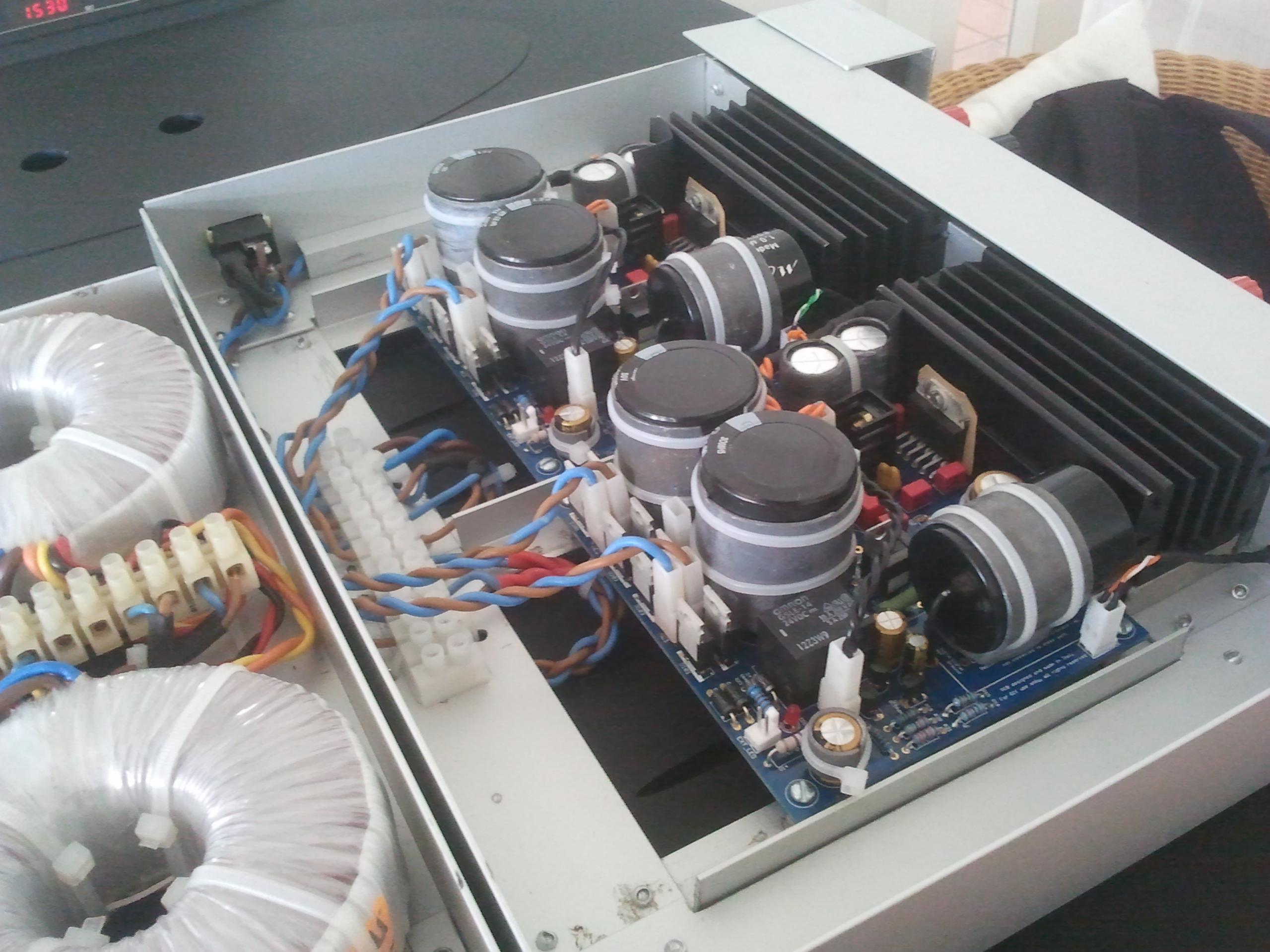

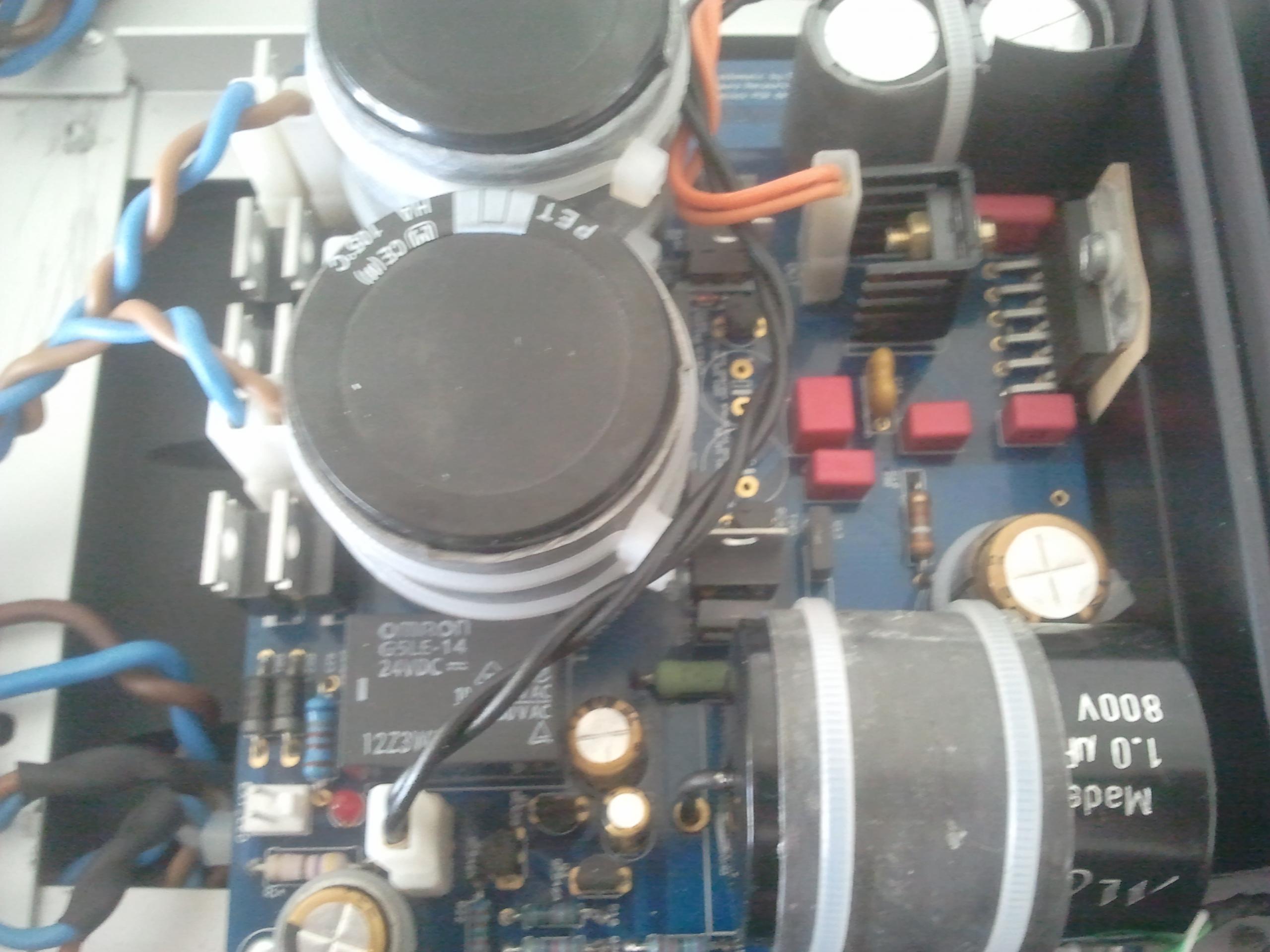

Why have you insulated the smoothing capacitors? (the layer of air between the plastic casing and the added aluminium or metal sheet) !

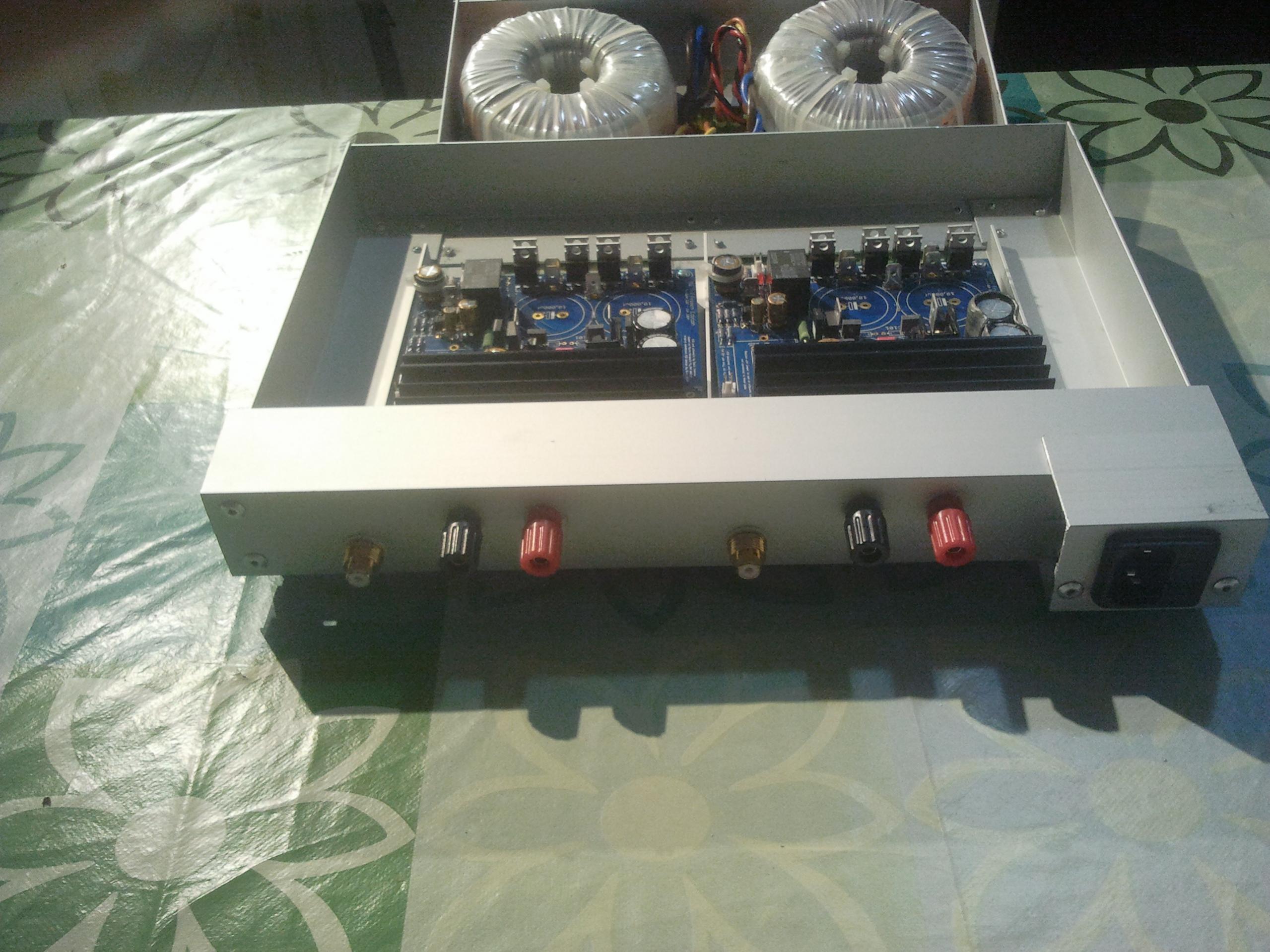

Why have you turned the heatsinks on their sides and then enclosed them so they can't cool effectively?
Why have you attached the chipamps to a side fin instead of to the heatsink backplate?

I assume you will have some air flow over the black heatsink but you will get some additional heatsinking from the Al frame that everything is bolted to - you could put some heatsink compound (grease) between the black heatsink and the chasis to help further.

I coated capacitors (all) with a lead foil to experience an effective fight against vibration. The last measure more '
important will be elastically suspend these chassis to get an inertial confinement of the structure. This part is yet to be realized.
I need time for this.
for the layout of the heatsinks I loosely based on the solution
proposed by Mauro Penasa in My Evolution Ref. (http://www.webalice.it/mauro.penasa/Evolution/Assemblaggio_Evolution.pdf)
The heat dissipation participates entire undercarriage that is aluminum together with the heat sinks.
Interesting, did you ever made an A/B comparison and if so what difference can be heard (if any) ?
will be very easy to remove the shield of lead and check and will give precise statements. This is an experience that I think for a long time and this is a good opportunity. But the experiment more 'interesting will be the structural elastic suspension.

What vibration are you trying to stop?
Also, agree the heatsink area transfering heat to the rest of the sink and chassis is very narrow, most probably ineffective. Would be way better if you flip the sink bottom up and bolt the chip down to it, even though the fins would run horizontally.
