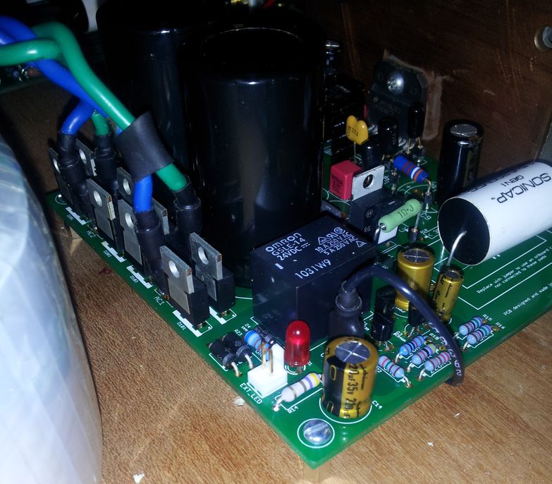

Last week I took the risk and reversed the power leads on one board. They normally are as in the photo - Green closest to M-Caps. Made no difference on hum and amp worked correctly.
Just now checked transformer while not connected to amp - 27.1 & 27.2.
I did blow a non-slow-blo 3 Amp fuse at first attempt at this, so I'm going to remove the transformers and check for internal short/leakage in each one. These are the Antek 300VA with extra shield. I did power the RCs with the ApexJr 120 VA toroids last week when I removed the sockets. Hum was still there.

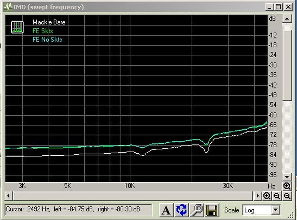

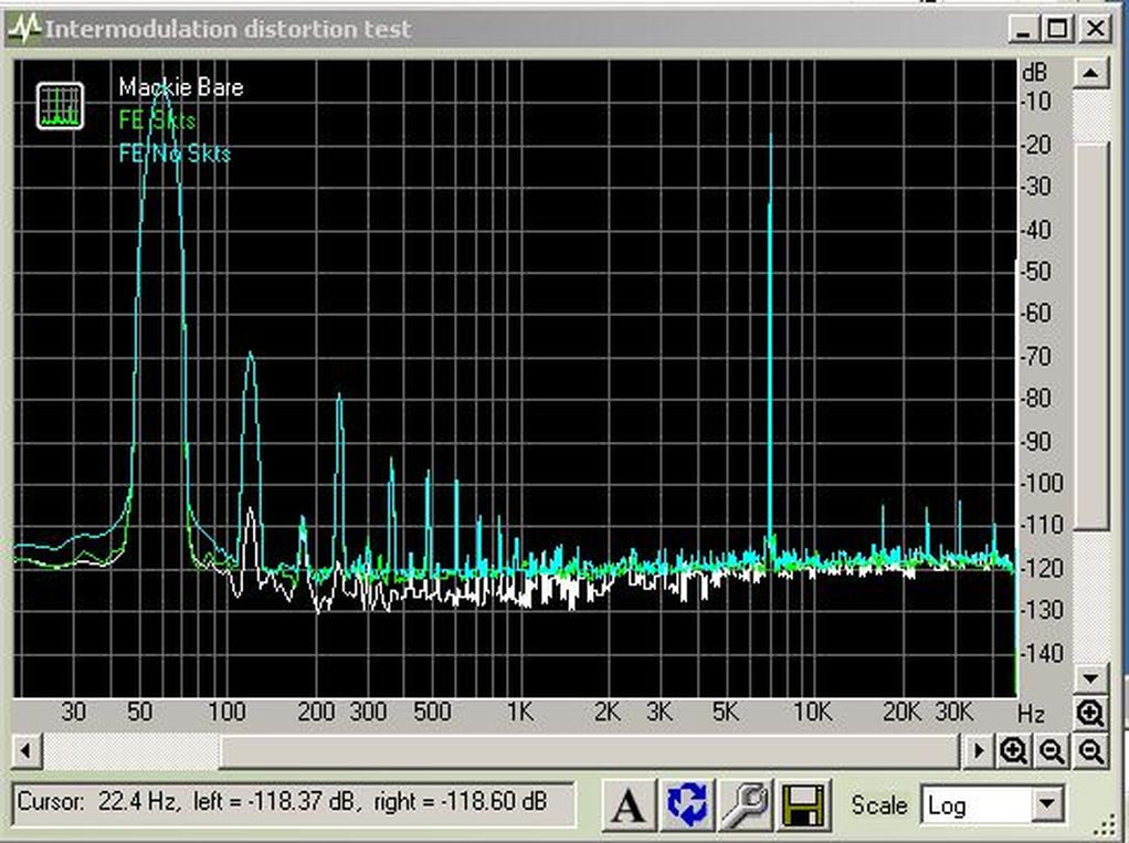

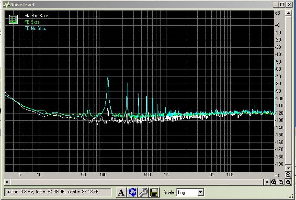

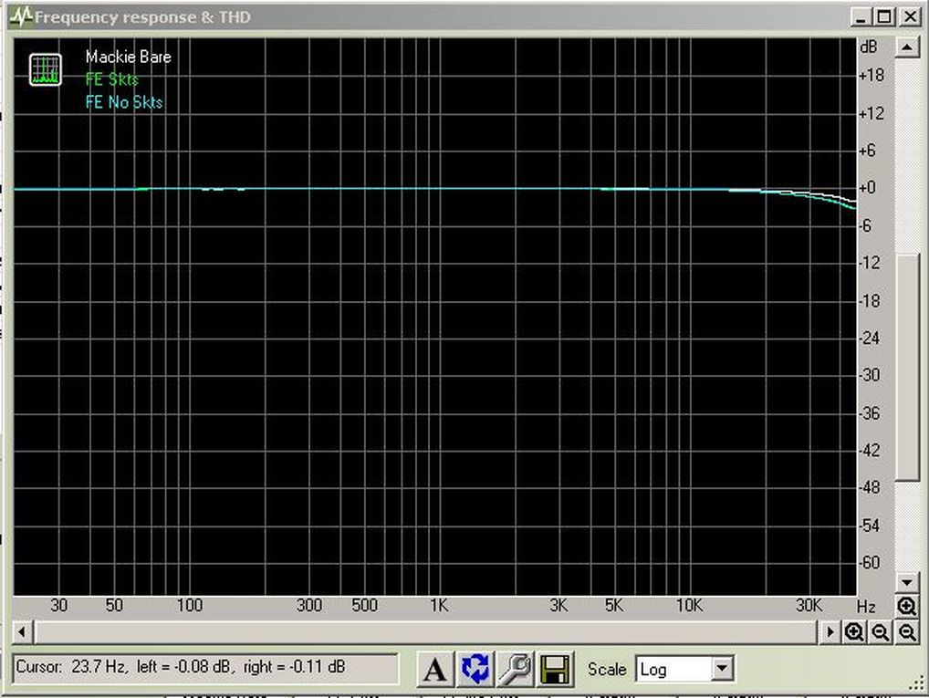

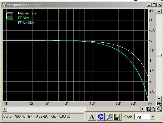

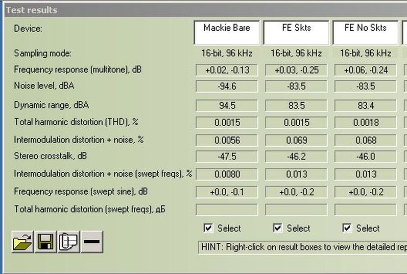

My first attempt to use some diagnostic software - RMAA -with the MyRefs. I settled on a firewire Mackie Sarellite with high quality ONYX preamp section. It was the quietest of several tested. I don't know how helpful this is cause as I read the charts - I should put the sockets back in :confused:
Just used one channel and adjusted to 2.3 db on all tests. The Visual Analyzer is much more sophisticated but has a high learning curve and no English documentation. Here is a link to a tutorial if anyone is interested. The thread here is mostly inactive but I'm pushing -as usual.:rolleyes: When I learn what I'm doing VA should be able to show a lot of voltage and scope info.
Not a lot of great or useful information here but - "Every Journey Starts With The First Step" ;)
Edit: These were performed on the beta builds.

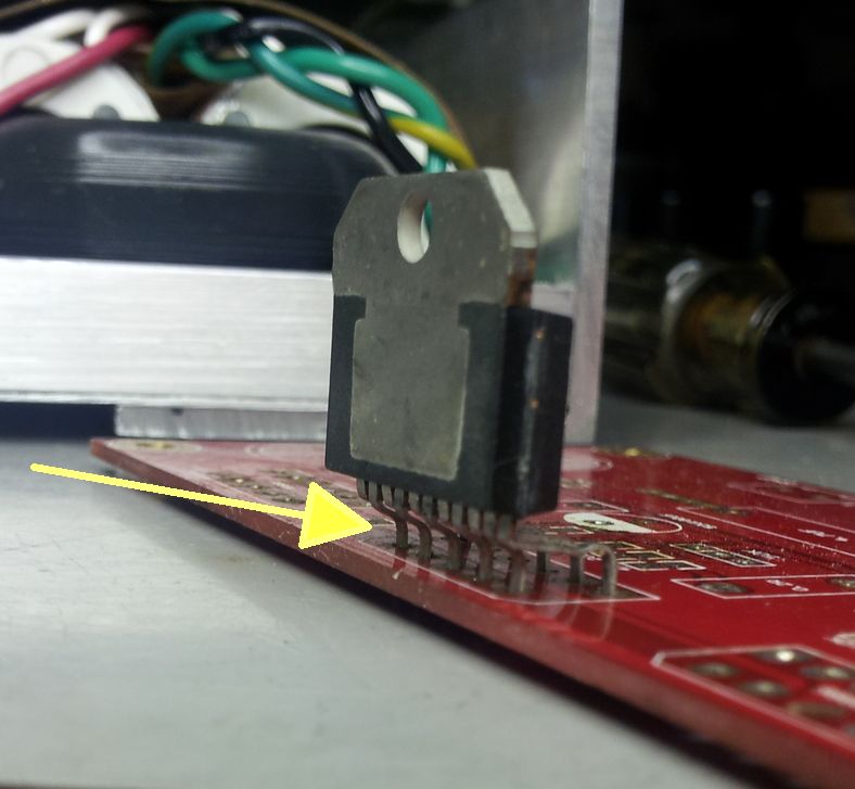

OK, Dario provided a little space to prevent the chip from touching, so if you mounted them correctly (small gap under chip) there shouldn't be interference. Double check the tightness of the LM3886 mounting bolt/nut also.
I have 27 VAC from the 300 VA toroids so yours would appear to be in spec.
I've checked this aspect and is ok. As i never heard how SPIKE behaves i don't know if my problem is related to Spike protection.
