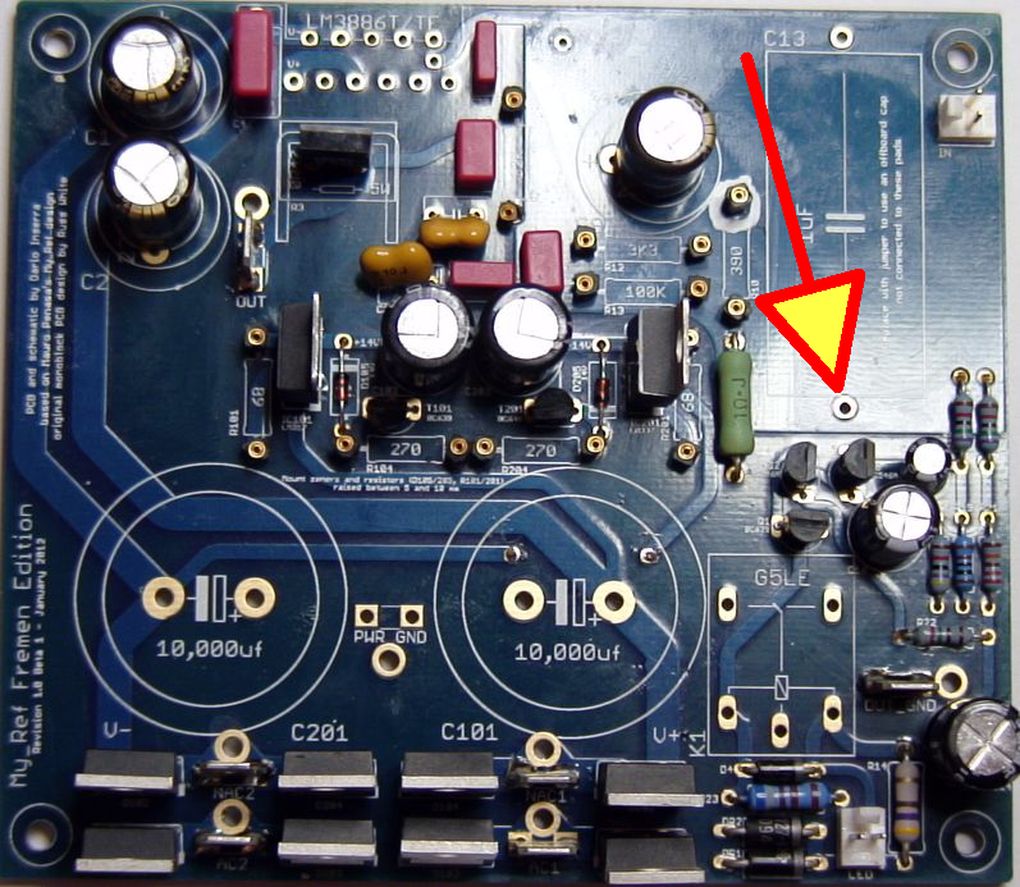

Dario, can you identify any practical measurement points between the two red arrows in this pic? Don't know if there may be too much interaction between components to be useful.

I would use that for checking relative voltages.
But I find device Vdrops to be far more useful in trying understand a circuit and trying to debug a broken circuit. I am useless at debugging.

Badri, Unfortunately it appears you will have to take the same path as Marra. The voltages are the clearest method to solving problems. The schematic is linked a few posts back, and if you have difficulties knowing where to place the probes - please post and someone will help.

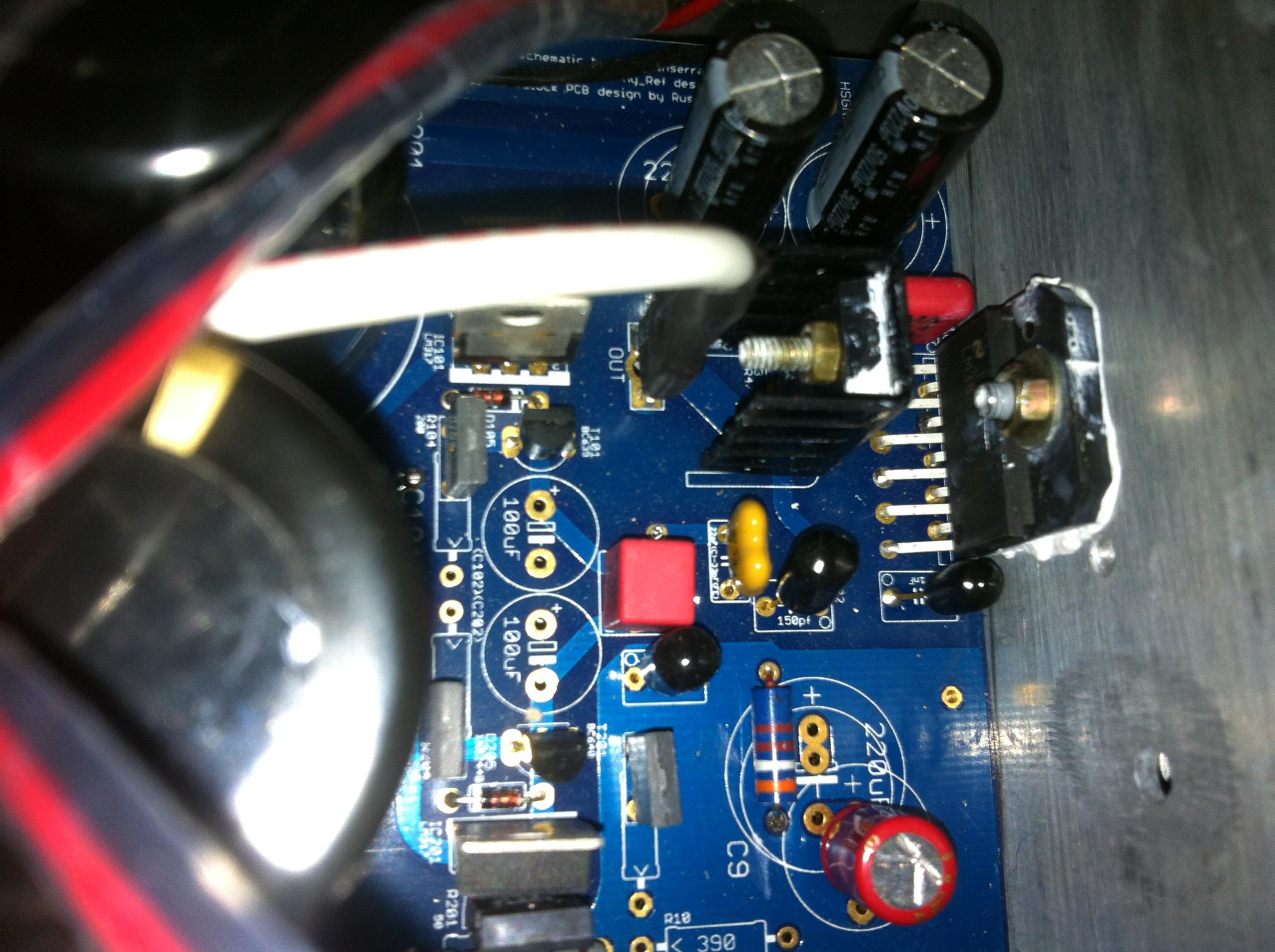

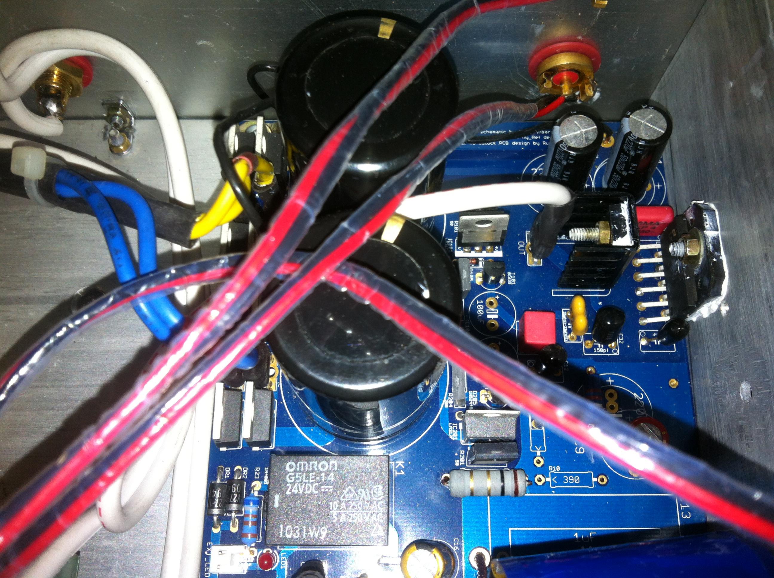

Thanks Bob. I didnt do any measurement so far. I will be doing it little later because of work. But today I have checked it again. Audio coming from one channel without any hum. And I measured the DC of this. It is showing in -ve (-6). Is it normal? Or am I doing wrong? And in another board both R3 resistor and LM3886 getting too hot. Not able to touch it. The DC is 55mV. Any inputs Bob? Forgot to mention, a muffled, distorted audio is coming from the faulty board but its breaking for each second.

It's my understanding that ~12 - 15 mv and lower is acceptable - lower is better. I noticed you replaced R3 previously so my guess would be a problem before that resistor. I hate to ask, but some pictures of the underside are needed. It's a pain to remove the module from the heat sink but those pictures are really needed to confirm a correct build.

Thanks Bob. I didnt replace R3 before. But I changed R11 because it got opened. Pictures of the back side of the board will be posting later because of work.

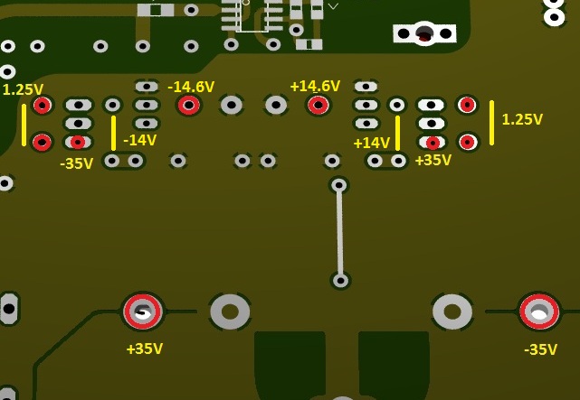

Interesting measuring points:
attachment.php
Real world voltages are around 34.5V for the 35V.
Having a measure different from 1.25V on current setting resistors could indicate a faulty LM317

My troubleshooting abilities are not advanced but so far big parts of problems comes from:
  • wrong value components used
  • bad solder joints
  • static damage
The circuit, basically, can be fixed (if all passives are functional, right value and competently soldered) without troubleshooting replacing all active parts.
The first part to test is the PS.
If it measures well go ahead to the amp, otherwise check parts values, solder joints and replace active components (rectifiers if 35V fail, LM317 and BC639/BC640, zeners if 14V fails).
If PS measured voltages are good check amp section's parts value, solder joints and replace LM318 and LM3886 (remove first D1, D2, D3, when the amp works replace them).
It's a bit rough approach and. maybe costly but it worked for me several times.

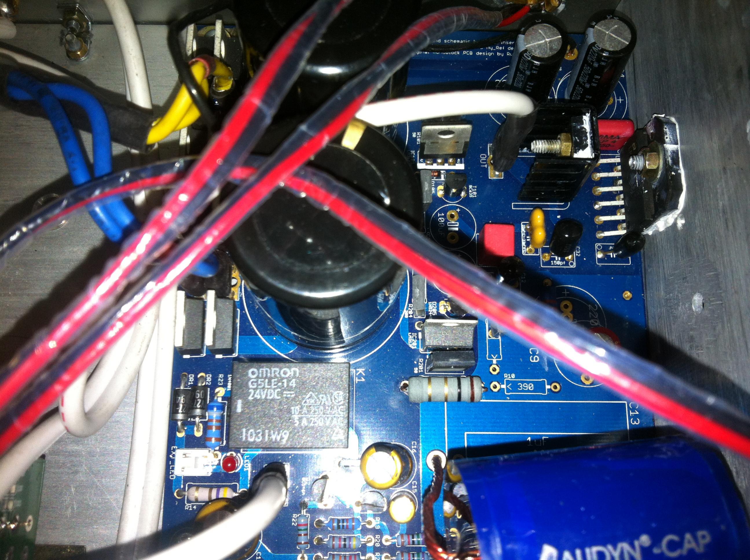

I can't understand can you clarify?
Is it the working board?
With -ve are you refererring to the supposed -14V?
Measure the PS first, if it works correctly relace LM318 and LM3886 after measuring all passives.

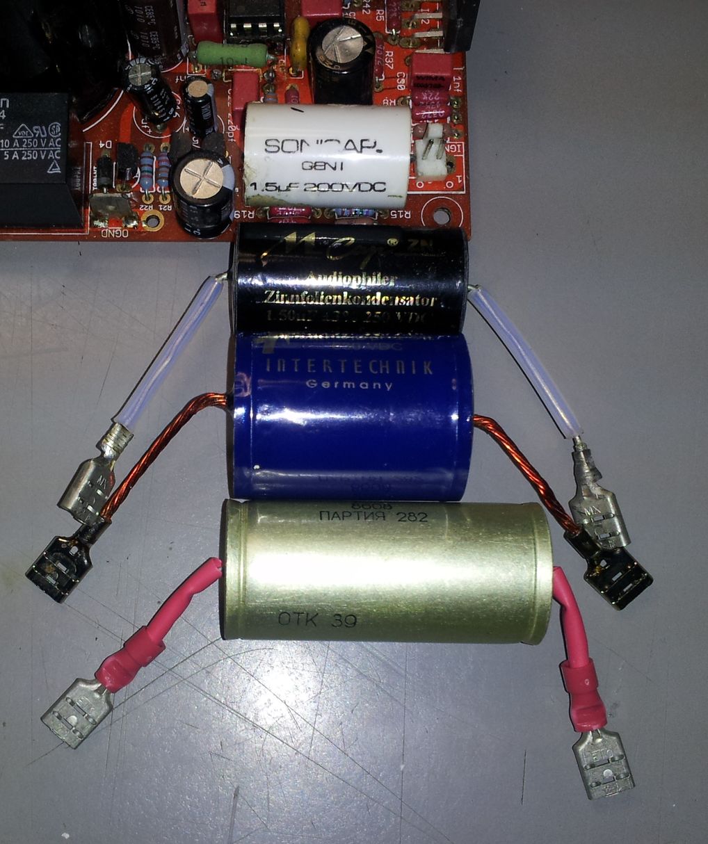

My apologies to Jac for dilly dallying, but I finally had a chance to hear the K71 caps. I'm not sure how much they cost (Jac implied very inexpensive) but they compete strongly with everything I have tested. As I see it, there are two costs ranges that apply: $10 and under - Sonicap, Audyn Plus and K71 (I think) & $20 or more - Mundorf ZN and Audyn True Copper.
I still like the Audyn offerings with my system. Both present an airiness and separation that presents what I label as a "Refined" sound. I need to lean in that direction because I listen to a lot of complex Big Band and Classical music. I admit the other caps generally provide a bit more color, impact and/or warmth. I actually preferred the richer, dynamic presentation when I started building these amps a few years ago. Now I lean toward "the best improvised jazz solos come from musicians who know what to leave out" approach to amps. ;)
The K71 sounds very full and musical. I tried them in both rotations and they followed what appears to be a pattern: one direction emphasizes volume and presence, the other produces a lighter more dispersed sound. In the first instance I preferred what the K71s did for the low end. The floor vibrating pedals were just as strong as the TCs but better controlled - almost like being able to perceive the cycles within very low sounds. I don't think I have heard anything better.
One of my test tracks starts with a high pitched orchestral bell that, through its duration, seems to find resonance in every corner of the room. The K71s produced it as well as anything I have tested. That is followed by some acoustic guitar with lots of fret noise. Again the K71 caught all the detail with clarity and brightness.
Where they fell down was on the vocal. Though very rich and a little forward, the edges were fuzzy and somewhat pronounced - leading to a touch of muddiness - when compared to both Audyns. I would suspect a two way speaker might not expose as much of that as three ways, and I would not call it disqualifying. It's a slight negative for me that could probably be fixed by adjusting/selecting other components on the board or speaker crossover. An extended burn-in might also clear it away. It is truly in an area that is system and source material dependant. IMHO, the Audyns have the edge in cleaning up the mids.
In short, had I not owned the TCs, the K71s would be my top selection. For builders watching their budgets the K71 and Audyn Plus caps beat the pack in "Bang for the buck". choices.

Of course, as you point out, it will depend on your system. For me, it is hard to pick between the TCs and the K71s, in my system. I do have a pair of 0.22 uF TCs on order, for the input of my active crossover. They will go together with some 1 uF K71s in the crossover, so I'll see how mixing them together works out.
As for the price, if you only buy 2, they are $2.60 each. Of course, you have to ship them, so the shipped price for 2 is $6.10 each. The biggest problem with these is there size.

As someone posted on the beta thread, the K71s might be a good candidate for off board mounting, bypassing the input pin and the first pad - chassis size permitting.
My measurements:
Sonicap = 26 mm
Mundorf ZN = 36.94 mm
TC = 36 mm
K71 = 48.27 mm

As usual, Tom has an interesting point. I would have thought that the inductive effect of the long leads would have been a greater difference than the fastons. In that case, the different sizes of the caps would result in different lead loops, even if the leads were the same length. My assumption would be that both the faston and long lead effects are very small. But then again, my assumptions have been wrong before. Any thoughts?
As for faston connectors, does anyone have a favorite and reasonable brand and source for both the board side and the cap side? I admit that I'm not satisfied with the quality of my stuff for audio and would love something better without paying the mega dollars of some of the PCX brands.
