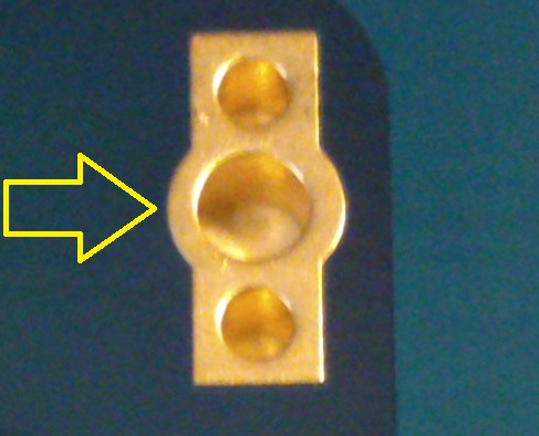

Faston Connections at the Speaker In and Out
Although I know that Tom and others prefer never to use Faston's or disconnect terminals, it is the "normal" way to attach the speaker wires to a MyRef. I've been looking around for alternatives that are better materials without going crazy with the Furutech/WBT expensive alternatives. I found these industrial parts from Mouser that might work.
This is a case of flipping the connection. It uses a female board mount made from brass with a tin over copper plating. If you look at the Mouser page, you won't see what you are getting. Look at the Data Sheet.
1217080-1 TE Connectivity / AMP | Mouser
Once you get the female on the board, these are two sizes of copper, male wire mount disconnects. The small one (18-22 AWG) is gold plated copper. The bigger one (10-12 AWG) is also available in other wire sizes and is tin plated copper. Again, be careful by reading the data sheets. Some of these are mis-specified as copper when the data sheet shows brass.
19022-0004 Molex | Mouser
19004-0012 Molex | Mouser
In the end, these are a pretty low cost alternative.
I would, instead, use the holes for bare wire no cost at all and best result... ;)
