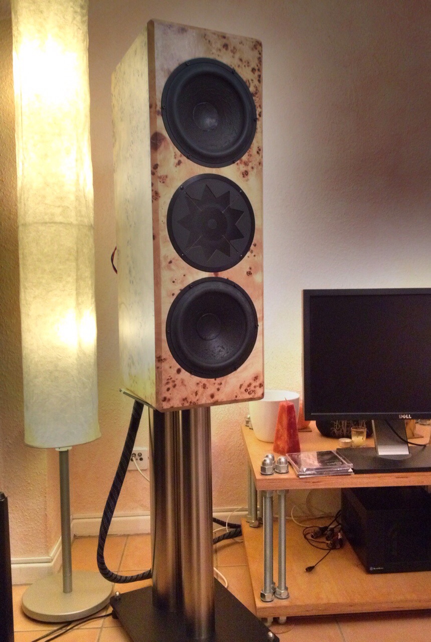

1543, by active speakers do you mean two 3-way speakers with electronic crossovers, or three stereo sets. Active often means a cabinet that includes a driver, amp and XO.
You are right active speakers typically includes crossovers / DSP and amps in cabinet. But as long the amplification is done after crossovers it is called active speaker. Independend if amps and crossovers are inside or outside of the cabinet.
I am using JRiver as DSP for a 2 (2,5) way speaker.
