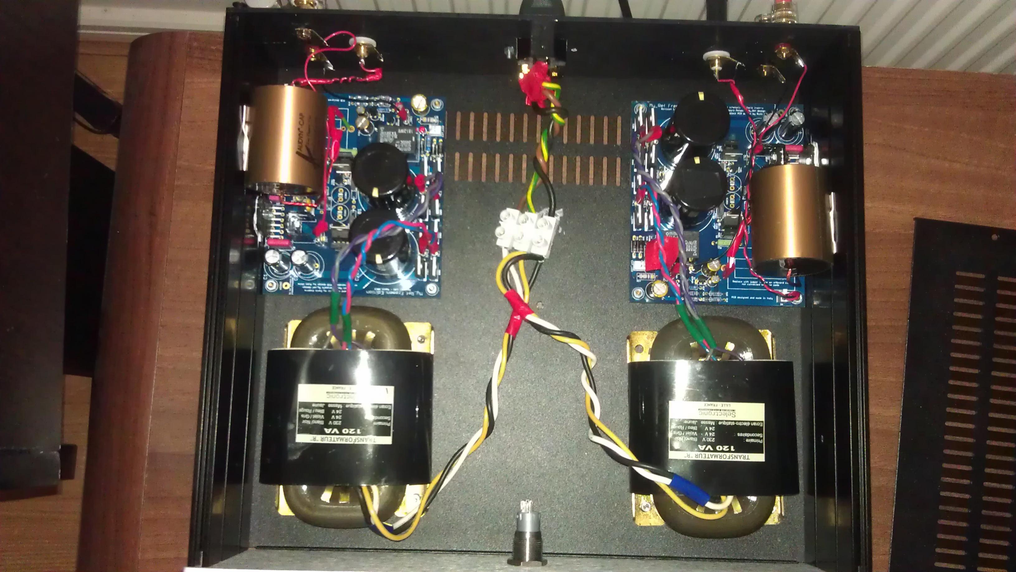

Last week I slammed the door on the tv stand and suddenly heard weird high pitching noise.
(...) Few days ago I got back and just turned on amp with small test speaker - hum on both channels.
Really strange... I can't figure out how the amp could be damaged in this way...
You don't have any socket or similar, right?
Double check cabling and his polarity, if you reverse input hot and ground you can have a large amount of hum (but in this case DC offset is normal).
Your layout is still this one?
The boards were fixed to the bottom plate by screws, right?

Layout is the same. Only twisted wires. Hum, as I understood is ok with disconnected amp. The other thing is b1 which was not really housed and Has obbligatos loosely attached(put on the own wires). I. Guess it Could cause the noise. I did Not Hear noise with No pre attached, only hum.
still values of dc offset differ with inputs shorted and right channel is swinging up down to Negative Badly...

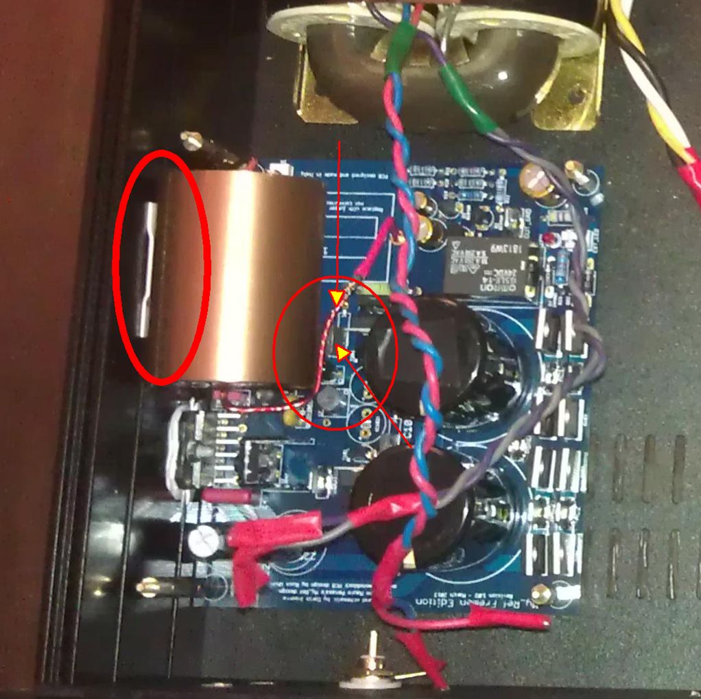

Will, Didn't you have hum problems with the metal shell of the Audyns being too close to the chassis ground? Ivan has just some thin double sided tape. I also see the cap lead being right next to some other components. Don't know if that routing (antenna effect of cap lead loop) is causing a problem.
Yes, I had some problems with the metal body of the k71-4 interacting with the mounts that I made for them. Some of the other caps that I used also had similar effects. In my situation though I was only able to eliminate the hum by using the pgnd connection.

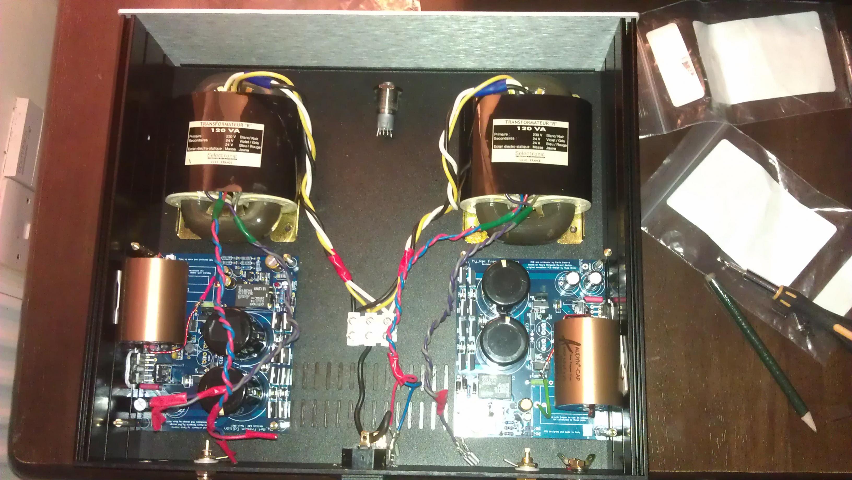

I have disconnected left board to check soldering- all fine. Put it back and my (not autoranging) mm on 200mv scale showed 0.44 or similar.
So left is fine- I have had something connected wrong ( !) , and btw I have opened up a bit to be able to put it easier (for now). It could be the case also
But left channel, as it was before shows anything between 0.4 and 0.7 and never stabilizes..
Inputs were shorted .
I meant to say fastons
So DC offset is 0.44 mV?
Incredibly low... if so you can try connect test speakers and tell us if you hear music... I bet it's not the case....
The TCs lead extension was insulated when the incident happened?
If not it's possible that you had high DC on LM318s and fried them.
It would be nice if you measure DC voltages on regulator.
