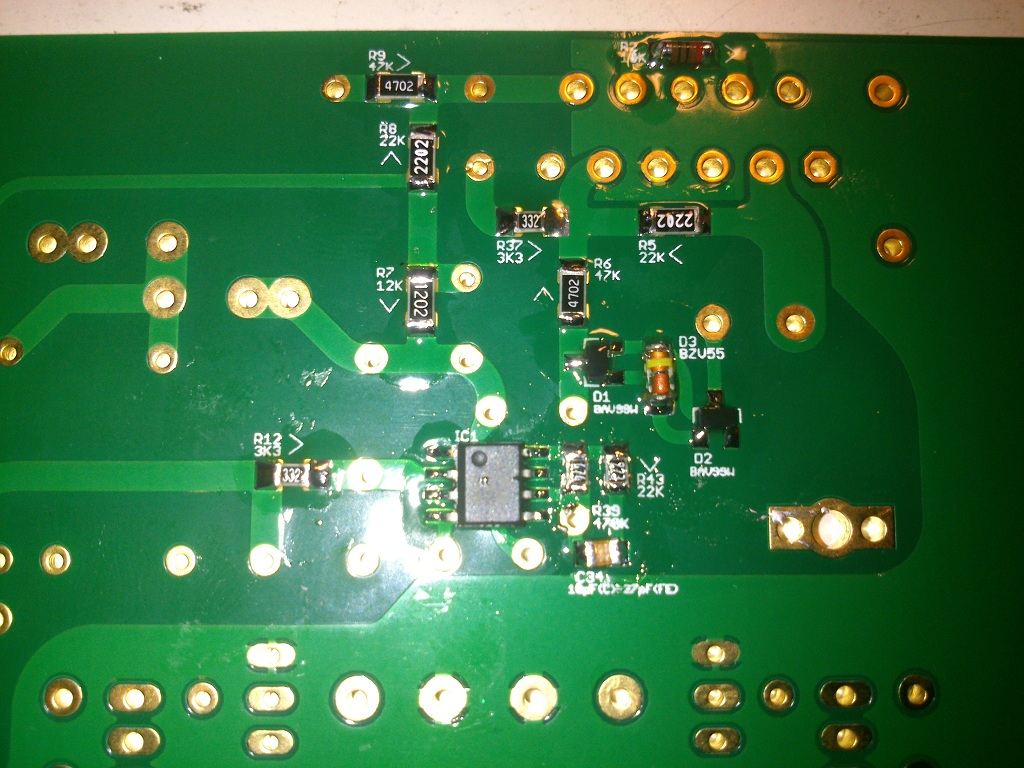

I did as you said and cut the 3886 away and removed the pins individually. I'm having trouble getting the remaining solder cleared away from the thru-holes enough to insert the new IC.
Fill them with solder, and use a desoldering pump to suck out the solder.
You can, eventually use the solder tip on one side and the solder pump on the other but you will need a third hand.

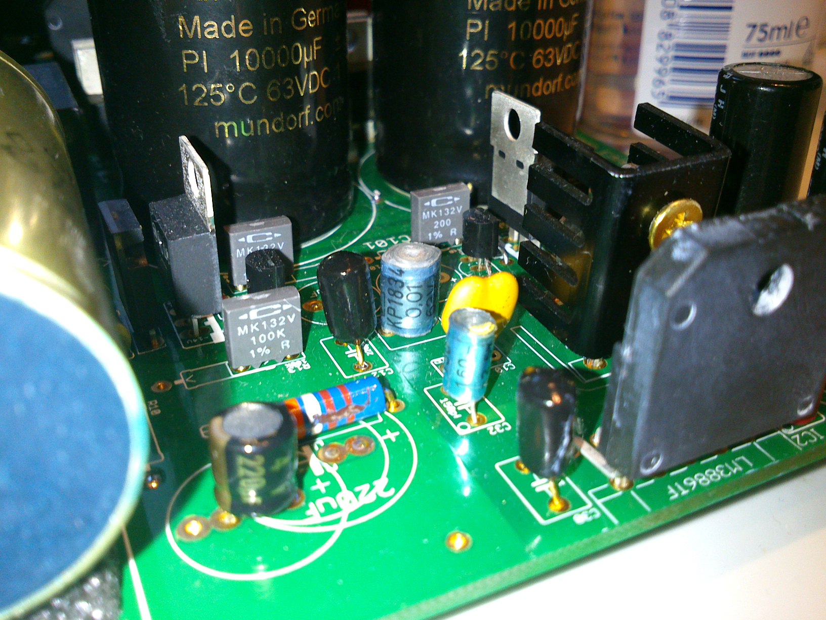

Today I've upgraded my brother's My_Ref with RC FE modules:
It's been a very interesting day... we tested again the two C9/R10 arrangements (we both preferred the new one as per KSTR recommendation), and tested Caddock MK132 for R10.
The Caddock there sound very good possibly cleaner and more neutral but we both preferred Rikens (more musical).
Finally we tried Texas VSMP bulk foil resistors for R12.
They're for sure an improvement over the Susumu (more alive an musical) and since we bought them we mounted those.
But at a whopping 8x the price of the Susumus I'm not sure I would call it a bargain...
Also they come with no marking at all and, obviously they're directional... we could test direction mounting them on the adaptors and tried on the beta boards.
So I can suggest them only to the hard core, price no object builder and too willing to test their direction.
For builders that bought the ERO kit please note directions:
Also for builder that bought K71s note direction:

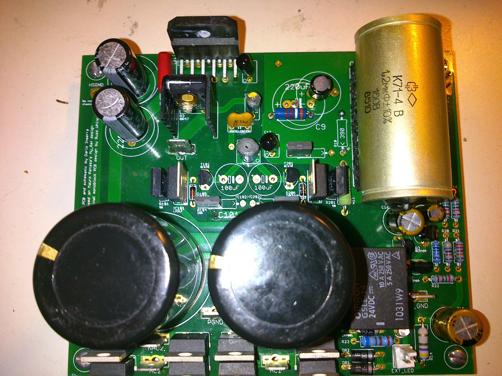

My boards arrived today, with the elna and ero capacitors kit... they are stunning!!!
Thank you Dario for all your efforts!
