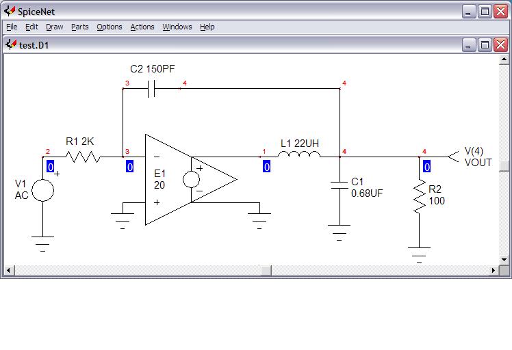

for anyone who is intersted how to damp output filter's resonance here is a simple spice model and results. Pwm output stage is modeled by ideal voltage source with fixed 20x gain. This is valid up to 1/2 switching frequency anyway. Output filter is a typical value of 22uH and 0.68uF and is far underdamped by 100 Ohm load resistance. 150 pF feedback capacitor does the magic. Try to remove it and you will see ringing in transient response and peak in frequency response. Interesting thing is that this works with any pwm modulator principle (triangle carrier or self oscillating). To my knowledge it has not been patented anywhere and from this post on it may be considered public domain knowledge .
