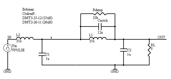

By the way, I have just received 2 samples of a 35uH coil from Coilcraft. The exact model is: DMT3-35-12. Do you think it is suitable (saturation, etc)? My design for the filter is, finally, shown in the attached image.
Ripple rejection is about 100dB if properly tuned :bigeyes:

Hi ssanmor
I expect that your dead-time approach would work.
Depending upon output power your coil migh be sufficient with 12 Amperes. What I didn't find on the particular webpage is the optimum frequency range for this coil (i.e. the core to be exact).
Depending on what you want to use the amp for, the f3 of 27 kHz that you'll achieve with your output filter, will be a little low.

It shouldn't be a problem for the feedback in these case but it affect the overall frequency response. Such an amp is regarded as rather sluggish today. I would take a main capacitor of half the size which would also result in a lower filter Q (i.e. better transient response). But I assume that you will play around anyway.🙂 😎

From the description they seem to be intended for AC mains filter usage (which might be good for you as well in a later stage !).
Also the core-shape seems to be generate quite some stray-field.
Another thing I was once thinking of was an "air-cored" toroidal coil. I.e. one that you wind on a toroidal core made out of insulation material. The advantage would be neligible saturation distortion and reduced stray-field compared to cylindrical air-coils.
The downside would be the need for more windings than a similarly sized cylindrical coil.

I think that cores are not intended for mains usage, they sell them as ideal for switching power supplies, but I am not sure. It is a matter of trial and error!
