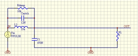

In my previous tests I have used only a 2-pole output filter (33uH coil and 1uF capacitor). The result is -38dB rejection that leads to a 350mVrms ripple at 250KHz that is not pretty but doesn't disturb neither.
Although my final board was going to use a 4-pole + notch achieving more than 90dB of rejection I am re-considering simplifying the design simply by adding a notch to the 2-pole design, leaving it as in the draw below. It achieves more than 60dB of attenuation at 250KHz if properly tuned, which should leave about 30mVrms of ripple.
Is there something more that I should consider? I think that these figures are very good as the ripple at that frequency is not audible and produces only a minimal extra dissipation at the speaker. What do you think?
As you can see, I am trying to optimize the design. When I have finished it, I will provide the complete schematic here.
This is the new proposed filter:
Hi Sergio
I don't feel very comfortable about that. You won't achieve enough suppression of the higher harmonics (you should consider your neighbours, who like to listen to their radio, and all the airline passengers who want to arrive safely !!!).
Apart from that, the output filter is also a reconstruction filter and I doubt that simple notch filter can do this properly (If it would, all DACs would be followed by notch filters instead of LPFs). If combined with a notch-filter you don't need as large a inductor and cap as 30 uH and 1 uF however.

>>Apart from that, the output filter is also a reconstruction filter and I doubt that simple notch filter can do this properly (If it would, all DACs would be followed by notch filters instead of LPFs). If combined with a notch-filter you don't need as large a inductor and cap as 30 uH and 1 uF however.<<
OK, I am now with you in that it is better to use a 4-pole LC to reduce EMC. About the notch, Crest LT amplifier, for example, uses this technique, although with a higher order filter. Then what about my first design, a 4 pole filter with a capacitor in parallel with the second coil to form a notch?
Sorry if I insist, but what do you think about definitively removing the output diodes?
I will have alook at you first filter design.
The diode question depends on how well your FET's intrinsic diodes can deal with the inductor's freewheeling current (most important parameter is reverse recovery time).
You should not only take the sound into consideration in this case but reliability as well !
Regards
Charles
The total reverse recovery time is 170ns for the maximum current (37A). Fast enough?
The original filter was 33uH - 1uF - 33uH - 470nf. A capacitor of 12nF and R of 10KOhms in parallel with the second inductor.
Best regards.
