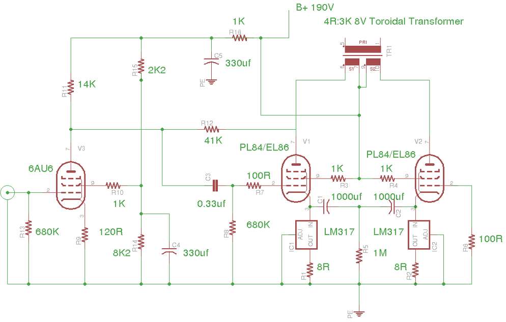

I have just finished my latest amp. It is loosely based on the self splitting DiyParadise Simple EL84 amp. This has been a project in the planning and evolution for at least 5yrs now so its a great relief to have it finished and working.
It differs in a number of key areas though. I chose to use PL84's (16V EL86) because they are cheap and readily available and allow for lower impedance ratio Output Transformers. I also chose to use a 6AU6 as the driver. I am running both the PL84 and the 6AU6 in pentode mode, and this allows me to run the input and driven valve as a partial feedback combination. I have used LM317's in the tail of each of the outputs as CCS and have linked them for the self splitting using back to back 1000uf caps to allow fixed DC standing current and full differential output. The antitriode is run as a pentode. I am running 8V toroidal power transformers as outputs. Almost everything in the amp is salvaged so it has cost me almost nothing.
I was expecting it to sound good, but am a little surprised at how good it sounds. It has a slightly warm but very detailed presentation, and has masses of bass punch. I would have to agree with others impression of this configuration in describing it as having SE warmth with PP punch and extension.

The thing with the 6AU6 is that it can handle respectable current (ie 5mA+) which is way more useful than most of the piddling little small signal pentodes which seem good for just about 1mA. this is especially important with partial feedback amps because the feedback current is liable to swamp the output signal otherwise. I have used it in my Tabor clone and now this one and both have sounded sweet without any hint of pentode harshness. There are also different voltage versions which makes it quite an economical tube.
The antitriode is the slave valve in a self splitting output stage which simply supplies the current to balance DC and AC signals in the output transformer. The stiffer it is the better it forfills its intended role - so configuring it as a pentode works best.

Here is the schematic.

I have used them in a number of projects and they have worked fine. My philosphy is that they are so easy to use, they are robust, and in this application, even if they drop to 100R at high frequencies - that is still 100X the resistance of the capacitor which still leaves the cap dominant.
To sum it up they seem more than adequate for this particular application. I would not consider them for plate loads though. Broskie seems to agree with me on this one which is a big enough thumbs up for me.

That's a cool idea, using partial feedback to turn the master tube into a triode
and the slave into an anti-triode. I think you have a winner here.
The LM317 is not by definition "lowly"; it has it's applications where it works well.
But in this circuit I don't think the CCS are in parallel with the caps, they are
in parallel with each other (AC) and with the cathode resistance of the output
tubes (1/gm). Still not a very high impedance needed but maybe more than
100 ohms.
Michael
PS have you experimented with different amounts of local feedback with this circuit?
I haven't actually calculated the impedance of the LM317 and suggested the 100R as an absolutely worst case scenario.
The gain of this circuit is a little high at the moment. I think an implementation with a PL84 as the driver might solve this problem and also allow a slighly lower amount of partial feedback to boot - which would probably sweeten up the sound a little. I have the valves to try this, but don't much fancy changing the sockets so won't be trying it any time soon.
