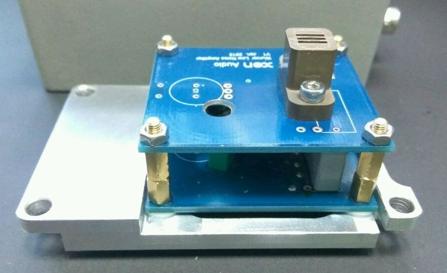

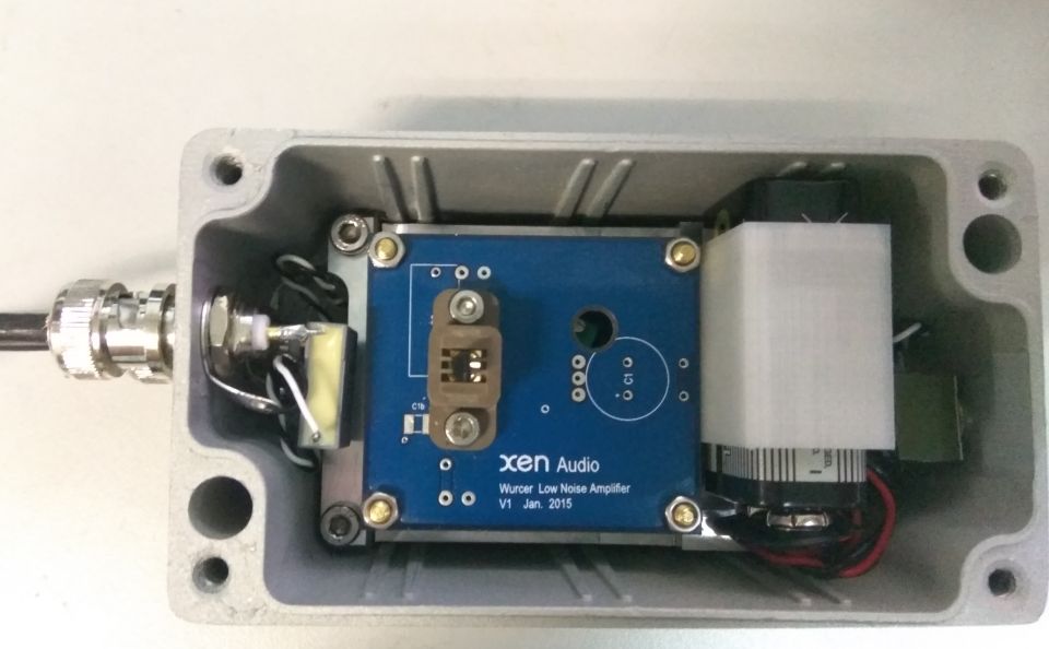

We also built a special version where the JFET is replaced by a TO92 test socket.
The latter sits on a stackered board which provides mechanical support.
We used a Version 1 board which had a layout error, so no use otherwise.
Now we can screen JFETs for noise.

While we are at it, may I also send you one (as a small gift from XEN), Scott ?
Your postal address is still as before ?
Patrick
