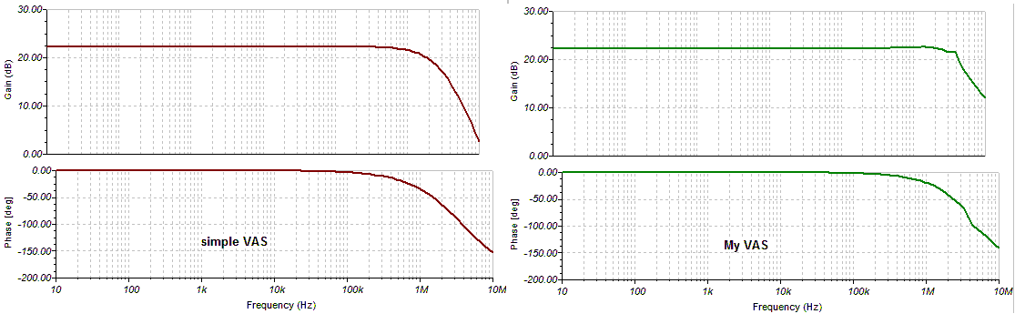

Yes, you right. I am using 1mS at that sims. and 2mS simple VAS doing better. The first suspect is capacitive characteristics. I removing compensating capacitor from the VAS, and that flat spectrum distortion is slightly reduced. I remember with my first good sounding VAS that has 100mA bias, high current may reducing its effect. Capacitive characteristics is reasonable than "memory". But that simple VAS has similar bandwidth than mine. This reason need another suspect.

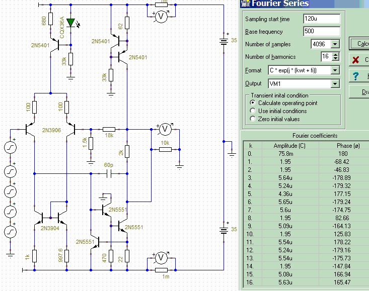

I place again the 300pf configuration. This configuration make it better in single tone but worse in multi tone, Flat spectrum is still exist in 100uS (seems that I am using 100uS before, it is close, while as I remember it is 1mS). Without 300pf, simple VAS need 5uS to reach around 10uV flat noise, and my VAS 2uS. When continuing to 4tone, simple VAS need 12uS, my VAS still 2uS. In 5 tone simple VAS noise appeared then dissapeared from big to around 2uV until 80uS, my VAS not. This another things happen.
Oh no. It is up to 120uS and continued until milisecond scale. And I also found in my VAS but much smaller (reach 1uV). Simple VAS still reach 5uV. 5uV when integrated is big.
Any clue what this is? I need a way to remove this things. This spectrum appeared then disappeared then appeared again and again until reaching milisecond.

I am removing all capacitors, no effect, then using different windowing and highest sampling FFT also not help.
It is not capacitive problem, nor FFT problem. Inter modulation? No, nor harmonic distortion it is all freq (like square) and happened also at below 500Hz.
I do check the sum of input generator signal FFT and still undistorted and noise less.
It is pure from VAS faillure. Probably this one that makes the sound differences. Since my VAS has lower in it.

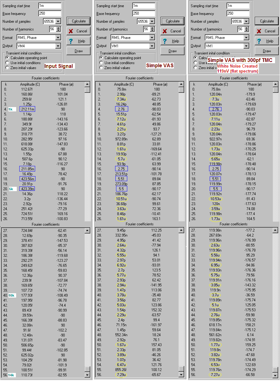

I have found that good 3 tone test is 1kHz, 4kHz and 5kHz. And 5 tone test is 1kHz, 4kHz, 4.5kHz and 5kHz. This test is also useful to choose which one is the correct compensator value, I found that my compensator value better 180pf, not 150pf, yes, easy tweaking without listening.
Attached is an example that shows what TMC do in multi tone, and selecting wrong compensator capacitor value also do the same, also happened when compensating capacitor has more than 500ohm (I try it with series resistor and noise showing up). The noise caused by TMC is higher in 3 tone test, 250nV. The things that I concern is the noise, because it is flat.

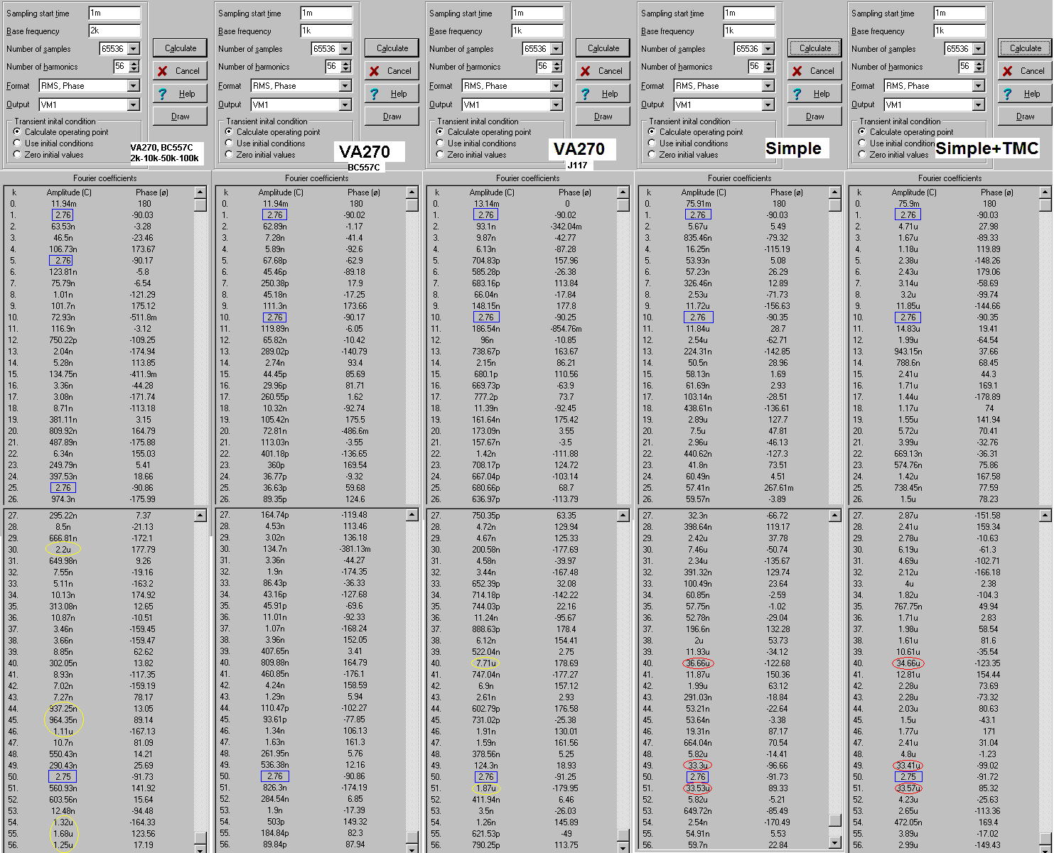

Yes, that CE capacitor is better if removed, and if it need compensator, you could try at other place like between input output in J2. Ofcourse without compensator and keep in low NFB is better, since all local V->I and I->V transfer has good linearity and transient response (if noise from my previous post exist) is minimum.
I am also try 1k-10k-50k-100k, I have problem with 1k-10k-100k, because my sim only support 64 number harmonics, so I using 2k-10k-50k-100k to show spectrum around 100k.
I couldn't found JFET advantage here, but I ever built a mixer with tl071 and c4570, and TL071 has better in clarity than my mixer that using c4570, at their datasheet, technically c4570 much superior than tl071.
In this test I also couldn't find TMC creating noise. From the spectrum previous post, the noise looks like small square spike that may repeated when transient condition restarted due to random signal (like crossover dist, but much smaller and more often repeated by random, instead of crossing).

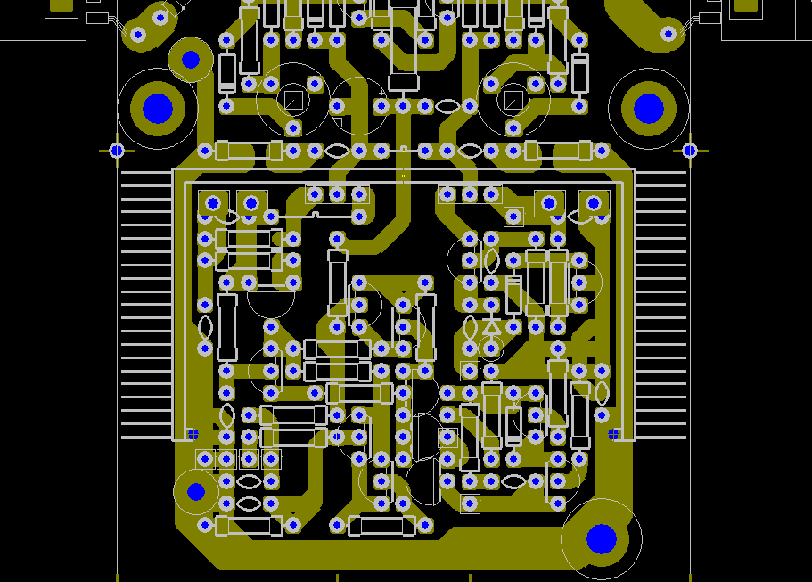

This is other PCB that usable for VA270 with 2sc3355(BEC) and bc557(CBE) without swap its legs. Just add 150pf or 180pf Cc and it will be the same. It using all 2sc3355 replacing 2sc1815 and VA270 also work with it(all 2sc3355).
VA290 has much higher bandwidth, but cable feedback easily happen. It need good input-output cable separation and need additional input HF filter. Not recommended for DIY, except PCB layout, it is usable for VA270 with Cc added on PCB back side.

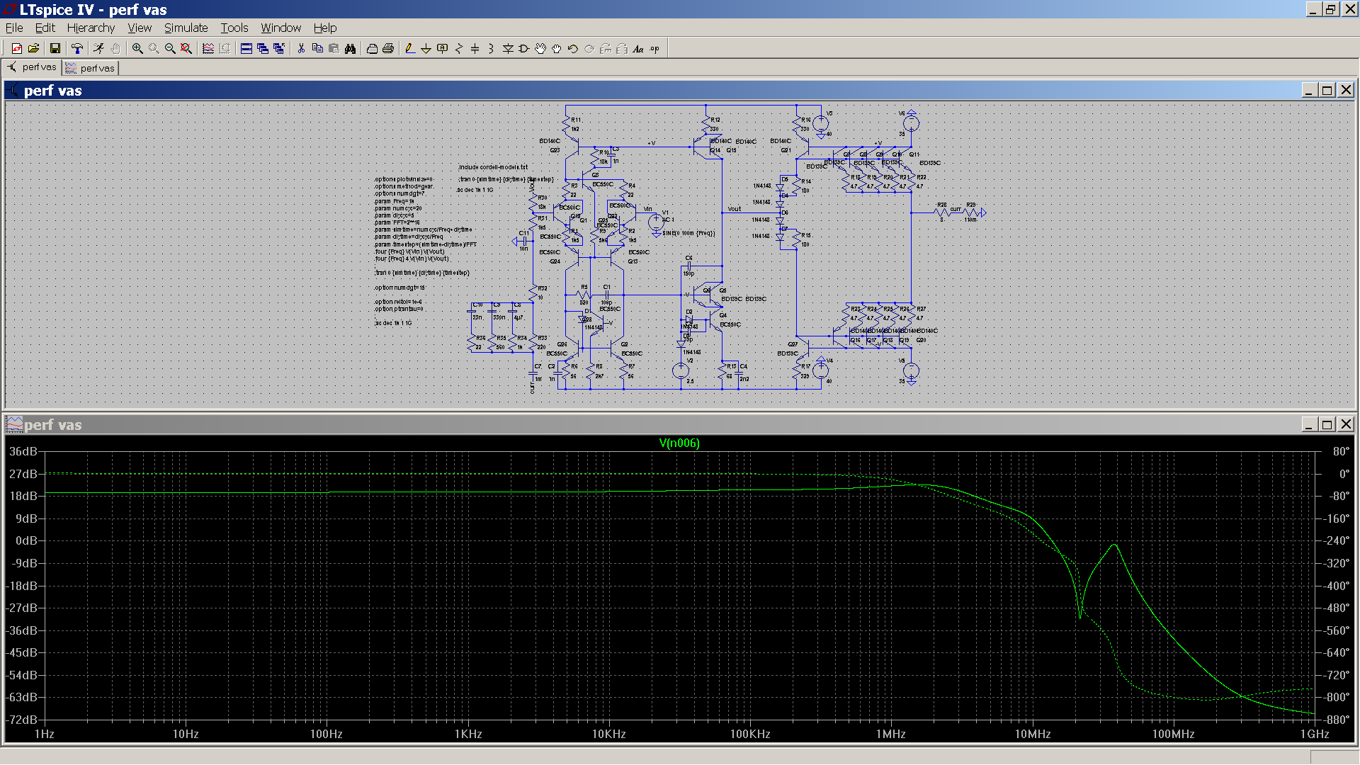

Hi Ontoaba
in LTSpice your circuit is oscillating using Cordell modells
or have I made some mistakes?
  • perf vas.asc
Q1 and Q2 need to be replaced with RF transistor (ft>800Mz) it work with 2sc3355 or S9018.
BTW I am no longer using it, because some simple VAS with low performance and much distortions are sounded better, don't know why:confused: I am still try to know what just happen, but two of my amps still using them (this VAS).
