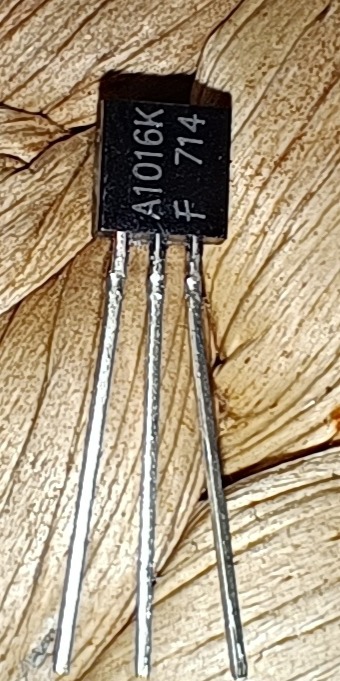

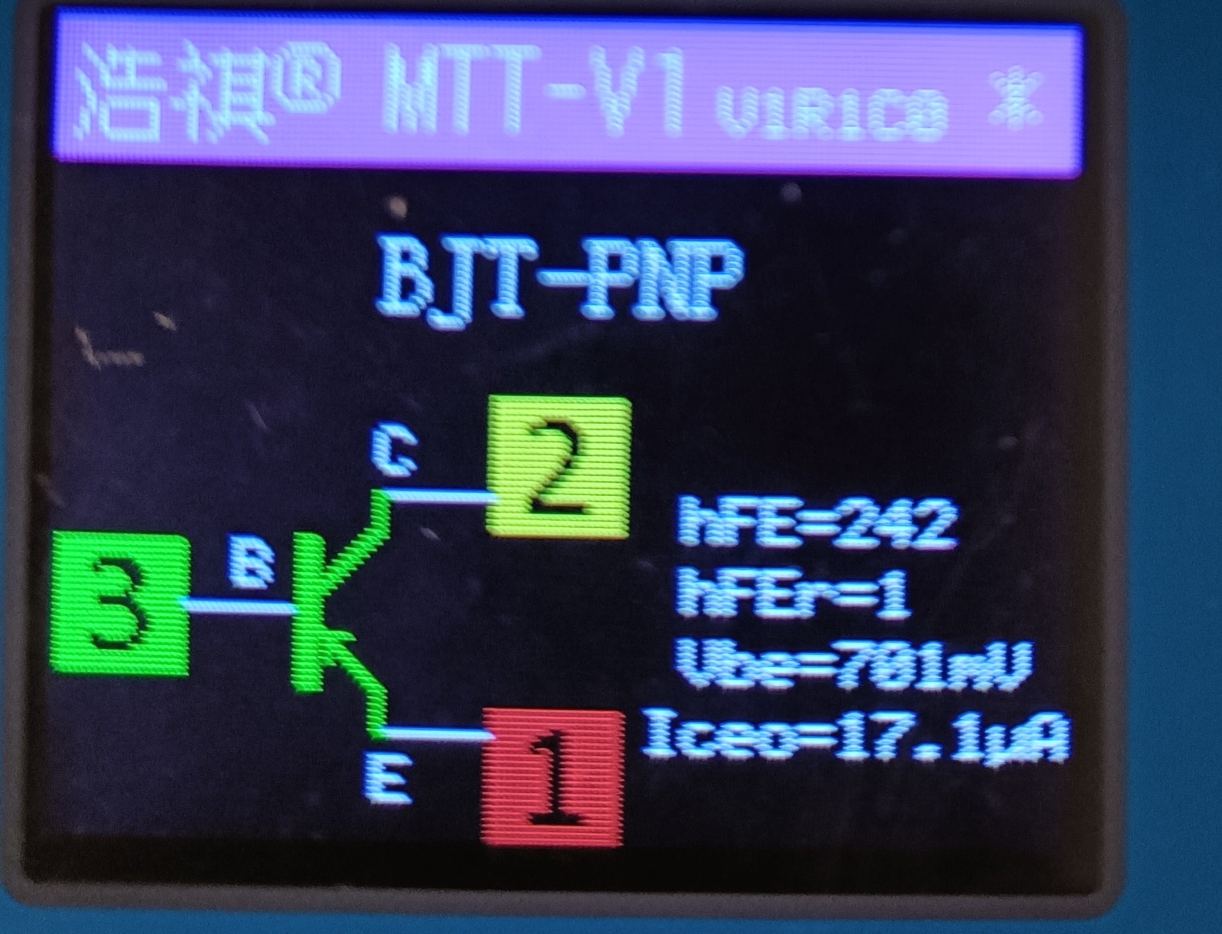

I have another one to identify. 2sa1016K
F suggests those are Fairchild? Thought those where Sanyo. So obvious fake or not?

The 2SA1016K originally was originally made by Sanyo. I can't find any reference to a Fairchild knockoff of the device. The "F" might refer to the lowest beta range, which is listed in the original Sanyo datasheet. However, you would think that an "F" designation would have been done in plain script. Instead, it kinda looks like a lame attempt to copy the Fairchild logo.
Edit - Onsemi actually at one time made this device as a 2SA part. When I checked with Digi-Key, they listed it as a "marketplace" device, meaning that it is out of production and that there is stock with a broker somewhere.
