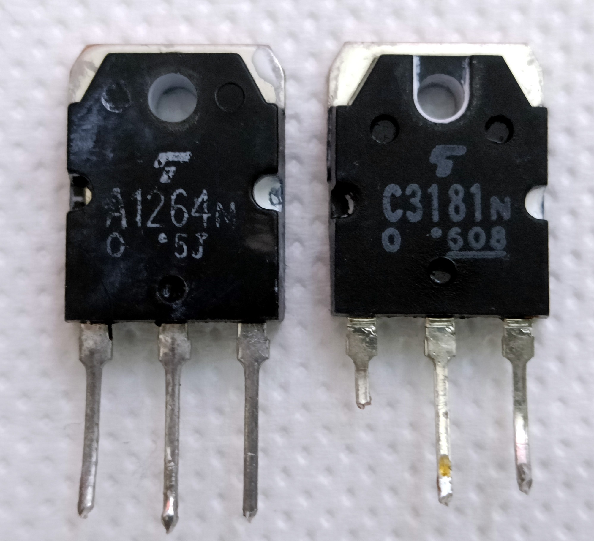

2SA1264 2SC3181 Toshiba fakes. Replacements in a broken channel L-405 Luxman amp. Came for a test. Hfe alright, power output compared alright, THD compared alright. How did I know they aren't real? Simply, slower. Original channel 150kHz F3, repaired channel with these 50kHz. Rounded edge somewhat crooked square wave.
After a pair of original green and black era Toshibas were luckily found at an old technician's shop, proper F3 and square wave shape returned.
They were bought from a big electronics shop locally by the amp's owner who installed them but they didn't pass the speed test when he brought it over. They were hesitant to call them originals at the shop even!
At least they biased normally and honored 100W unclipped output at 8Ω. More than what a Luxman L-405 claimed in the 80s but the mains are 10VAC higher since then here. Power result and FFT behavior looked the same as in the other channel fitted with the original transistors.
Same 0.02% THD at 100W. To finally reach 1% THD at 115W. 1% is roughly the level of visual clip onset on a scope's sinewave.
I suspect a general use proper size but slow die inside like a 2N3055 or something. I could measure the Hfe because he had two spares also. And it was in spec strong for their O suffix. PNP beta being stronger than in NPN was a common trend across copies and the finally found R suffix green/black big T logo original replacements.

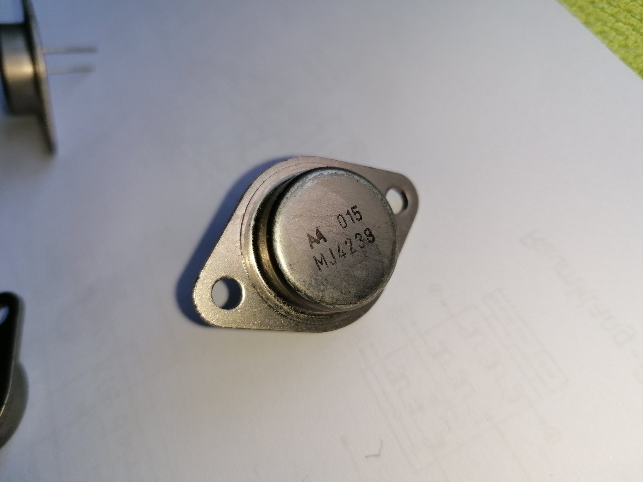

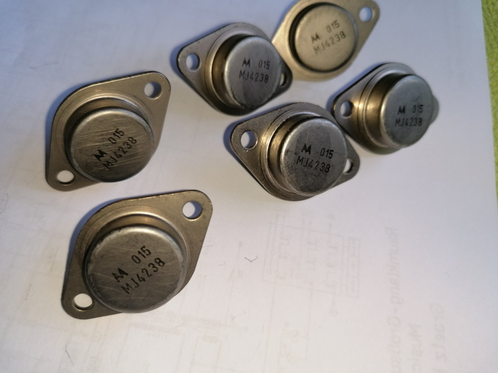

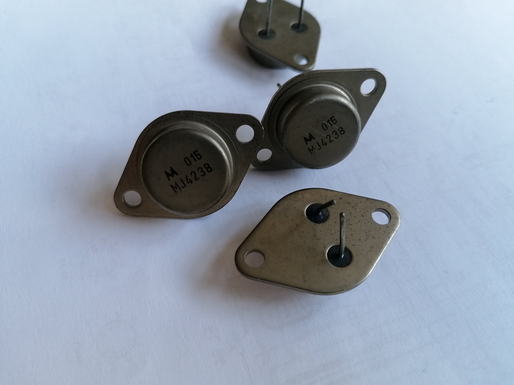

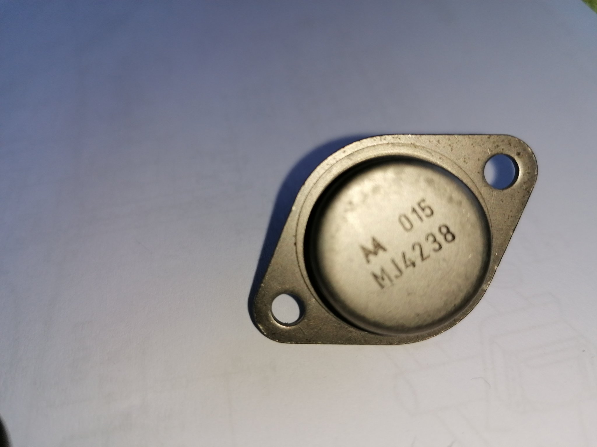

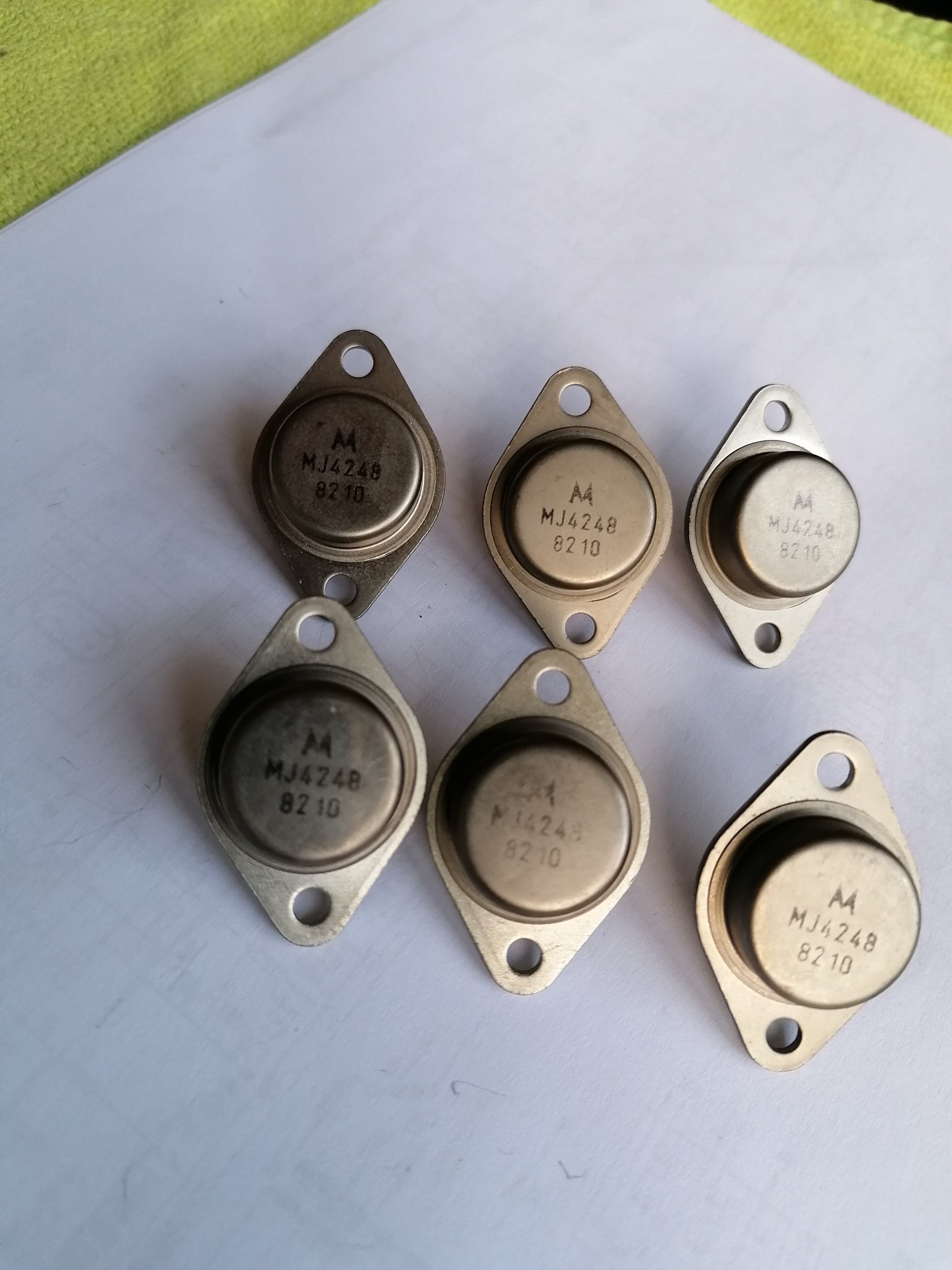

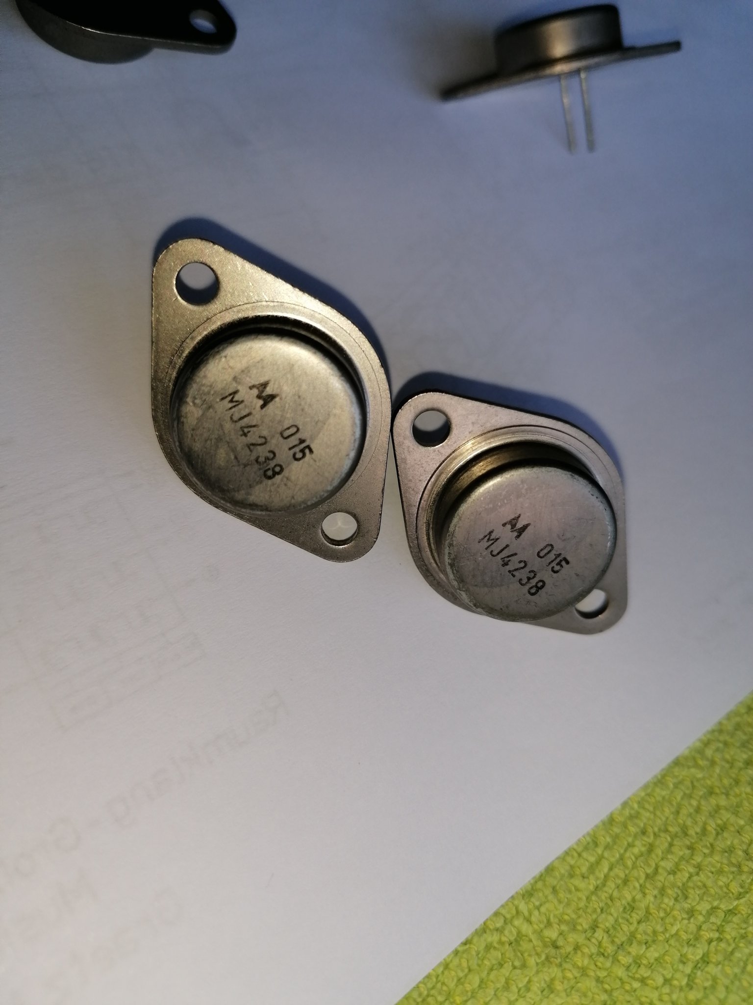

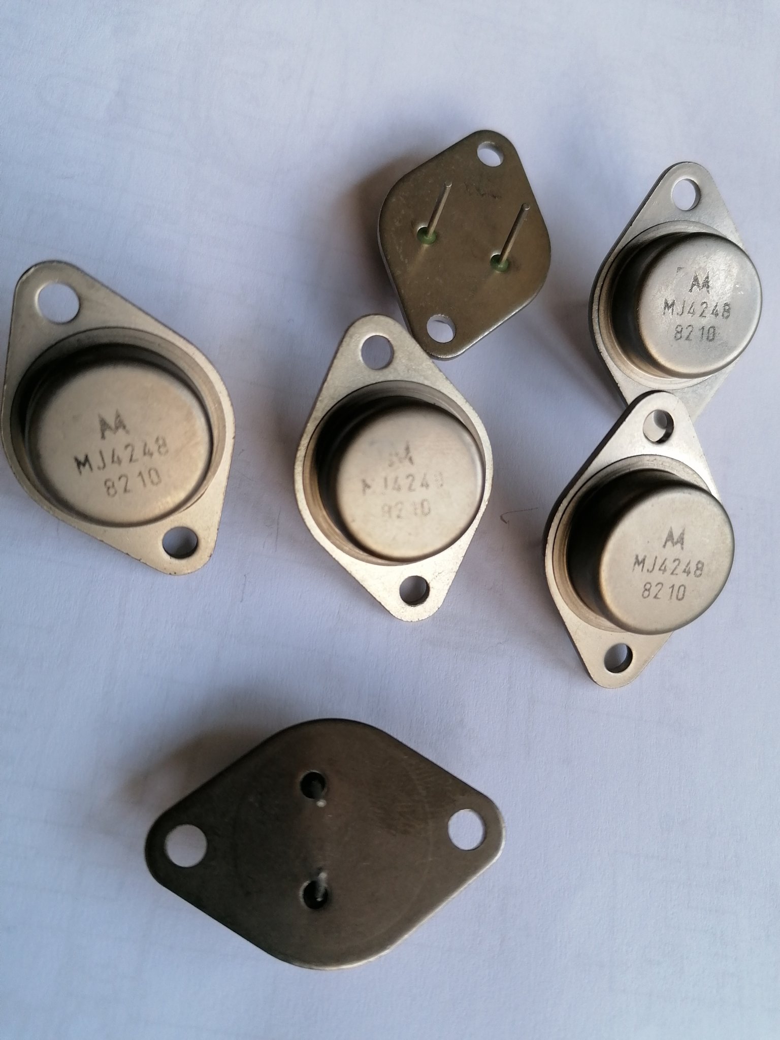

I have managed to find pairs of MJ4238/4248 as replacement for MJ150020/21. I found very little info on these transistors, Does anybody have any info on them and can you tell by the pictures are they real and geniune or not? MJ4237/4247 should be the same, just for lover voltage.

The 4248’s have the small glass seals - which Motorola did use, but ONLY with the domed top hat. So those ain‘t Motorolas. When they went to the squared off ones (after 1985) they had the larger glass seals like the “4238’s” have. You can see the scratch and scrub marks on those. Maybe they are Motorola somethings. Just not MJ4238.
Why in the world would one want to use them as MJ15021/22 replacements I don’t know. Unless you’re trying to worship fT. If you do that you’d best not run ‘em as linear amplifiers anywhere near rated voltage. That might have even be what killed off the short-lived 15021 family. They might not have yielded very well to spec. They just couldn’t make a high fT linear amp transistor to save their souls back then. Not until the MJL3281, which they acquired from outside.

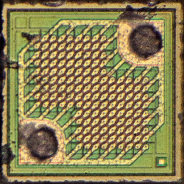

Thank you all for replies. I will open one of each and post pictures.
